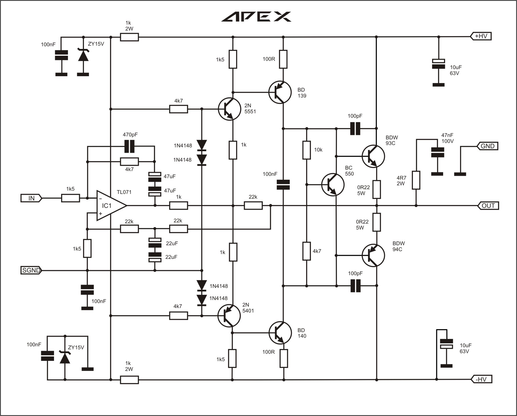

AX14 is 'Ultimate Fidelity Amp', FX14 and NX14 are MOSFET and QUASI (NMOS) variation with same VAS, all work great. In many threads people argue BJT vs MOSFET or vs QUASI, but with different VAS, speakers... I build and test AX14,FX14 and NX14 listen and compare sound on same speakers with same PSU, and I don't want share expiriance about that, it's your own to find.

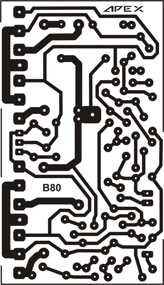

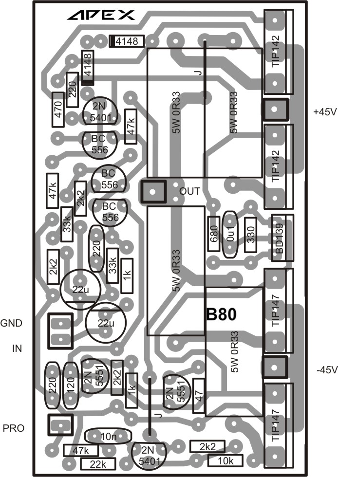

PCB from post #135 size: 47,5x82,5mmHi Apex i want to build your amplifier in post #135 send me PCB and dimensions please.

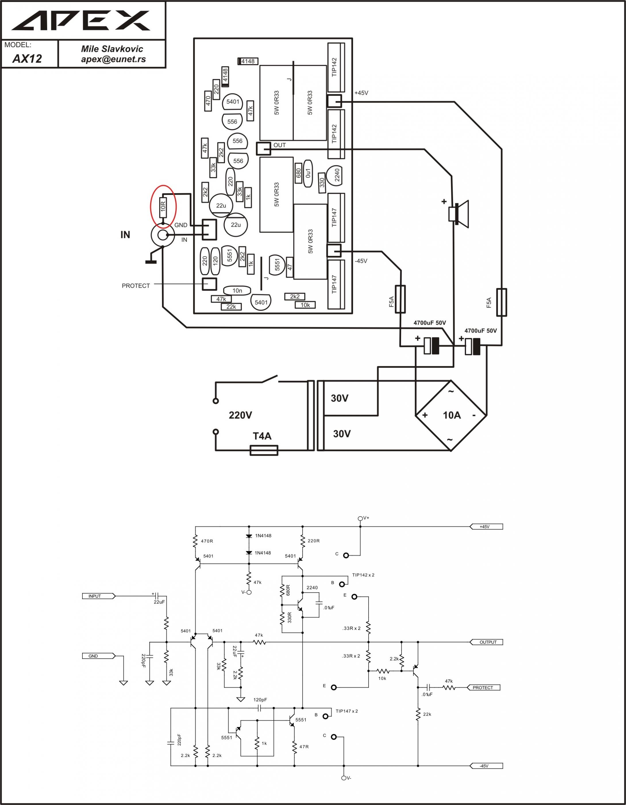

If you have hum and noise problem put 10R resistor in input GND.Hi Apex i want to build your amplifier in post #135 send me PCB and dimensions please.

Hello apexaudio,
Can you please post the BOM for your Ultimate Fidelity amplifier?
What's the THD, slew rate and damping factor to expect?

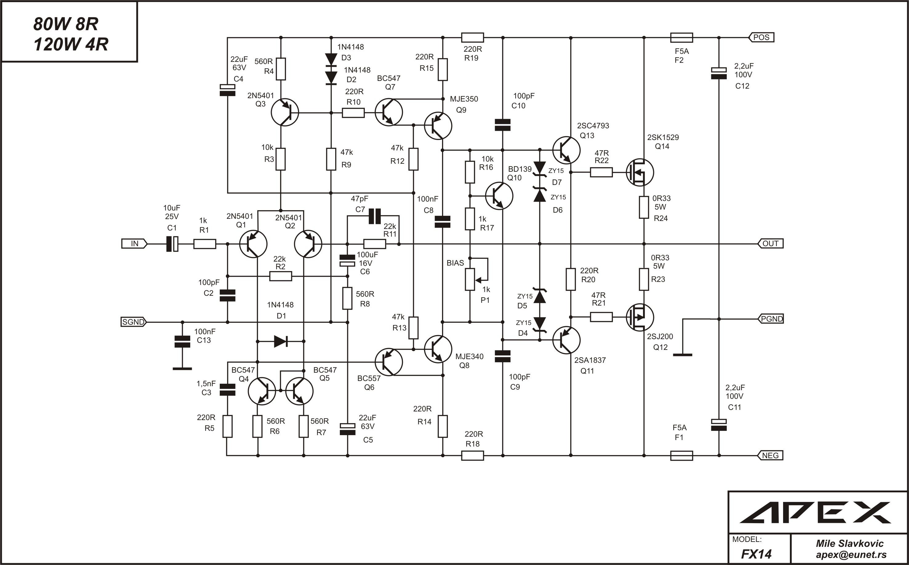

I mean the IRFP240/9240 mosfet version - FX14. 😎
Do you have the pcb for it? I can´t find it in the thread...😕
Thanks!
I'm building the AX14. After that I'll build the FX14 and compare the sound. 😎
I have some questions:
Does the BD139 be fixed to an output transistor for thermal compensation?
What's the bias I should use?
Thanks! 🙂
Thanks! 🙂

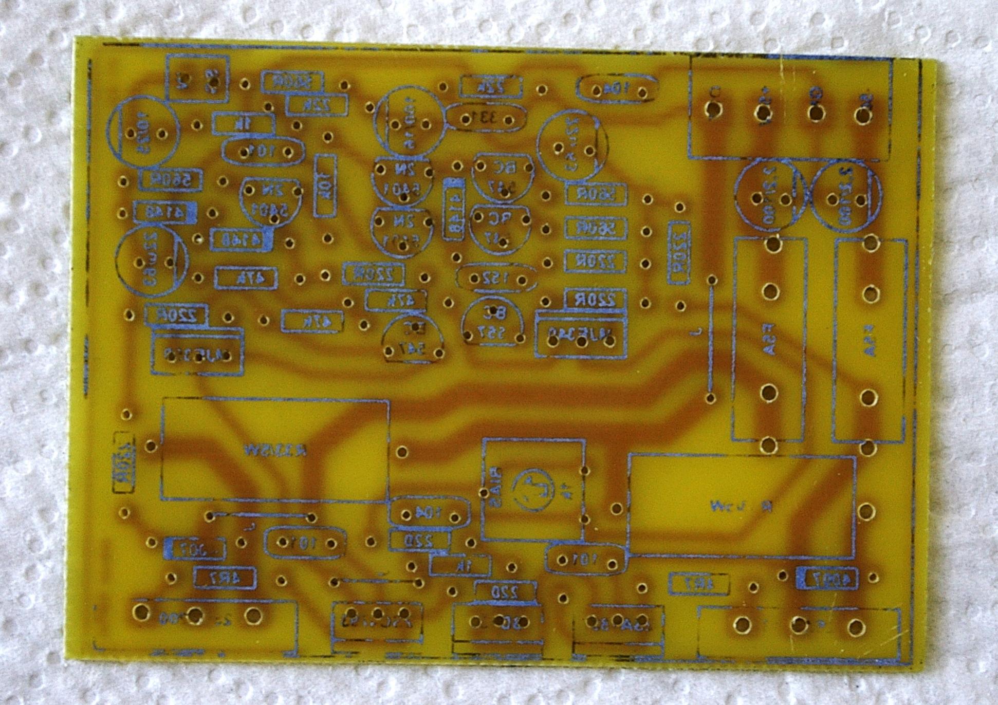

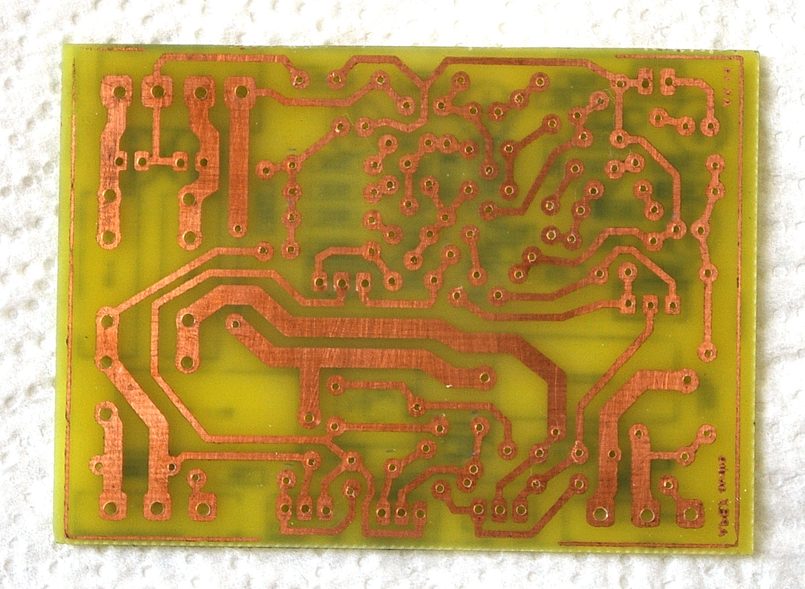

You have mirror reverted pcb sides top and botom, you must put components on cooper side of pcb,This is the pcb I made for testing the AX14.
I allways have problems in getting the tonner to pass completely to the boards!
Well, this is what came out.
Paulo.
Regards
I use same pcb for AX14 and FX14, BD139 is fixed direct to heatsink, thermal compensation is "too good", on FX14 bias decrease from 200mA to 120mA when amp warm.I'm building the AX14. After that I'll build the FX14 and compare the sound. 😎
