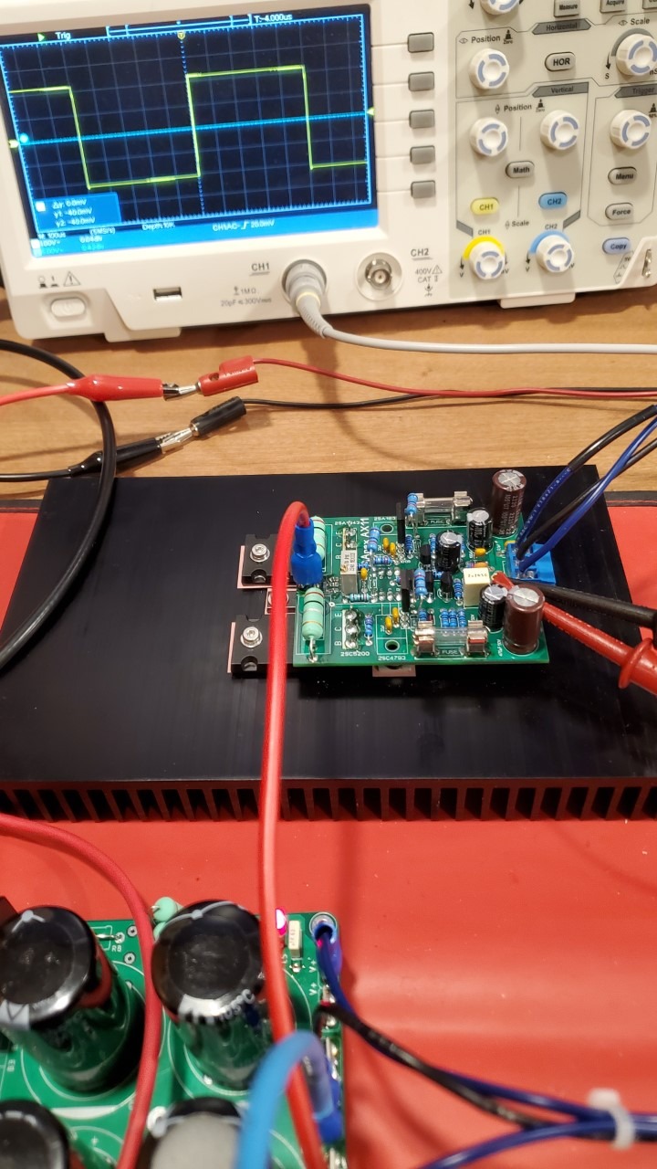

I Built it. Running for an afternoon. Sound is excellent so far!

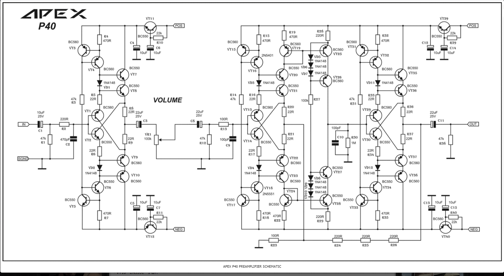

Can someone help me with an advice or something about APEX A33? I build up one pair ,works perfect at +/-62Vcc but the first MJE's get hot then the others and i already put them on heatsink. The BIAS is set it up at 20mV,the final and pre-final transistor get worm like normaly,the sound looks good on oscilloscope also...only that first 2 MJE's go hot,not worm
Thanks and best regards!
isn*t +-62Vdc about 7-10Vdc too high PSU voltage,per rail? that is an amplifier with only two output pairs if i remember good
That is true but APEX A40 can handle +/-65Vcc (i dont know how because the caps are at 63V) and have same construction in that area. I will try remove the resistors of 10 ohms from power the pre-final stage and i will supply that part with stabilized power supply of +/-61Vcc-62Vcc
