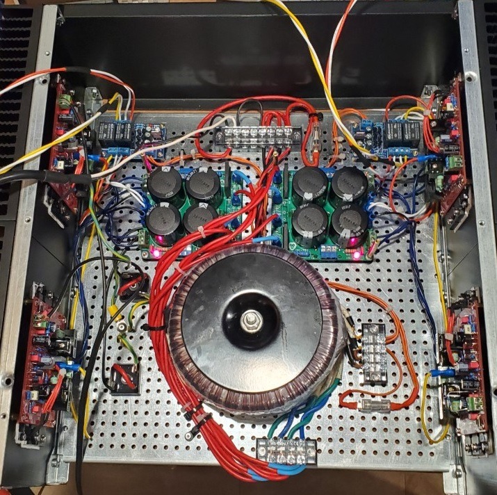

Nice. Will you use it as Stereo Bi-amplification amplifier for power hungry speakers ?AX14 is great. 4 Channels running. Need some etching on front and rear panels
Elias
Active 3way for 300HZ cross point. nice way to integrate the woofers in room and design the mid/tweeter passively, measuring outdoors on a ladder. Less weight carrying the mid and tweeter up a ladder..Nice. Will you use it as Stereo Bi-amplification amplifier for power hungry speakers ?
Elias
Nice work,AX14 is great. 4 Channels running. Need some etching on front and rear panels

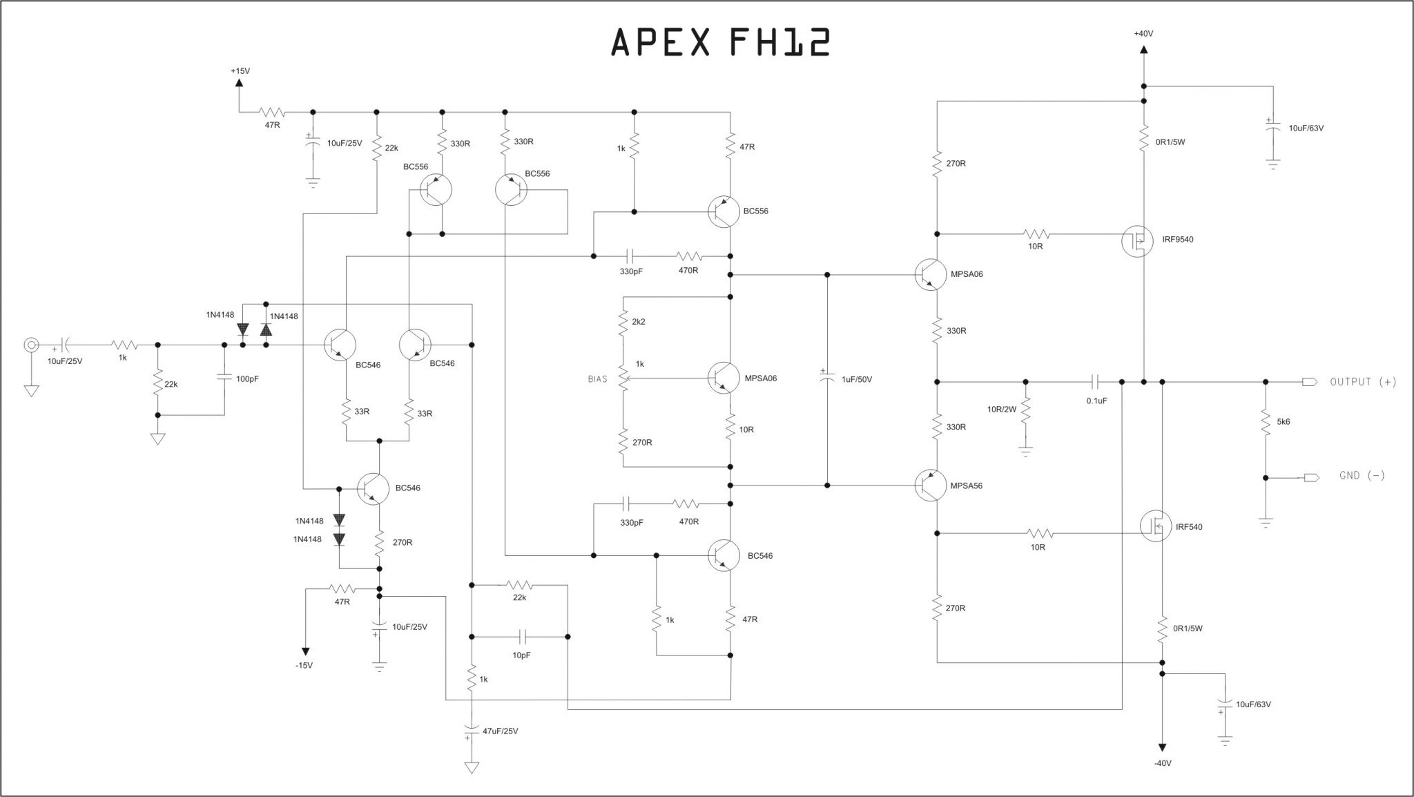

I can't find any real proper pcb for this amplifier.Nice work,
Regards
To make it clear,
1) Q8 and Q9 have to be connected to the heat sink to make the thermal feedback real efficient
2) the butceral have to be on board
AND
3) NEEDS TO be somewhere an extended description of the circuit (some link if I have mist it ?)
Of course I can follow the way xrk is following to his amplifiers and thermally connect these 2 transistors screwing them on top of the other on the heat sink transistors using sort cables

can you provide documents on Wich you have based quoted post,i am curious? thanks in advanceI can't find any real proper pcb for this amplifier.

Wik - where is this earlier post with this schematic in it? there was FX14,i can not recall FH12?
can irf9540n and irf540n be used in this apex fh12 amp?APEX FH12
- 100W Ultimate Fidelity Amplifier
