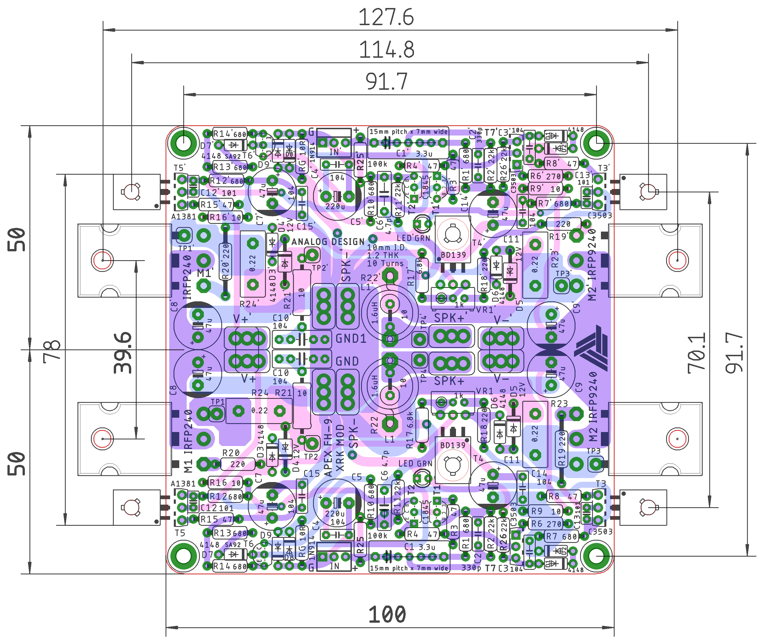

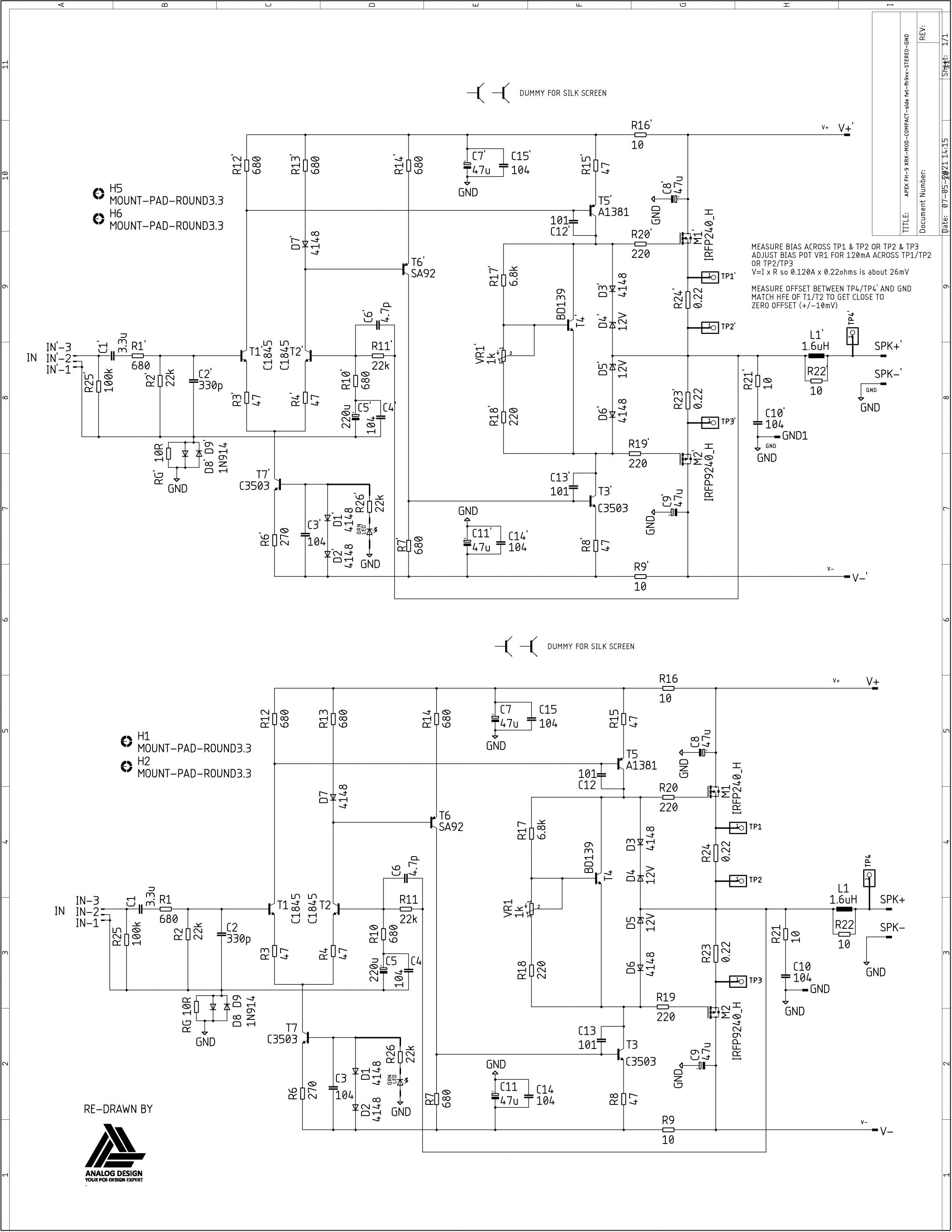

I have attached an alternate schematics FH11 - difference is number of outputs. It shows shows T6, as a MPSA92.
Someone will correct me - but I don't think the KSA992 has enough current capability for that location.
But there are substitutes - You could use 2N5551 for the T1/T2 c1845, you can substitute the MPSA92 for a MJE350 (however different package and pinout)

Hello jimk04,
those are indeed MPSA92.
I have used RS pro brand components before and never had any issues. I have used some shortforms in the schematic.
A1381-- KSA1381
C3503---KSC3503
C1845---KSC1845
A992-----KSA992
SA92-----MPSA92 ...
some caps are also marked as 101 meaning 100pF, 330p implies 330pF, 104 implies 100nF

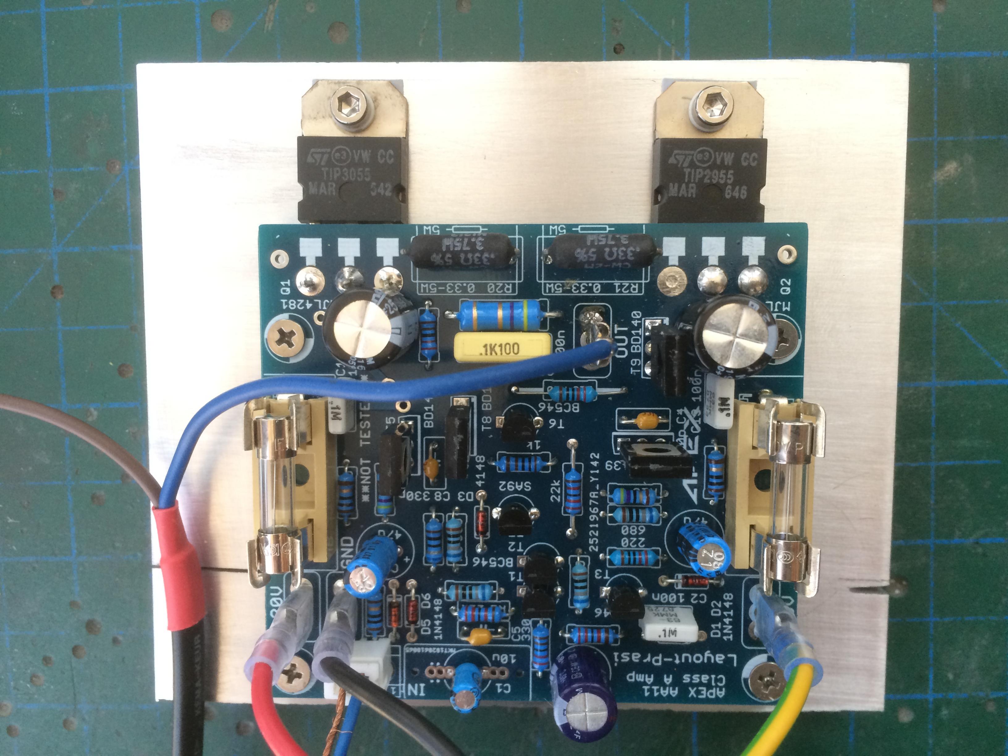

APEX AA11 Class A amplifier assembly is complete. Excellent sound. Typical class A. Thanks Prasi for the PCB.
You are welcome. Nice work.

Fazildiken. Nice.! Modest heatsink. Maybe one for me to build sometime!
heatsink was used temporarily. It doesn't make sense to use it for a long time with this heatsink. we will produce one for you as well.
