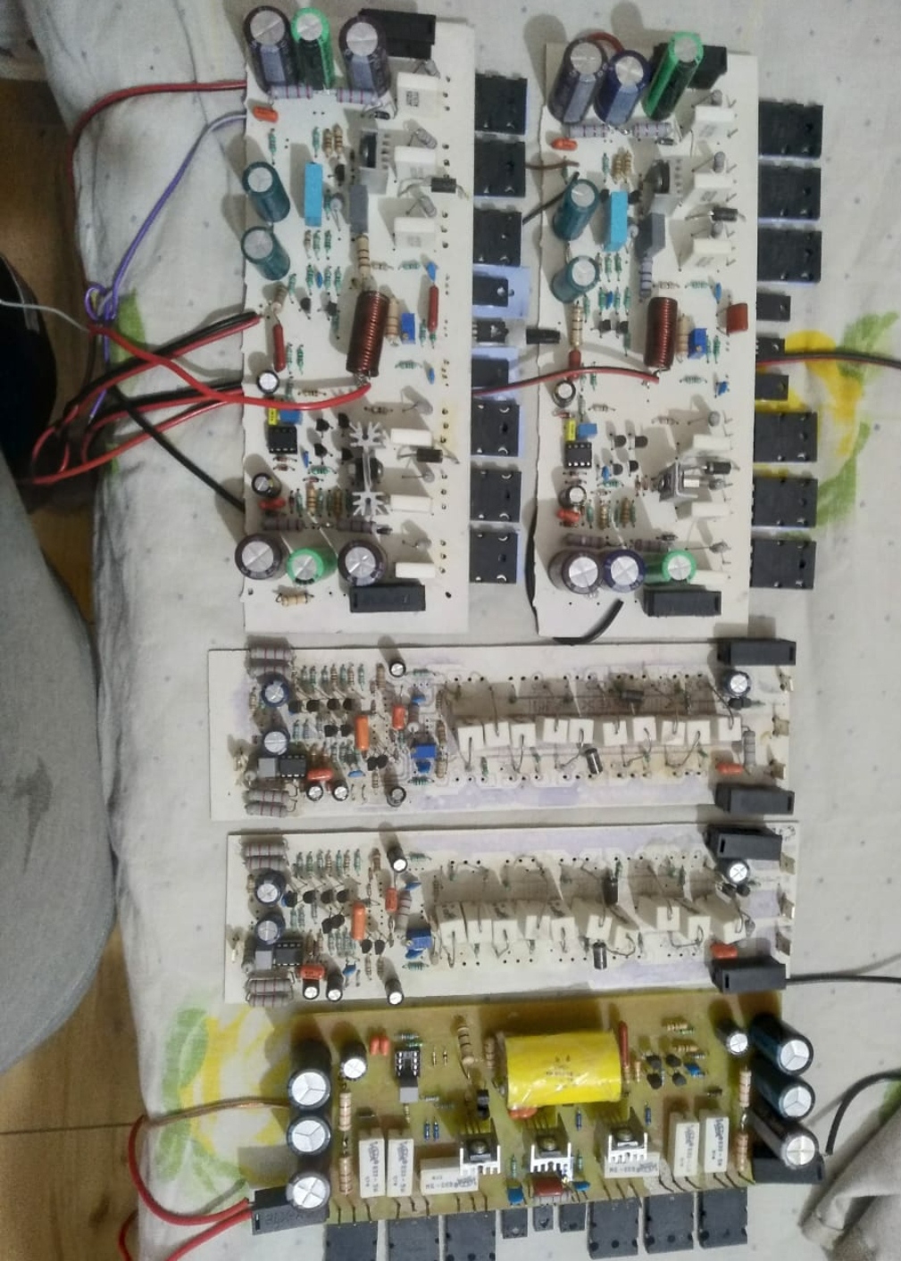

Hello Tarry sir .I have Also pair bc550 560 in sr 200 .I made 5 pcs borad .3 board bc547 bc557 .2 board bc 550 bc 560 .but all sound same

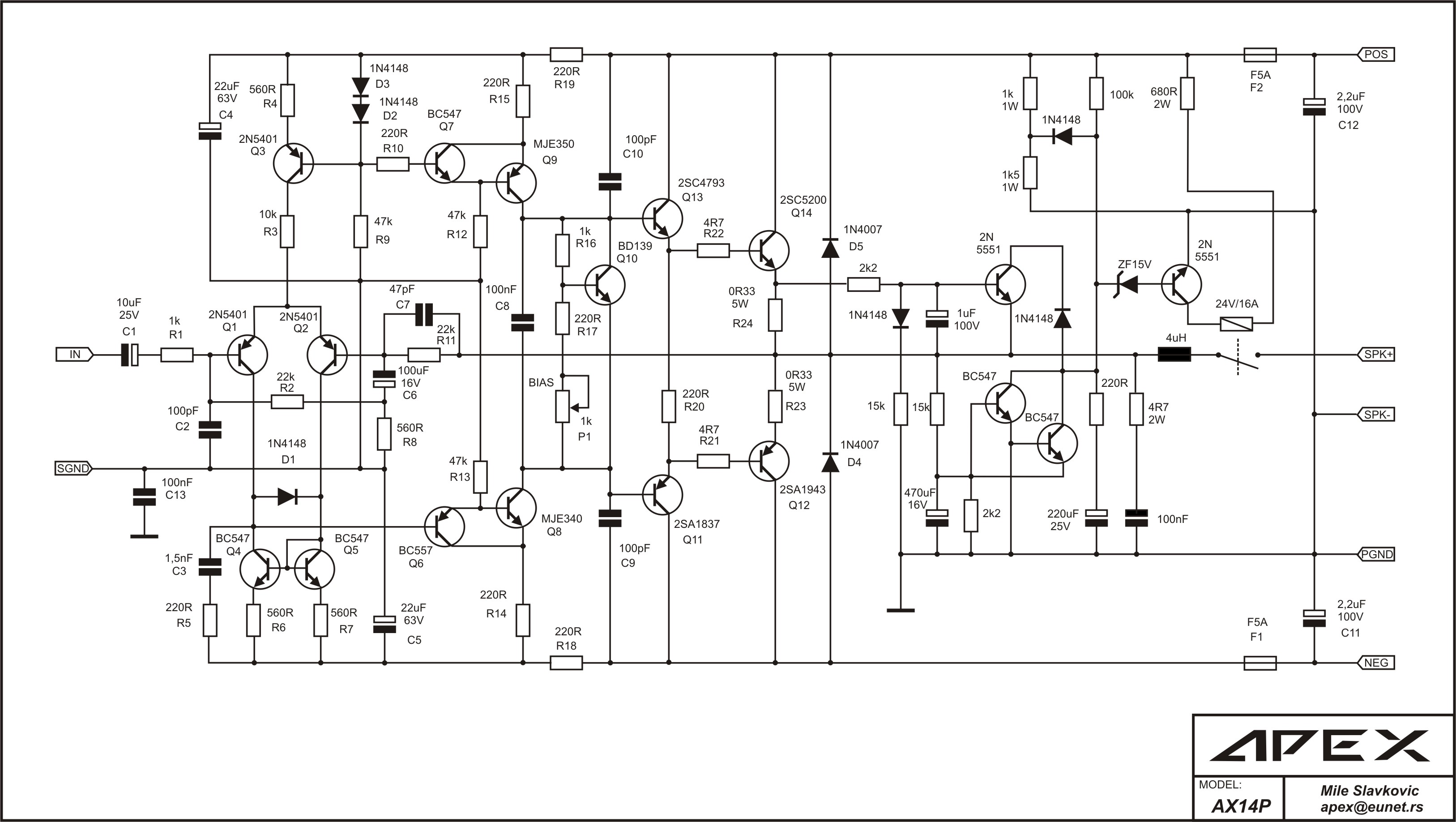

Has anyone made a surface mount version of any of these amplifiers.
I was thinking of making a AX14p just as a practice on SMD stuff. With 0805 being the smallest I want to hand solder. Using a double sided PCB.
But need some help choosing SMD versions of the components if anyone is willing to help out.
So obviously need to decide on small signal transistors, VAS/CCS Drivers, But still using Through hole power transistors. Will all resistors be SMD, what power rating (physical size) etc.

Apex specifies power of resistors, rest resistors are all 0.25W, so 1210 package works and slightly easier to solder. dont know if R18/20 have to be 0.5W, a sim file would help.
for 2 or 3 watters, you can parallel 2512 types.
diodes can be easily found in smd version.
MMBT5401 and MMBT5551 for 2n5401/5551
for bc547/557 ---- bc847 /857 https://assets.nexperia.com/documents/data-sheet/BC849_BC850.pdf
dont know if mje340/350 2sc4793/2sa1837 have smd equivalent... these can be kept THT.
elco THT caps on top and SMD npo caps on bottom.
this should work unless apex / someone has some other suggestion.
MJE340 / 350 -> MJD340 / 350 but be aware of good heat dissipation, which in this case may cause an undesirable increase in the PCB area and may be better to stay to THT and leave MJE / 2Sx?

You can also use MELF resistors.

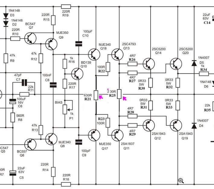

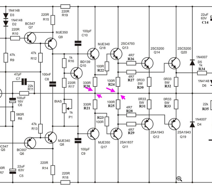

Who can tell me why there is a feedback connection in this place, I saw several similar amplifiers with a triple at the output, it was not there. It was like the second picture. What is the best and correct way to connect drivers to feedback or not?

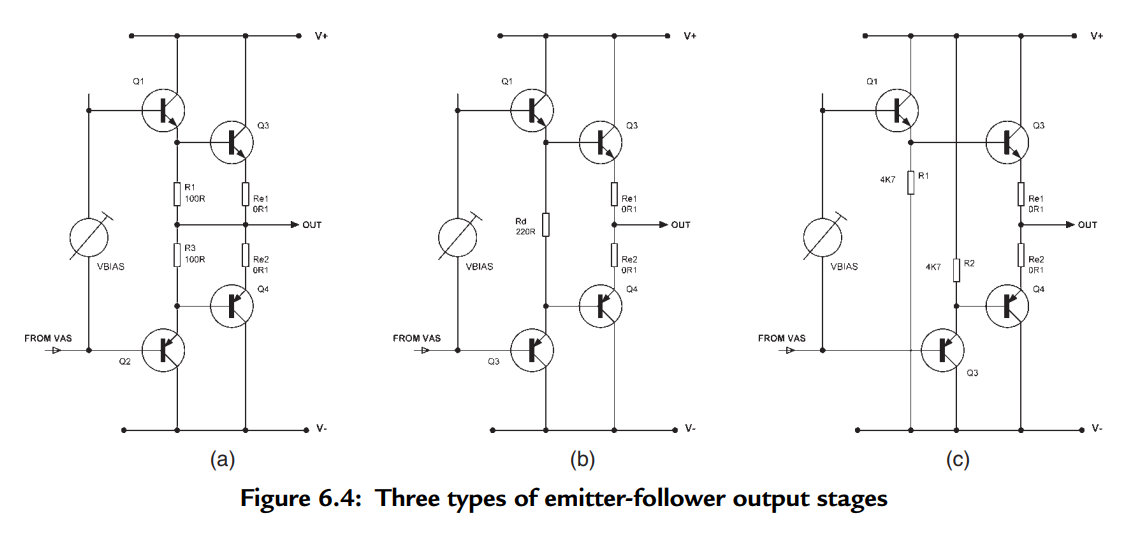

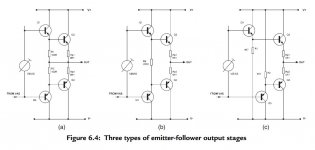

According to Douglas Self's explanation:
"Figure 6.4a shows the most prevalent version (Type I), which has its driver emitter resistors connected to the output rail.
The Type II EF configuration in Figure 6.4b is at first sight merely a pointless variation on Type I, but in fact it has a valuable extra property. The shared driver emitter resistor Rd, with no output-rail connection, allows the drivers to reverse-bias the base – emitter junction of the output device being turned off. Assume that the output voltage is heading downwards through the crossover region; the current through Re1 has dropped to zero, but that through Re2 is increasing, giving a voltage drop across it, so Q4 base is caused to go more negative to get the output to the right voltage."
Nevertheless, worth to build the amplifier as it shared. APEX amplifiers built by many, and good sounding circuits as they are.
Yes, I did Apex-14, 17, 20 and soon, I hope I will do A40. It simply seemed that if you tear these resistance from feedback, would be better ... because of it, i have asked. But there is some questions:
1. Will it be unambiguous better?
2. Will there be no instability from this?
