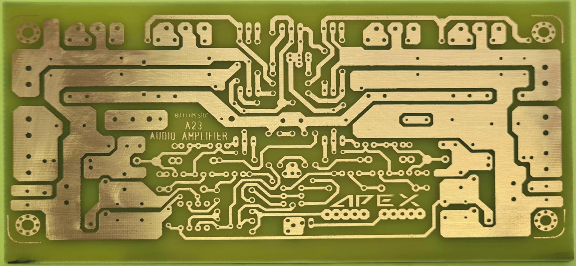

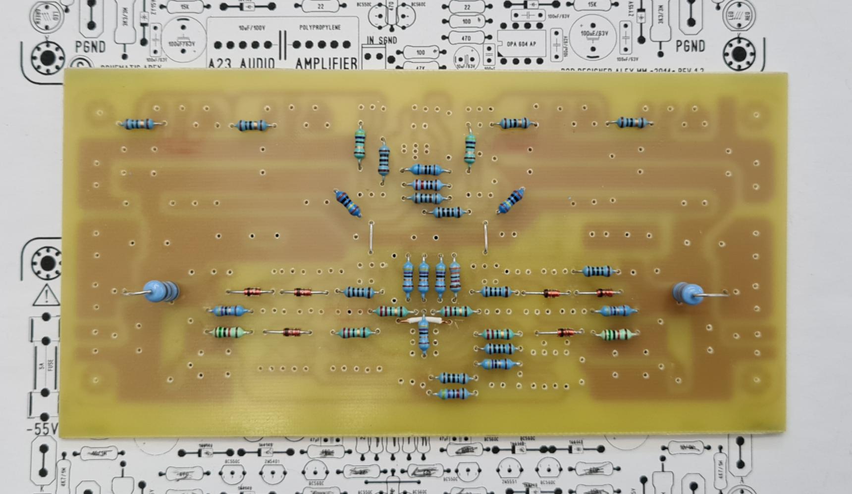

Hi Prasi, yeah idk why their online software had issues, but the new gerbers work a treat.
My order is already sent, Ill add these to when I order again in the future.
Guess I can manually etch it, but I am getting lazier the older I get.
Here is an A23 I just etched and started populating. This will be the first of this topology for me, so it will be interesting to hear how it sounds.
Regards

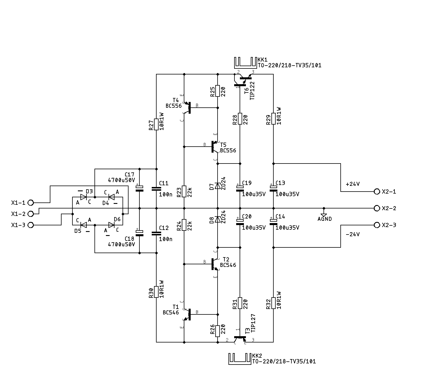

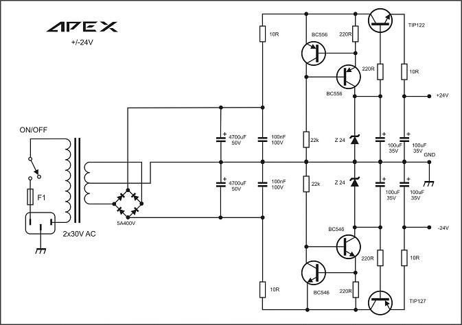

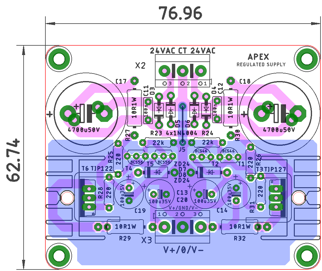

Planning on the AX-14 build version by @prasi from the post #11461 and the PSU + protection from post #95 by @apexaudio. Any problems in these or mods suggested that should be followed up or do I go ahead and begin? Thanks.
Also please - is 36-0-36 transformer adequate for 4 ohms speakers with the AX14. What current rating should it be?
should be ok with 2 pair output devices.
Also AX-14 as per 11462 is tested by a few , works well. Mount Q10 on any one of the output transistor.
Use an inductor (1.2-1.5 mm dia, 10-12 turns on AA cell ) with parallel 10 ohm -2W resistor on the speaker terminal.
I Dont have any idea about protect circuit.
