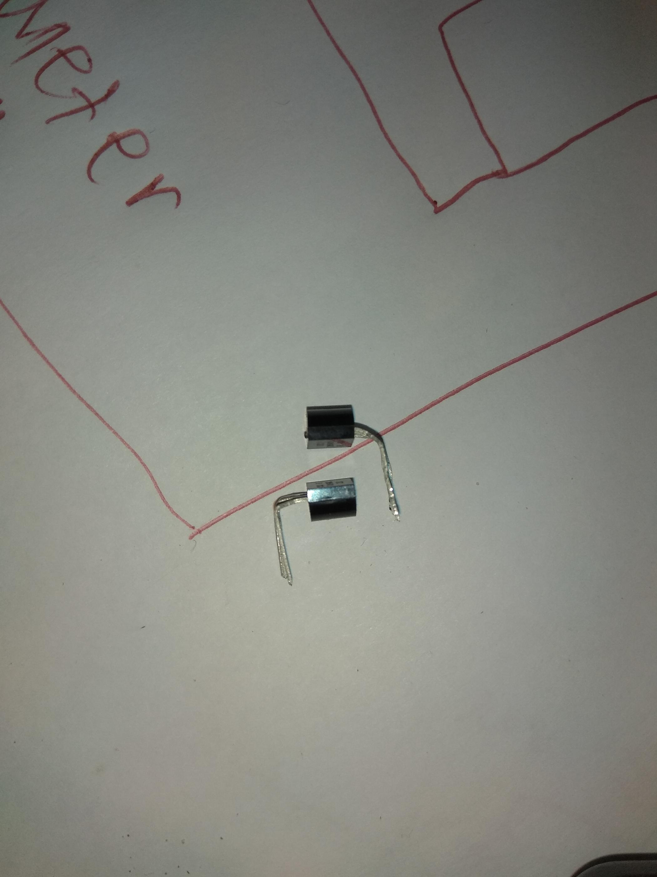

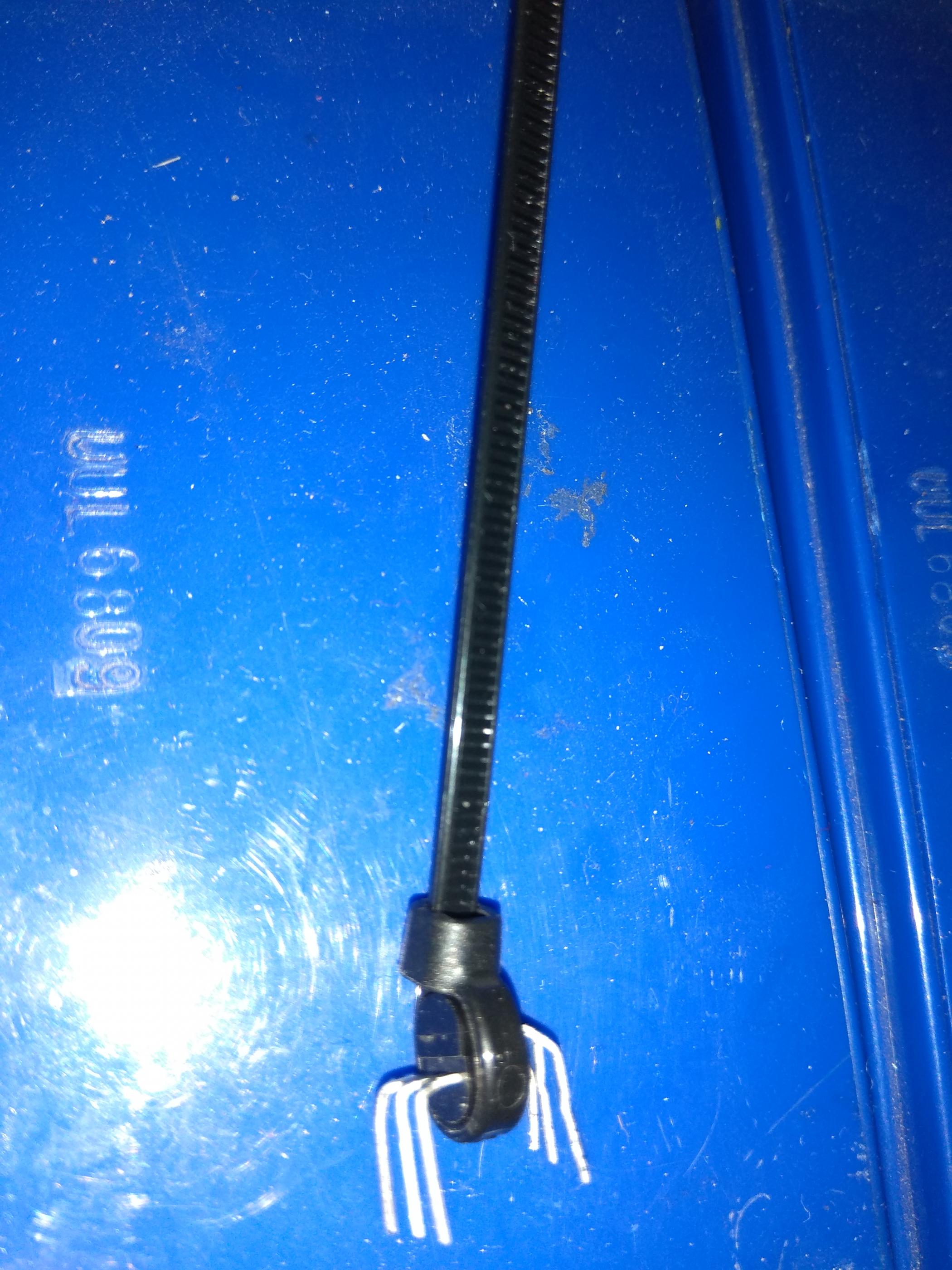

Only thing with Q1 and Q2 being coupled together is they are not back to back like they are in the Honey Badger Amplifier. So should I just have Q1 spoon Q2?
View attachment 770913View attachment 770914
Do this as per photo.
