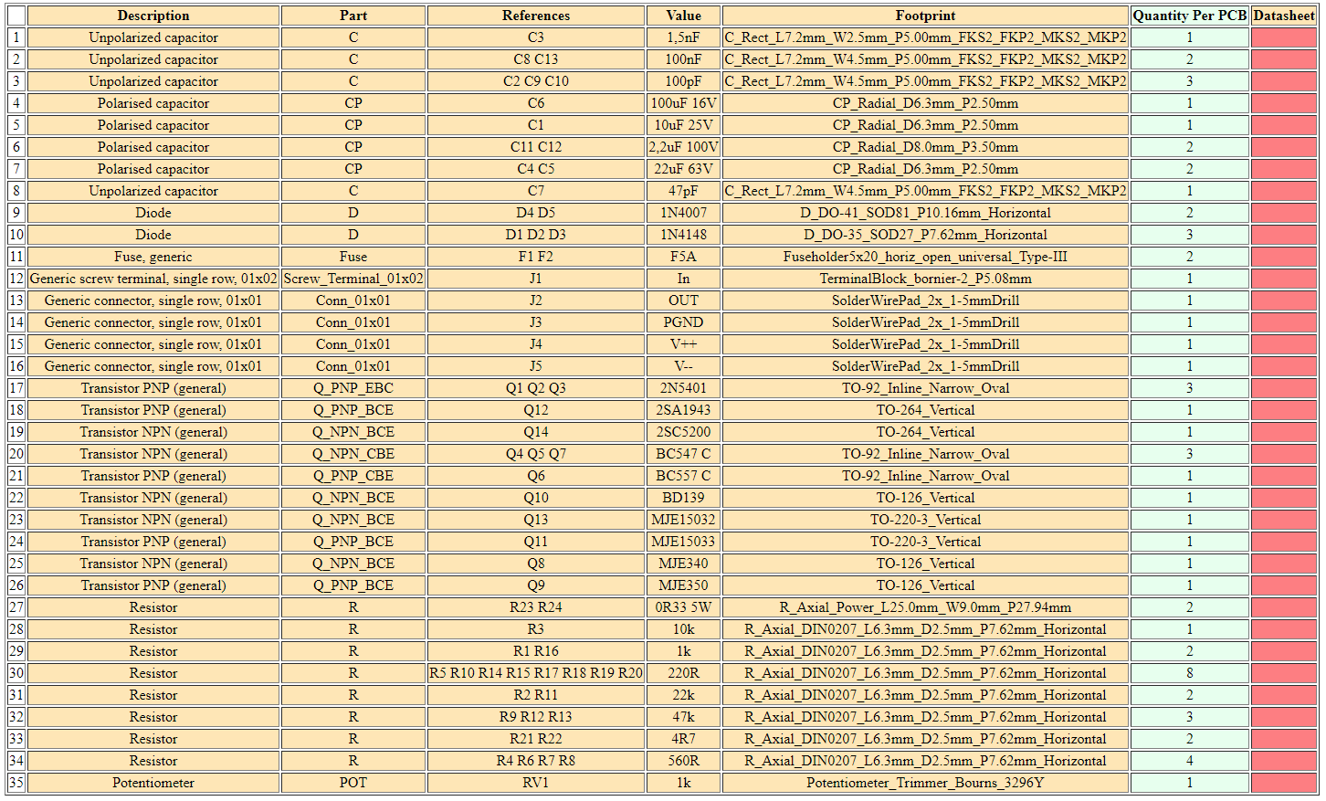

Not the one I am using which is specifically for Prasi's boards. I have found what I think is a copy that I haven't changed but would be better coming from Prasi
I have been asked where I got the BOM for AX14 (Prasi's boards) but now I can't locate it and I have been updating my local copy, I know it was posted by Prasi a while back.
Prasi, could you please repost it?
Thanks,
Chris
Hello Chris,
Here it is..
100W Ultimate Fidelity Amplifier
regards
Prasi

Hi Prasi,
can use mje15032 and mje15033 instead of 2sa1837 and 2sc4793?
Regards
Raj
Hello Raj,
Yes. You can use the MJE devices. Even for outputs , you can go with onsemi njw/ mjl devices.
Regards
Prasi

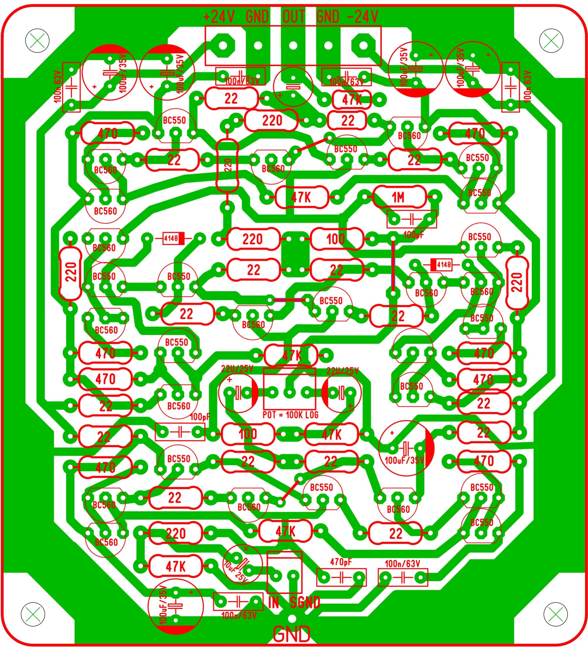

hi all. i want to make p30 pre amplifier for a40 but i could not get pcb layout. can any one give me pdf of p30 pcb printout?
I built both versions but this is the one I used in my preamp.
These are for toner transfer.
I checked and I actually used a modified version of the above layout. I really just simplified a little as Alex had designed it with two different sets of holes for the resistors and caps. I removed the extra holes to make it easier to etch and drill. I am adding those file here.
These are also for toner transfer. I you need photo sense files let me know.
