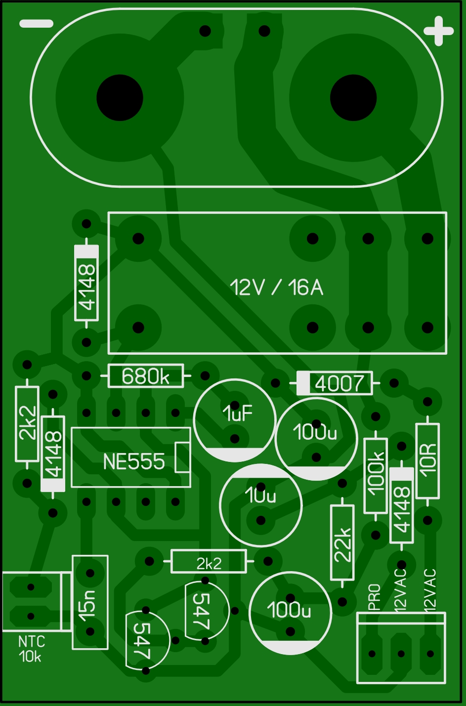

Hi

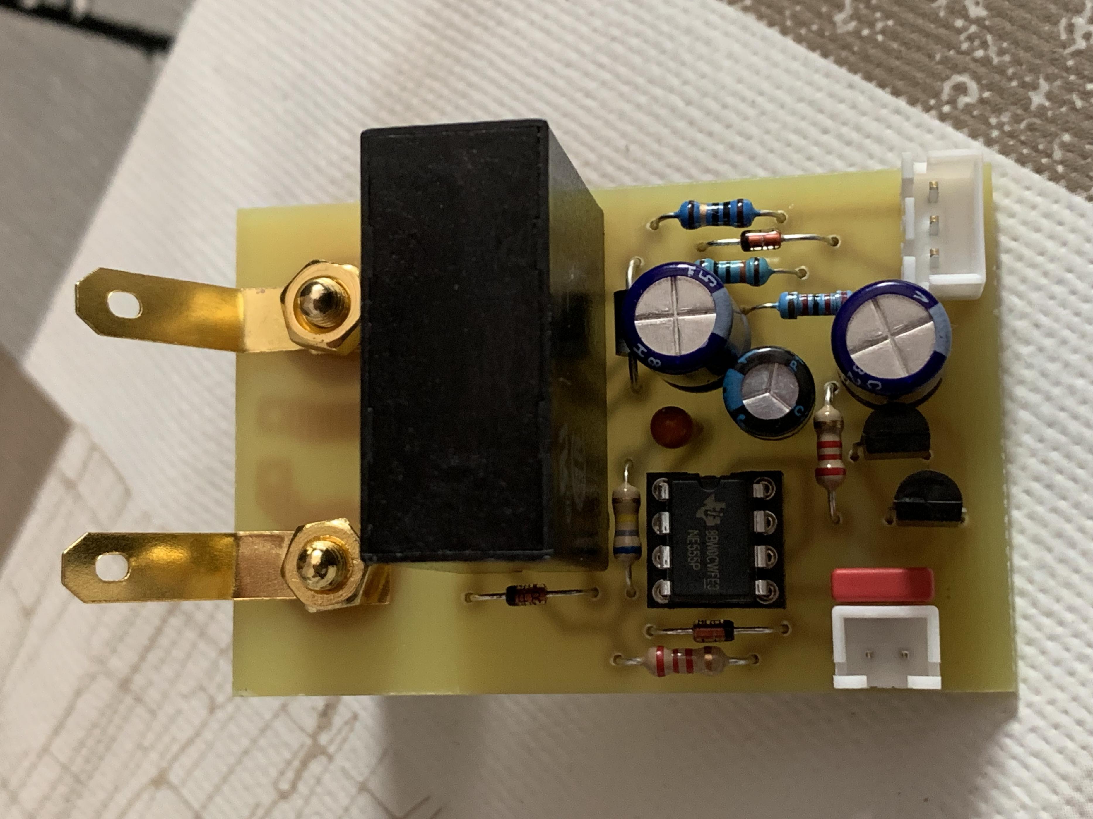

Does anyone have PCB(toner transfer) for this protection?

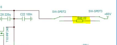

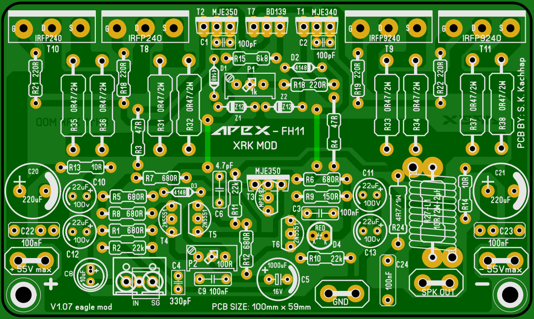

I have a few questions on the FH11/12 deisgn posted in the thread. Plan to use @eaglemaster v1.07 gerber files from post #8557.
1 - Is MJE340/350 interchangeable with KSC3503/KSA1381? I see both on different versions of the board throughout this thread. Datasheet leads me to think they are, because they have similar parameters with the MJE's have higher current and disapation capabilities? Can someone confirm?
2 - Can I also substitute BD139 for a MJE340 - or is that overkill or not suggested?
3 - What are R40 & R41 (22r 1/4w 1%) but not showing on the PCB silkscreen?

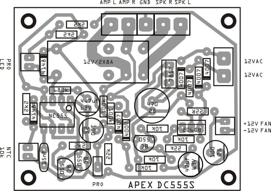

Hello...
I have read the pages of the forum to start the assembly of the AX11, I had some doubts, but I found several circuits, I had some doubts:
Can I power AX11, AX14, AX17, and SD200 with PSP100, speaker protection involves delay speaker, short circuit and DC?
Which amps are PSU 05 and 07 for?
Thanks for the force !!
(using Google translator)
Today we tested NE555 Protection🙂
I found a PCB error,Pin 1 at IC must be connected to GND.
Sorry about that. That is why I wrote check for accuracy. Here is an edited version.

Anyone able to answer these questions?
Yes - it can work welll. KSA1381/KAC3503 are probably even better.
The Vbe multiplier just needs to be a NPN silicon transistor.
I am not sure I see R40 or R41? There aren’t that many resistors.
