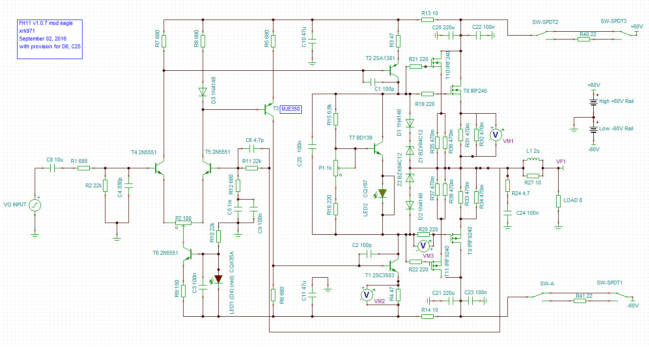

I've just noticed that there is no bypass capacitor around VBE multiplier. It is also missing from the schematic, so I'm guessing that's why it was not included on the PCB.
mrmax, is a bypass mandatory in this case? And what value would you recommend?
Bypass capacitor around VBE multiplier is placed to ensure stability. Most of the time you will see a capacitor with value from 100nF to 10uF used as a bypass around VBE multiplier. In case of AX11 amplifier, Mile (Apex) used 100nF.
oh my... I see my deadline running! I will check if it is easy to add! (the smalest value)
We didn't use bypass on earlier Vbe and it seemed to work fine. Does it just smooth out the Vbe response? On my Pass M2, there is a huge 3300uF cap on the Vbe so that the amp takes a minute before full bias is reached. It uses a clever opto-coupler and precision voltage sources as the bias regulator. No tempco. Works real well.

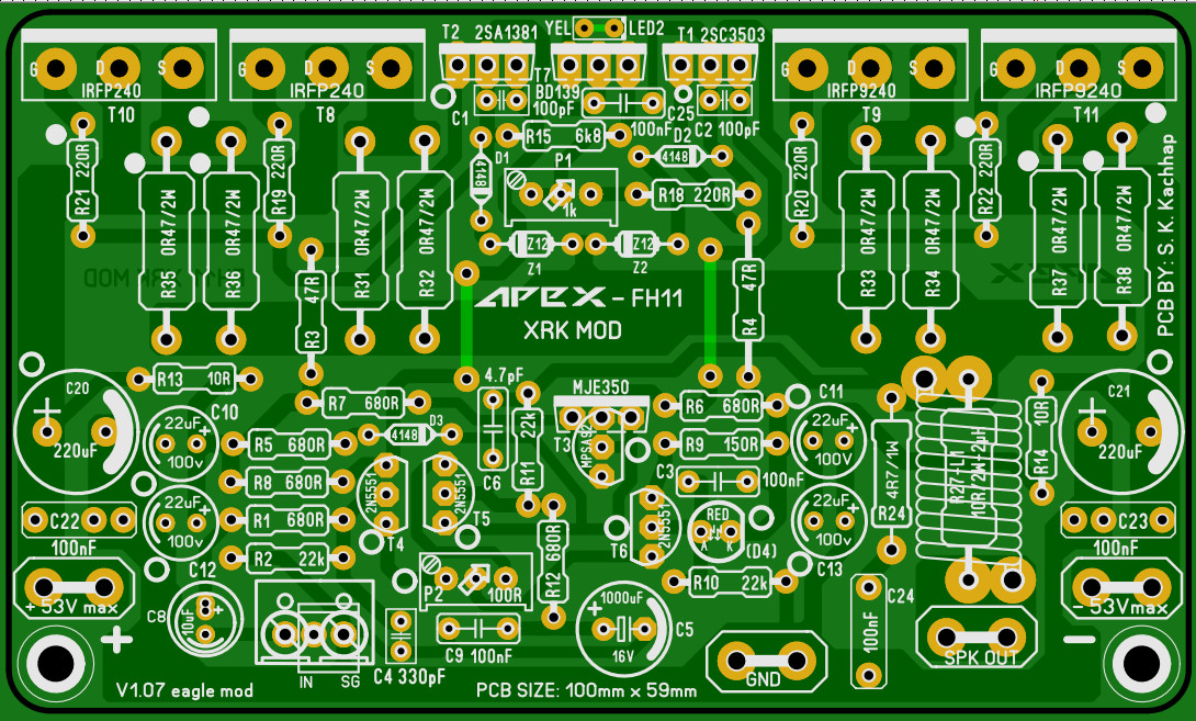

That LED is in a bad spot. It can only really be utilized if the outputs are mounted under the boards otherwise it is in the way of mounting T7 to the heatsink. I suppose an SMD LED could be used under the board. The bypass cap needs to attach to the collectors of T1 and T2.
Every project needs a deadline (FH11/FH9) The version AFTER the last version
Now with LED and capacitor
The potential of good ideas on this forum is great! Nevertheless, I will do a cut now or I might still even contribute from the seniors home! :
I will again provide the complete set of files for the FH11 V1.07, this time including the dot marks for the silk screen AND provisions for a temperature compensated VBE multiplier stage.
The layout which I used as standard is at least 3 times build and that means measured/checked.
Nevertheless I added a diode; LED2, *hot-wired* (in series to VBE multiplier transistor) and a capacitor (C25) to give the possibility to test/implement the compensation for this layout.
So you have 4 different possibilities (with FH11 and FH9): 1 side or 2 side PCB, with compensation or original as proved and tested.
In case you ordered double-side PCBs, simply fit with the components printed on the top (silk screen)/BoM besides C25 and you will get the proven and tested amp design.
In case you ordered double-side PCBs and you want to try the compensation with the LED do the same , but interrupt the track between the both pads of LED2 on the top. Then you can fit the LED and C25 and the changed resistors/trimmer.
In case you use a one-side PCB, fit all components according to the silk-screen/BoM besides C25and jumper the 2 pad of LED2. (Don't forget the jumpers for the 2 missing tracks on the top).
In case you use a one-side PCB and you want to try the compensation with the LED do the same, but leave the jumper and fit the LED2 and C25 and change resistors/trimmer. (Here again: Don't forget the jumpers for the 2 missing tracks on the top)
About reliability, xrk971, even if the scale do not fit completely: this layout is as error free as Windows 10
but I checked it several times, so I hope really heavy errors can't be found any longer. But I would ask you to check at least BoM and schematic, if all used parts are ok.

Looks very nice. But if using LED in Vbe the resistors need to be changed following diagram provided by Still4given.
Eaglemaster,
Ty you for advice, xrk971, but design is made for your original FH11, only with the OPTION to implement the temperature compensation! As long as it is not proved, that the FH11 with temperature compensation is really working better than the original one I would not like to change silk screen or BoM. And if you had a look on it (schematic) you can see that the LED right now is still hot-wired!
As you told, you think about ordering some PCBs, then you can test if it works and if the values of still4given fit well in the FH11. As I could see you have the equipment to test it easily!
If the improvement and values are really sure, I would of course adapt schematic, BoM and layout.

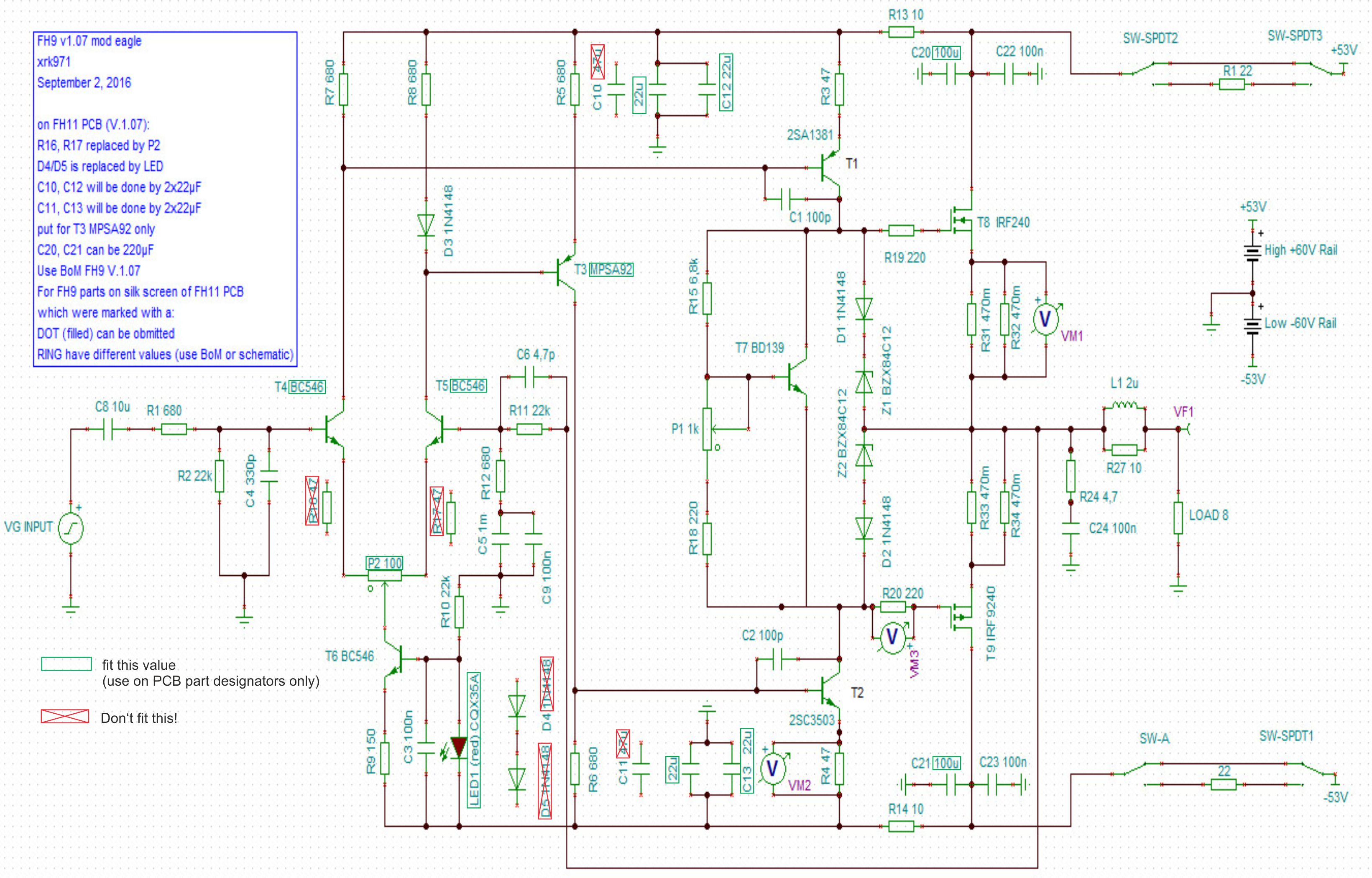

FH9/FH11 adapted to each other (II); FH9 on FH11 PCB
Until now I provided all files which will be needed for a FH11.
Now you get all information to fit a FH9 on the FH11 PCB.
You only need a adapted schematic and a adapted BoM.
Both you will find attached.
Don't forget to fit the Thiele network or put a jumper!

The Thiele Network includes both the R+C and the damped L......................
R24 = 4r7, C24 = 100nF, R27 = 10r and L1 = 2uH
All four components form the Thiele Network.
see my post from January 2007
http://www.diyaudio.com/forums/solid-state/94029-when-output-inductor-needed.html#post1105724
Read the 1975 Dr Cherry article, if you don't believe me.
Many thanks, AndrewT, to clarify the terminology to me! As I could see you deal since many years with this subject. I must confess, I didn't go into details.
Unfortunately I was taken in by information like this:
'There is much confusion about the naming conventions of these output filters. Technically, the RC series network is the Zobel network and LR parallel combination a Thiele network.'
But back to my post:
I made this remark, because without a jumper nothing comes out at the speaker terminal when fitting a FH9. It's not my intention to 'change' in anyway the proved design of FH9 and FH11 (one with and one without the L//R part).
Though my time is limited, I would like to know more about it.
Do you have any link to the Dr Cherry article?
Unfortunately I can get the original Thiele article (I'm not member of the Audio Engineering Society and $33 for information only, is a little too much for me).
But I'm interested in your opinion: Are there good reasons why FH9 and FH11 are different in this output network? And is it true (I read it anywhere) that the values must be adapted to the speaker parameter (probably loudspeaker cable too)?
