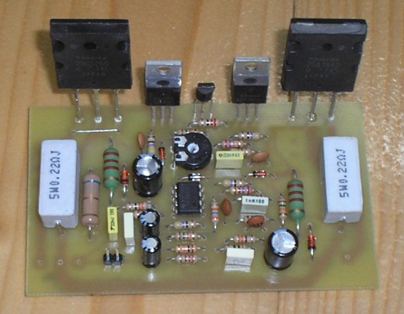

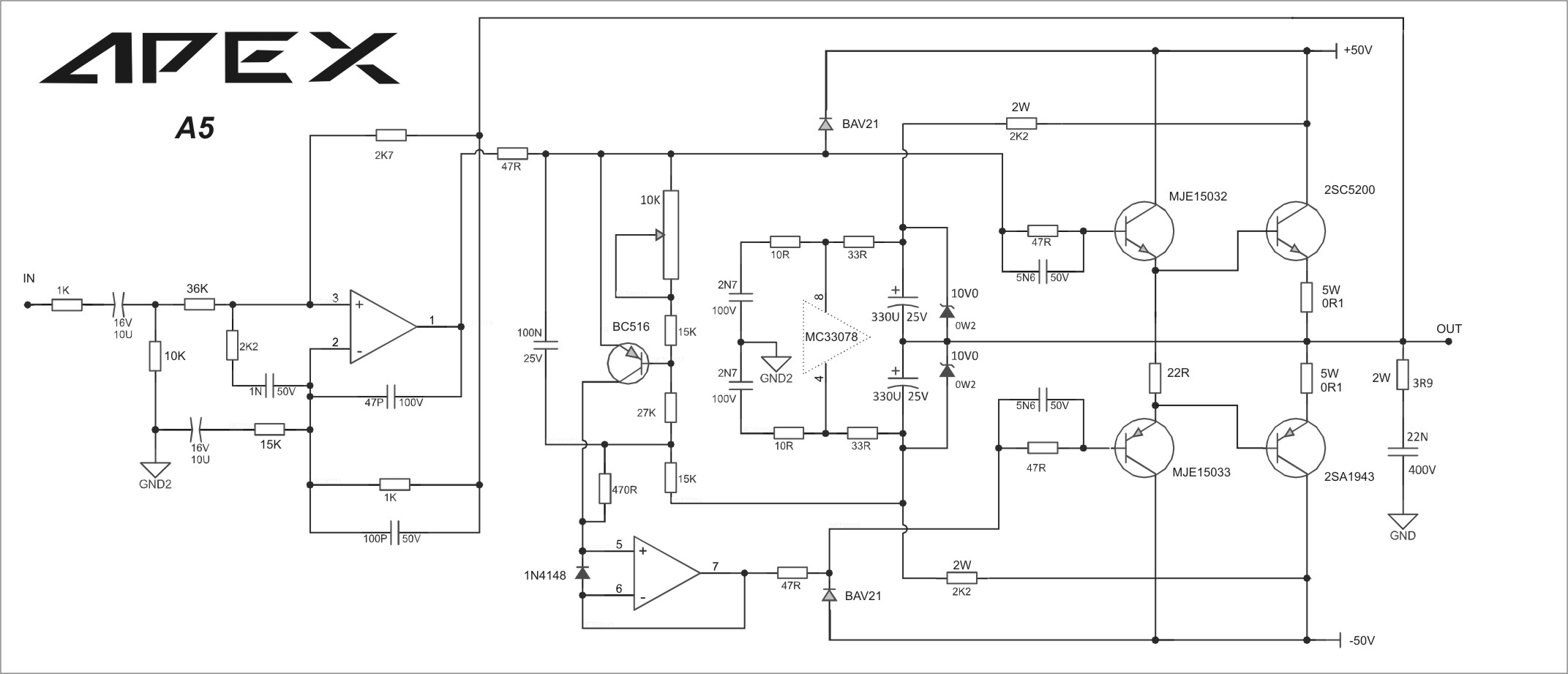

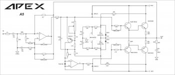

I love the simplicity! Very nice Apex Audio! Can you show me where schematic is posted so I can add to the Directory thread?
How does it sound compared to FX8 (the bench mark of comparison)?

I too would love to see the A5 schematic, unless you've already posted it in the directory and I was to lazy to look first.
