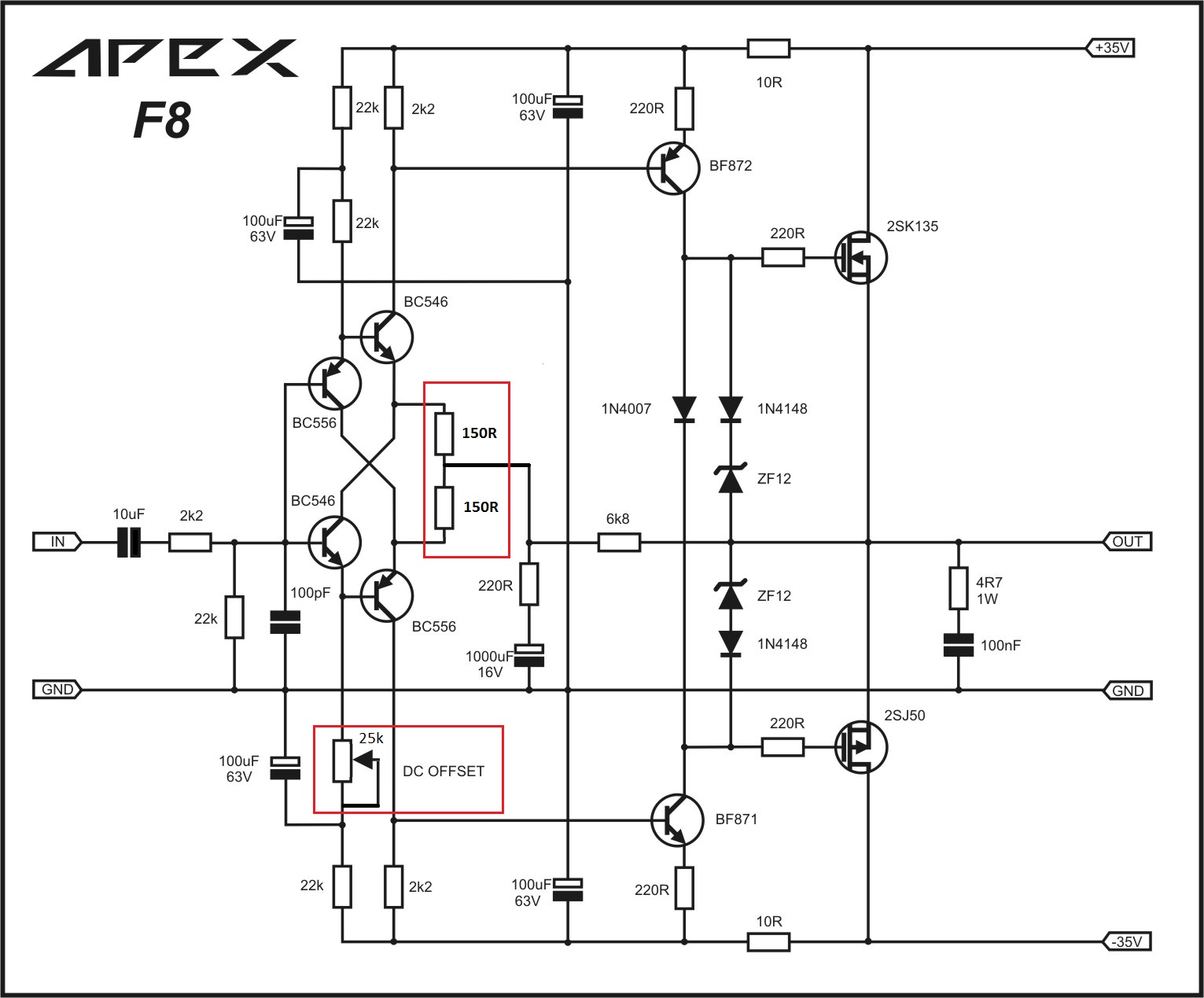

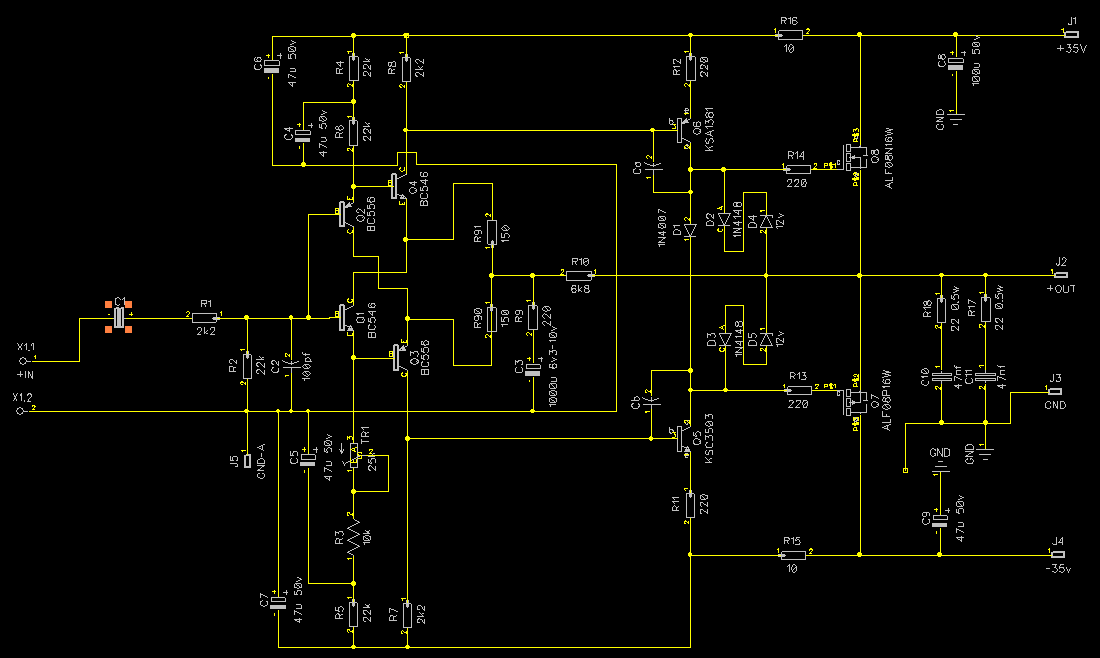

Still4given, is this the conversion that you did to the second channel?
Yes, Here is the modified schematic.
Hy sir Mile what changes need to make for tip35 tip36 as output In AX 11?
Where i find Sprint file of this AX11?
No, Mile, ALF16 are double dye, but same polarity, there are ALF 16N and ALF 16P. You can choose TO264 or TO3, 160V or 200V.
16 is the number of Amperes.
I made my FX8 with ALF08NP, both N and P type in same case, but they are rated at 8 Amperes.
ALF08NP16 is 8 ampers 160V complementary pair same as 2SK1058/2SJ162 pair, just my notification mistake.
I converted the second channel. I have taken some scope shots and am posting them below. I also played about 12 songs through it. It really sounds quite lovely. Whoever complains about the bass from lateral MOSFETs needs better speakers. This amp goes deep and the bass is tight. Really, really nice sounding amp.
I also monitored the offset more closely and it is actually quite acceptable.
Complains about the bass from lateral MOSFETs is usualy complains about CFA amplifiers.

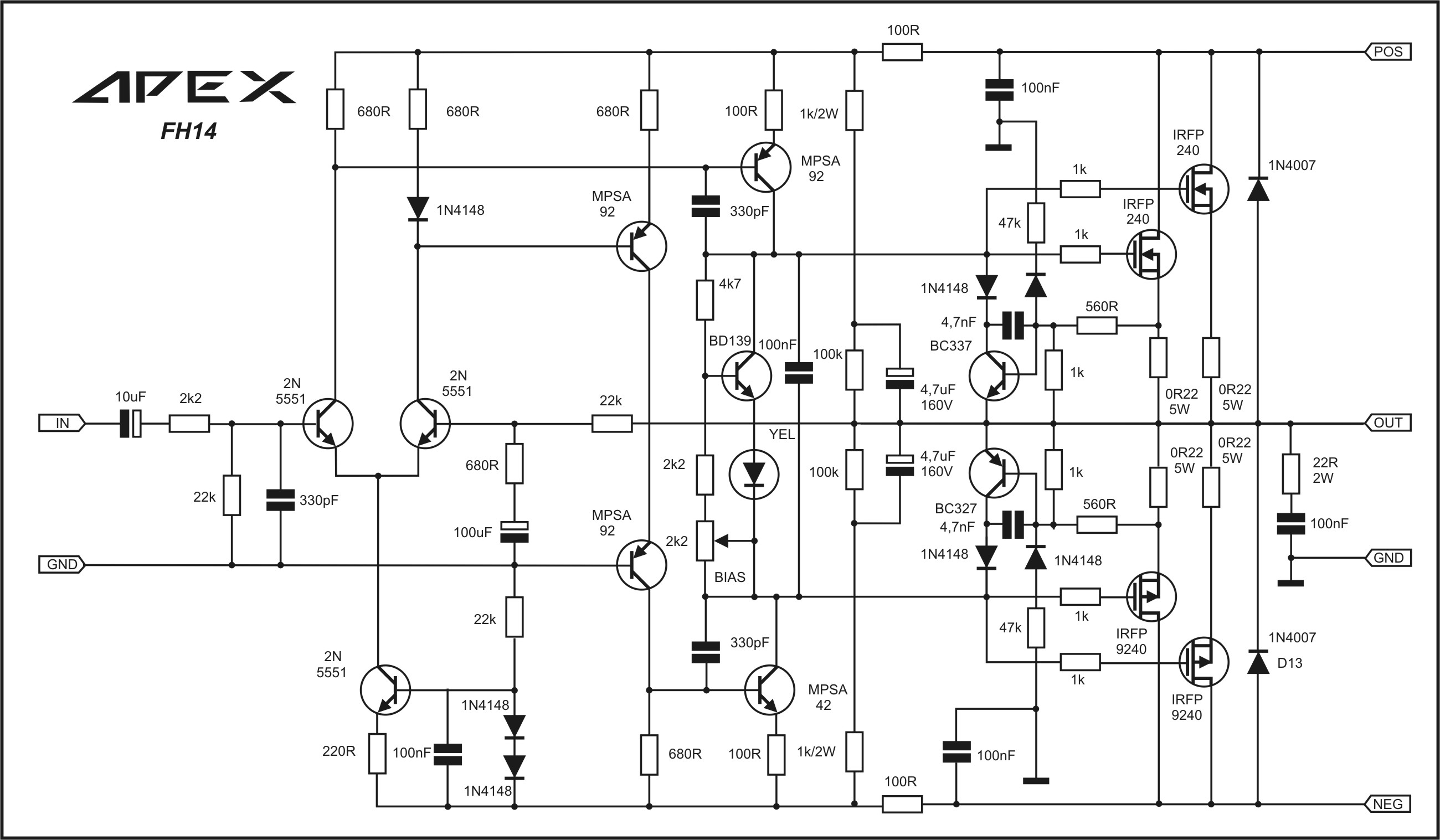

Very similar, the FH14 and FR100? What would the sound difference be?
FR14:
FR100:
FR14:
FR100:
The output stage is the only thing that is the same in those two amplifiers. Difference is in the input stage: FH14 = well known Sansui, FR100 = classic Marantz VFA.
Input stage is very different, FH14 drive VAS directly from LTP in positive side and with current miror for negative side pure push-pull VAS topology.
FR100 use one more stage current driven folded cascode topology that give higher slew rate and lower THD compare to FR14.
I don't know about sound difference but FR100 have better performance.

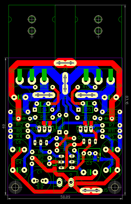

F8 based on Sonal work, but with AndrewT advices about 0V layout and double die Latfet Allfet and zener protection on board
Nice work,
Regards
Hi Marc
Very nice!
I think I will build these I have some dual die mosfet from Class D and some Exicon to.
If you order multiple PC boards I would be interested on a pair..
Otherwise if you share the file with us may be I order if I find a good place (price wise) from were I can order only 2 pieces...🙂
Curios to compare some of the VSSA variation 😀
Greetings gabor

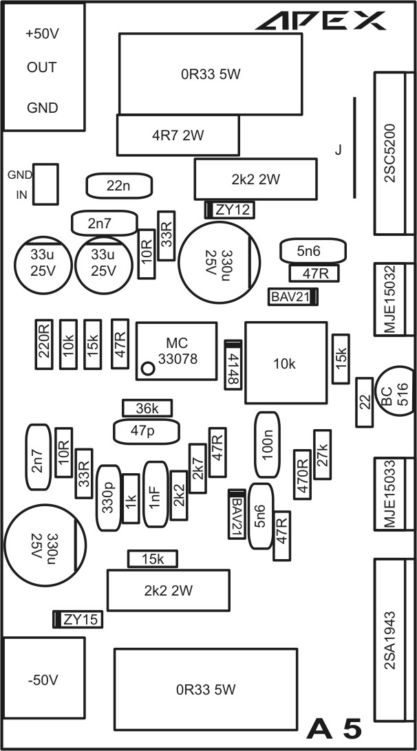

It's an amp i want to build in small mono bloc form factor. 10U coast to me 25$ shipping incl.
Marc

PSU can be used for stereo amp, but beter use as dual mono.
Hello apexaudio
Can I use this PSU circuit and pcb from post #328 for 35-0-35 400VA transformer. what other component i have to change if I Want feed to 100 Watt ultimate fidelity.I have 4 10000uf/50v capacitor.what is replace for 2sc5200/1943.
Hello apexaudio
