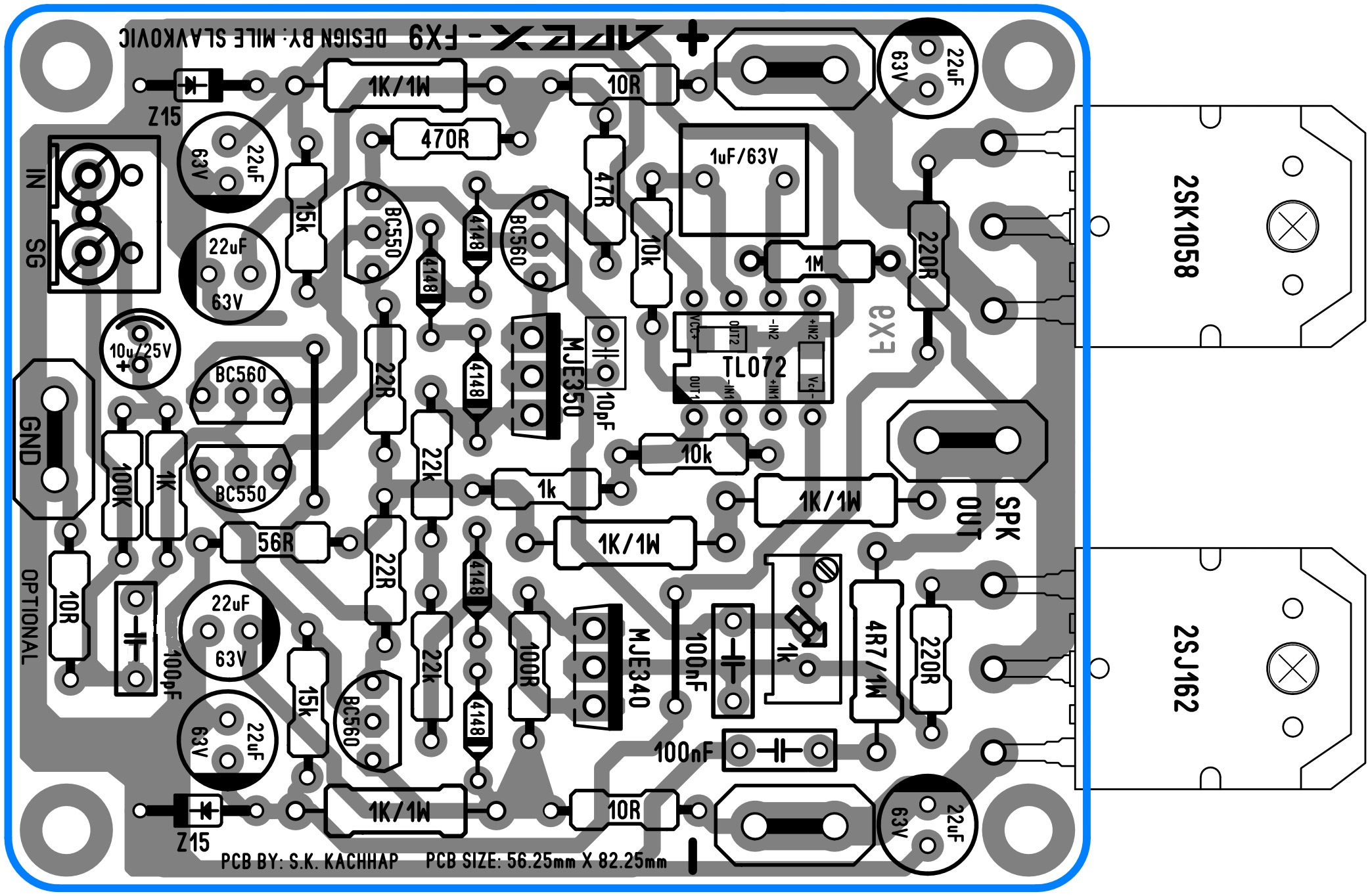

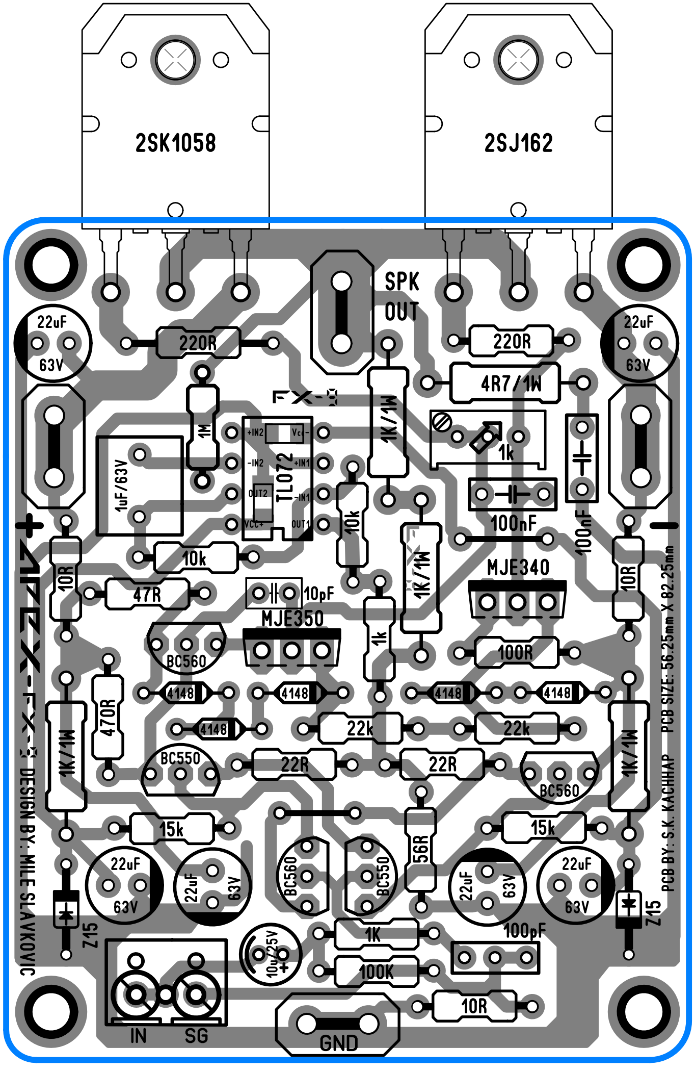

FX9 pcb with corection.
FX9 pcb PDF files with recommended correction from Mr. Miles.
What is the correction?
I was able to spot one difference, 56R is connected to 22uF.
The resistor above the two 22uF caps being changed from 10K to 15K?

OK, I found the "correction". The NFB ground is connected directly to power ground. SGND is still lifted. I tried it both ways and I don't see or hear any difference. The FX9 has crisper square waves in the upper frequencies but is a little less stable in offset. Not enough to affect the sound at all. You can see the servo working all the time. Tomorrow I will hook both the FX8 and FX9 to my A/B setup and see if there is any audible difference.
Borys recommended correction to remove 10R from feedback circuit.
