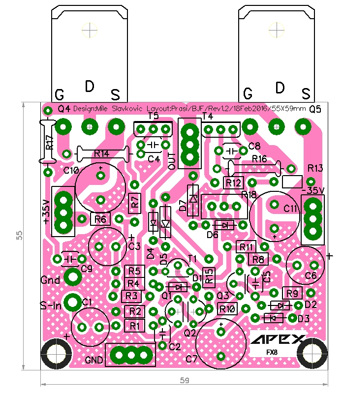

My FX8 layout, Rev 1.2 with GND replaced with a pour. 1.5mm clearance between GND and +/-35VDC power rails, regular clearance (0.5mm) between GND and everything else. As you can see, the GND pour only continues up to about R14 or so - a little higher than required. Could also turn OUT and +/-35V into pours if one were anxious to completely fill the board.
I wanted to float the idea of a GND "pour" to act as a bit of an EMI shield and reduce etch area. Back In The Day(tm) we started filling all empty area on boards to reduce production costs by decreasing the amount of etched area on a board. So empty board space feels "unnatural" to me at this stage...
I don't know if pours are counter-indicated by the prototyping/DIY PCB process or the small size of the board, but DipTrace sure makes them easy to do...

R16 needn't be that big, its a 1/4th W resistor. Use 10-12mm lead spacing package, that will make the trace connecting G shorter.

You can see now why I made the track so wide, which you commented on previously. I thought that was a "big" wirewound resistor. I assumed because of the span of R14, that R14 and R16 need to carry more power. Little did I know that the extra span was for routing purposes.
Forgot to say about Rev 1.2
- Added Apex logo. The graphic is on the silkscreen layer, and is opaque. The "pour" indeed does fill in behind it.
- I need to add a caveat that I have not built this. I have parts on order, but realistically, it will take 3-4 weeks (!!!) for me to have a test bench ready. Seems like by that time, everyone will have moved on to the FX9? We'll see.
- The pink checked pattern looks a little like gingham. NOT intentional. We trying to imitate your color scheme on one of your screen captures.
- Have shrunk the board only slightly. There is a price break @ 5.0cmX5.0cm for some Fab houses. I can continue to try, I guess, but it's possible that it can't be done within the design assumptions. Other stuff: the 5X5 limitation is for production boards - the current design constraints are for home-brew PCBs. Alternatively, I was thinking of moving all of the big caps off of the board and wiring them in. That approach can be tested with the current design.

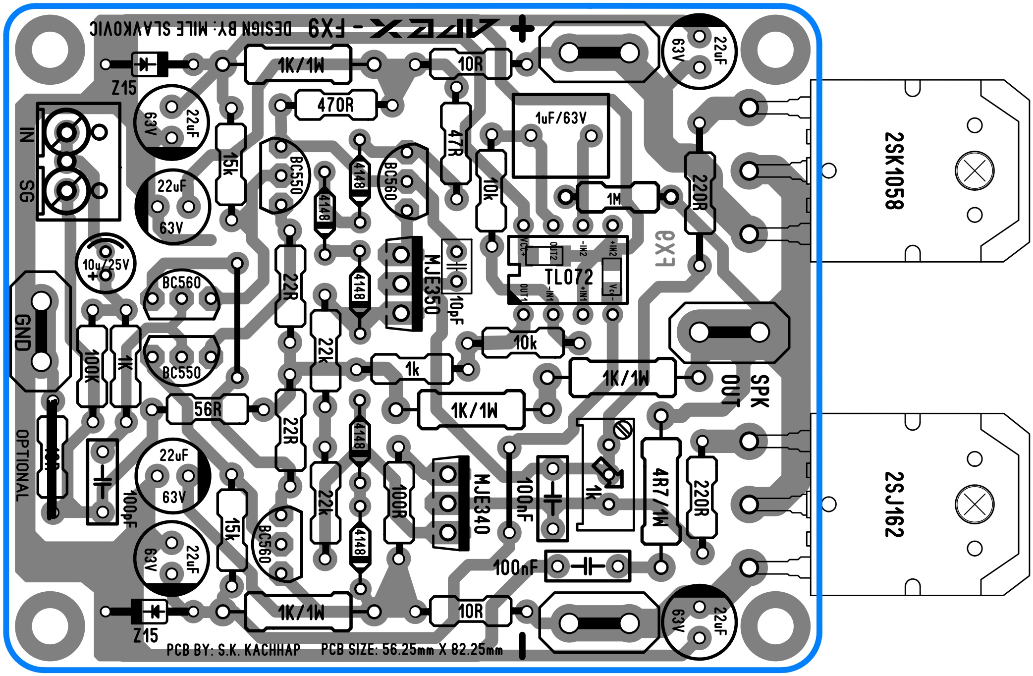

I wanted to report back. I tried adding a cap to the gate-source of the SK1058 and see no change. I will probably just leave it alone. It sounds fine like it is. A couple other things I noticed with the FX9. The offset is a little high until the amp warms up. When cold it is about 40mV even though there is a servo. Once the amp warms up the servo can hold it to +-2mV.

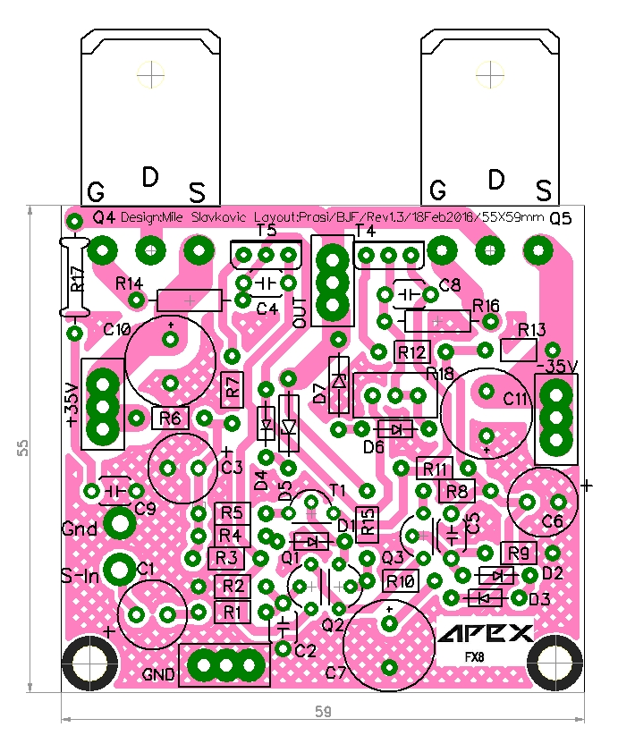

Rev 1.3 with the new spans for R14 and R16.

If we go by the views expressed by members here, ground planes are not recommended for analog circuits as they might lead to loops and related issues. May be someone else (AndrewT/Mr. Mile/Jay/Sonal Kunal) can pitch in confirm that your layout will not create any issues🙂 for this amp.

Mr. Prasi:
BF
- I use it, because eagle CAD has limited color capability and it gives a good contrast with top silk and bottom copper.
-no use moving big caps off-board, defeats the very purpose of having on board bypass.
Could the 1 uF cap between pin 6 and 7 be doing that ? (just a hunch). Never seen such an arrangement in DC servo, atleast for APEX amps. Only Mr. Mile can suggest.
Try with 470k instead 1M and 470R instead 1k in DC servo circuit...
I have suggested that the amp output offset be adjusted to near zero when it is cold and just a few seconds after being turned on.I wanted to report back. I tried adding a cap to the gate-source of the SK1058 and see no change. I will probably just leave it alone. It sounds fine like it is. A couple other things I noticed with the FX9. The offset is a little high until the amp warms up. When cold it is about 40mV even though there is a servo. Once the amp warms up the servo can hold it to +-2mV.
Then the DC servo has no work to do to correct an output offset at the time of start up.
As the amplifier warms up the servo reads the small (and changing) offset and sends a correction signal to the set point node to hold the offset to the servo's best ability.
This arrangement also suits using a delayed speaker relay. When the relay turns ON the DC servo is already active and has started to apply what small correction is required for the nearly cold amplifier.
