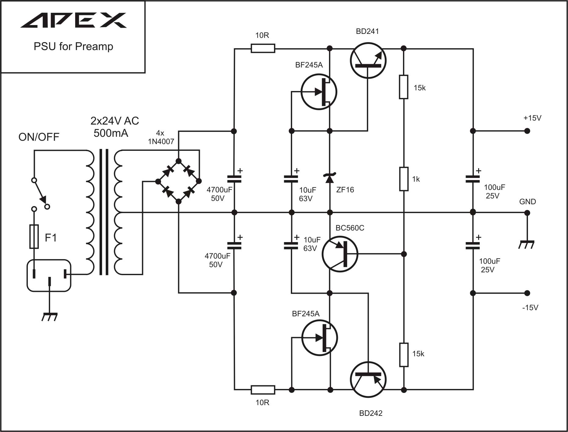

I made a quick sim of A Class PSU to find out if the SK devices will work.
I used SK117, a low noise jfet counterpart for SK246 (no model available in Multisim lib). All 2N devices for the small TO-92s and TIPs for the output regulator. It seemed to work without a problem, trimmer adjust is set to 80%.
At 100% it is outputting 32vdc.

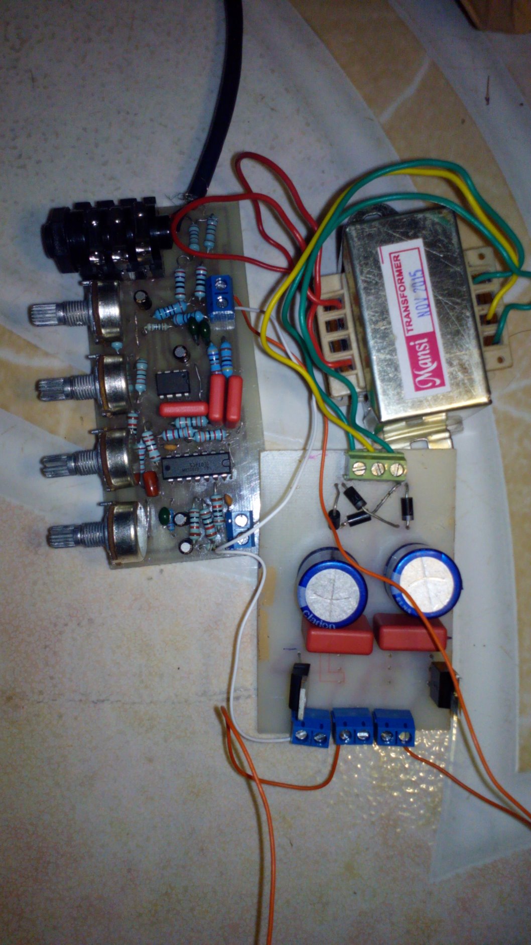

I built the other Apex Preamp PSU regulator (+-15vdc) and I also used 2sK246gr. The minus rail output voltage is slightly higher than the positive rail, but not sure though if the fets is causing this voltage imbalance, and I cannot tell if the fets that I used are genuine Toshibas. My knowledge is that a lot of these TO-92 fets out there in the market are no longer genuine.
You could try those SK117s it might fix the problem. Hopefully 🙂

Mind you, 2SK117 has a different pinout, you have to rotated them for 180° in order to match 2SK246 pinout. Also, 2SK117 is not 2SK246 direct replacement, but it may work. Try to find some 2SK30 in yours parts bin, these are much better choice for the CCS role.
I'm not sure what they add to this circuit and wonder if the circuit could be made to work with BJT CCS.
The circuit will work with any type of CCS, be it J-fet, M-fet of BJT as long as they are adjustable, since your voltage reference is a resistor (Vref=IxR)

Can we use BF244 instead BF245 they are very similar.
3 X BF244A N Channel RF Amplifier Transistor Free Shipping | eBay
Very likely if has the same pin out..
Pin out of my BF244 and BF245 are different, even though they are the same manufacturer !!!!
a, b & c are the Idss grades.
All are low gm, high pinch off voltage and make good cascodes for 2sk170.
