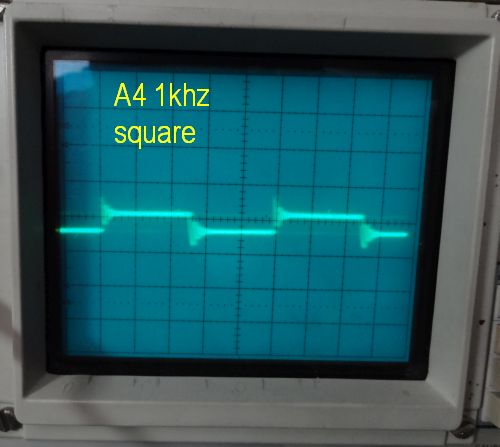

This is what I'm seeing.
The sine wave is at less than 1V output. The square wave is barely on because any more it will go into complete oscillation.

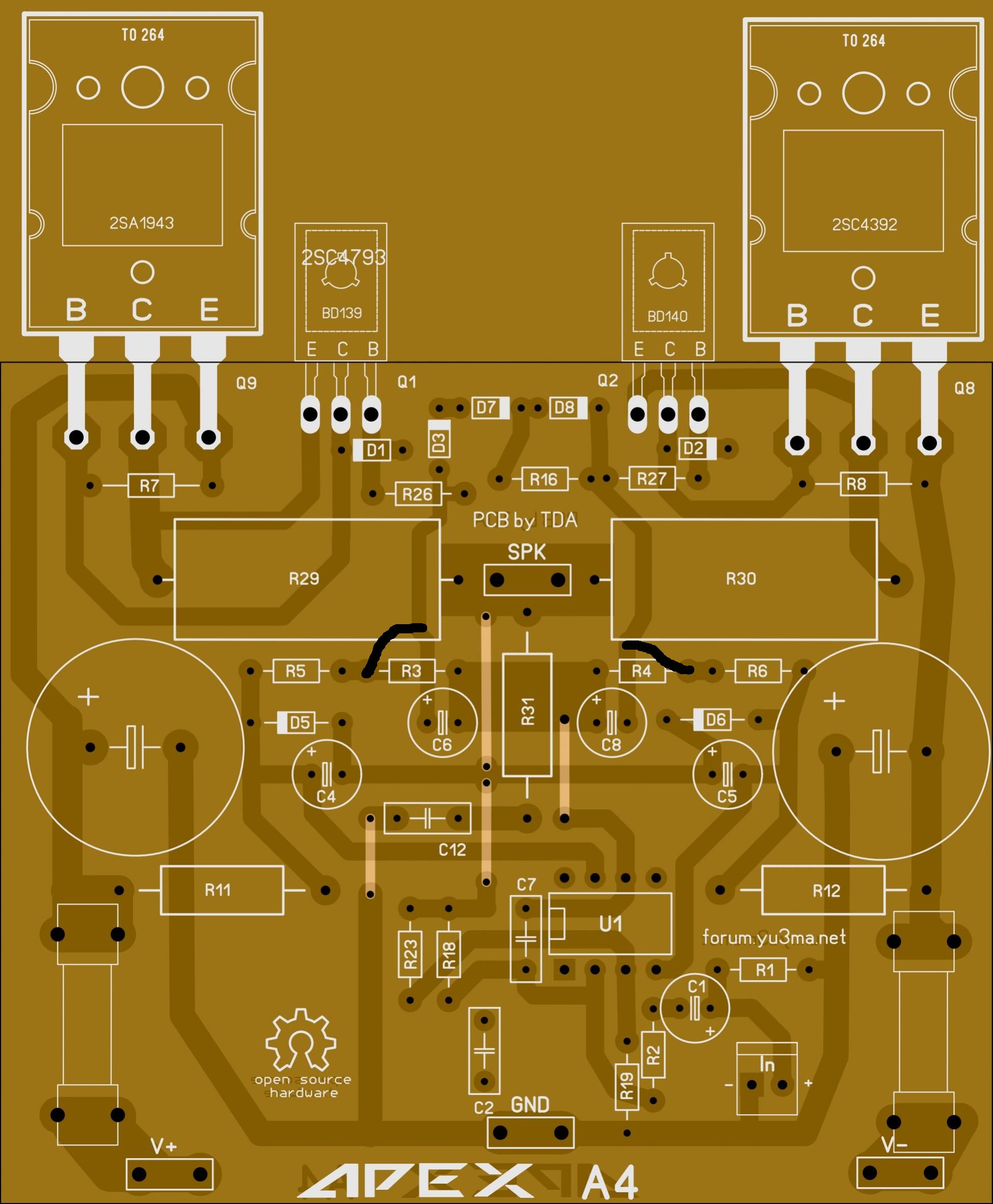

Can check connection between [R5, R3, and C6] and [R4, R6, and C8] those were missing in last image you post.
I should also build and check on strip board I have all parts required.
Hi Sonal,
Good catch. I had fixed the connection from R5 but missed the one from R6. Unfortunately I just connected it and not the bias is way too high. This circuit doesn't have a pot to adjust that. I'm not sure where to insert that but it looks like it needs it.
Blessings, Terry
Wow, I typed that from my tablet and didn't notice that it translated "Thermal Trak" to thermal transfer. 😀 With ThermalTrak outputs D7 & D8 would be on the heatsink already. If I can get this working and it sounds good I may try to do a layout for the TT transistors. I'm going to try lowering the bias right now and I will report back.
Blessings, Terry
OK, I just tried paralleling a 100R pot with R10 and even at it's lowest value, R16 = 0.1R I still have 300mA bias and that is with the light bulb tester in place which is reducing the rails to 7V. Without the light bulb I'm sure I would have blown fuses. Something is not right. Has anyone tried the spice file I made? If I can get that working I will at least have a working circuit to compare to.
Thanks, Terry

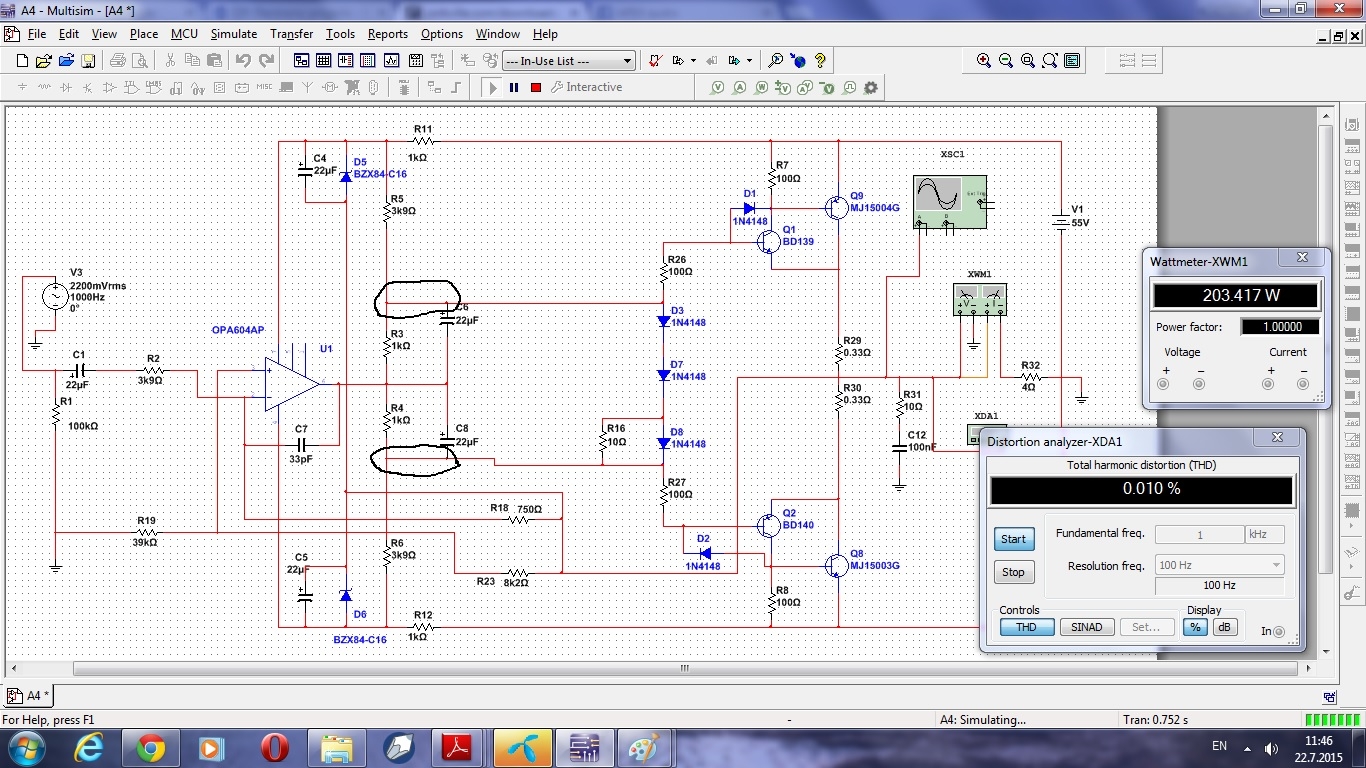

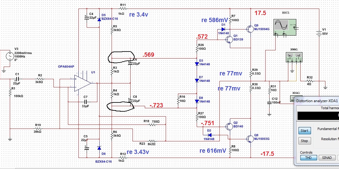

Can you post voltage reading at opamp output, between R3-R5, R4-R6 and voltage across D3, D7, D8.
Lots of software were uninstalled for windows 10 upgrade. I better re-install multisim to simulate A4.
I had to pull the IC to get the rails high enough to activate the zeners. I didn't go much higher for fear of burning something. Attached is a marked up schematic

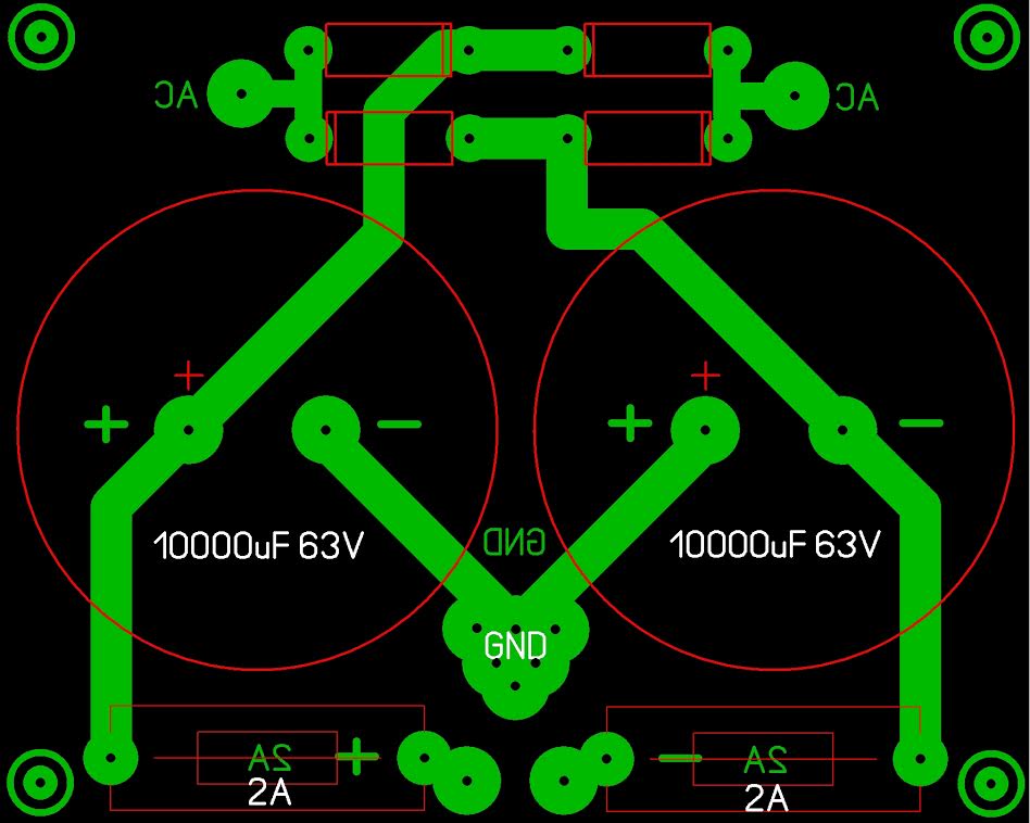

These post will be off topic! I only post here because there are several people here who design or draw PC boards layout.
I would need something like the attached power supply board but with 2 pair capacitor and CRC mode.
Also it would be good if I could use MUR860 diodes. No fuse needed on the board..
If someone know similar design on the forum already exist please let me know
Thank you very much
I tried with Sprint 6 and just wasted a couple hours with out any good result.
Greetings
