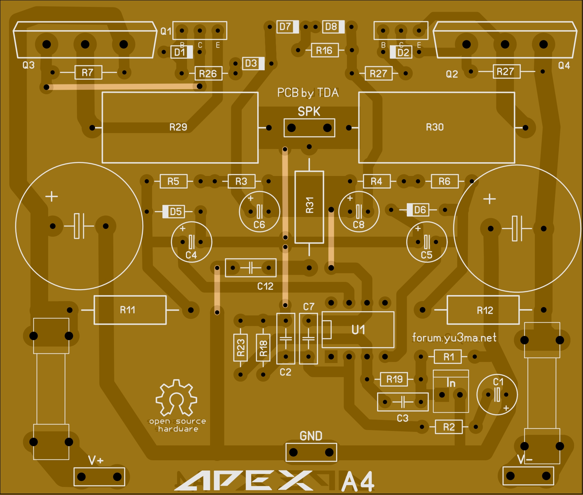

That's really cool! I am just learning Sprint. I shrunk youR layout down so I could fit two boards side by side on a 6-1/2" PCB. If you don't mind, would you look it over and see if I missed anything? I hope you don't mind me doing this. Just trying to learn.

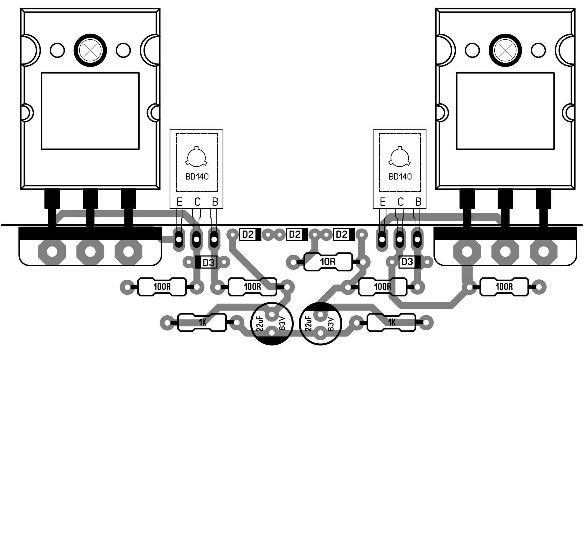

Hi Terry,
BD139 and BD140 plastic side will be towards heat sink in current orientation.
I have started layout for A4.(Ignore copy paste it will be corrected when layout is completed)
Sonal Kunal.

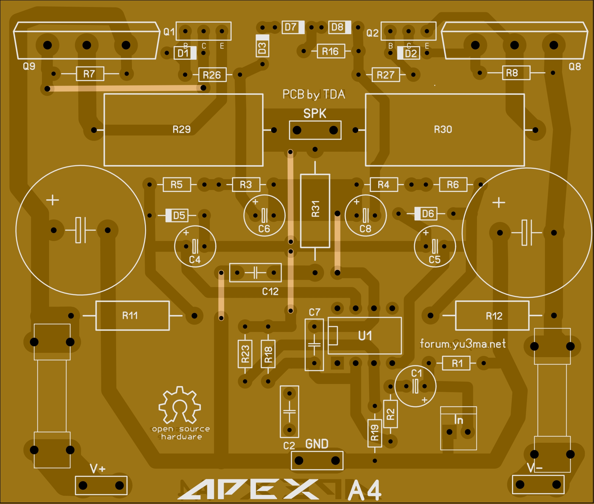

Yes, I just noticed that it called for BD139/140. This layout is pinned for TO-220 so I used those. Not sure how that will affect the circuit.

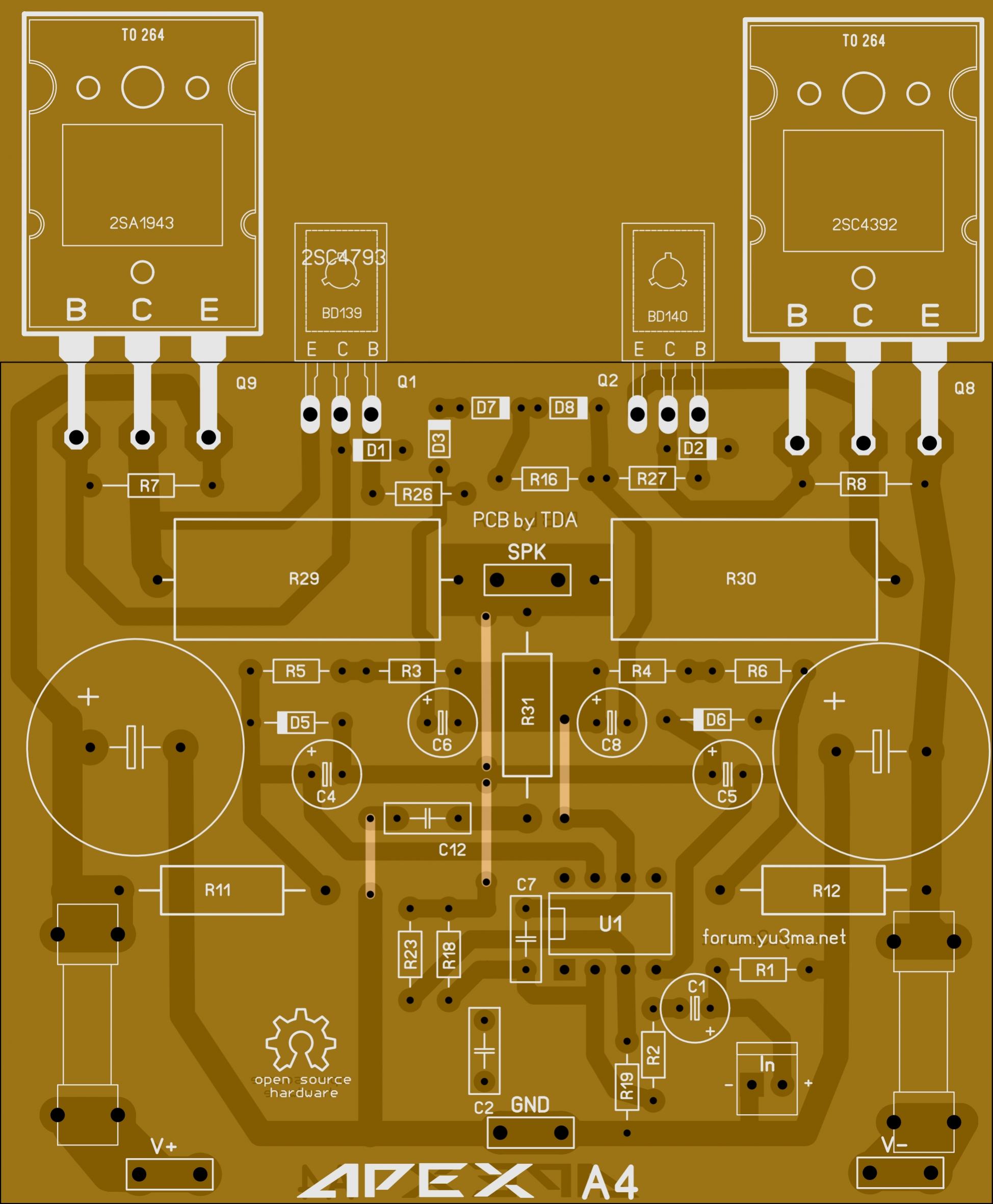

In the interest of learning I've tried switching things around to utilize the BD139/140. Tell me what you think.

Still4,
have you swapped in an ECB device (To126), where the PCB is laid out for a BCE device (To220)?
I'm not sure I understand the question. The schematic has BD139/140 for the drivers. BC109 used TO-220. Since I am modifying his layout I tried to swap in TO-126 devices to match the schematic. I'm trying to learn how to use Sprint so this is good practice for me. I'm also cheap and wanted to fit two channels on one board and my boards are only 6.5" wide. :p

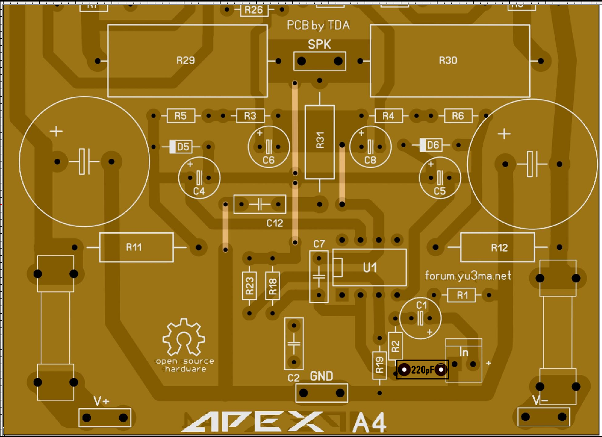

Now for testing. OSCILLATOR. :eek:
It will play a sine wave but it has some ugly stuff one shoulder. Square wave send it into almost instant oscillation. Thank God for the light bulb. ;)
Now a couple of things to note. I am using a TL071 for the OP, 2SC3423-Y/2SA1360-Y for drivers and MJL21193/4 for the outputs.
Everything else is per schematic. Waiting for suggestions.
You can add 220pF capacitor after 3K9 resistor connecting to signal ground and check. Then try to add capacitor from base of to collector of 2SC3423-Y/2SA1360-Y parallel with diode on copper side. Check with 100pF first.
Sonal Kunal.
