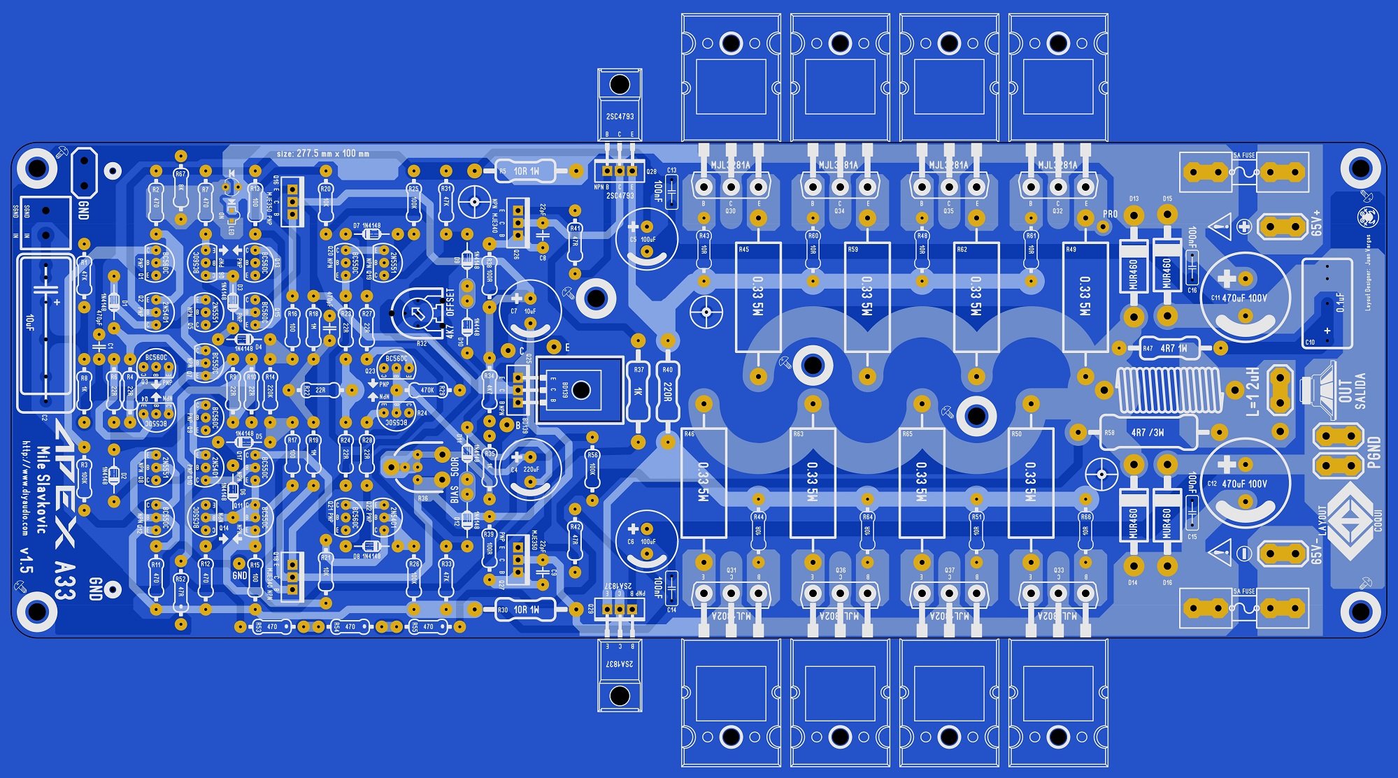

yes sir you got it 🙂 , maybe your part number are different from your software layout so don't fallow my simulation PDF so you don't get confuse, use original schematic 😉 and you be good to go
what I did is to simulate the circuit then I use the same part numbers from the simulation and use them as guide on the layout
Q3,Q4 are thermal twins
Q6,Q13 are thermal twins
Q14,Q11 are thermal twins
Q23,Q24 are thermal twins
when I mean twins is that they share the same temperature core for been together,
I was thinking to couple them with a little thermal paste then surround them with a small piece of shrinking tubing there is more theories about this but let go simple for now 😀
yours look amazing sir :cheers:
yes you did it nice 🙂 now those 8 important TO-92 are placed correctly nice Idefixes :cheers:

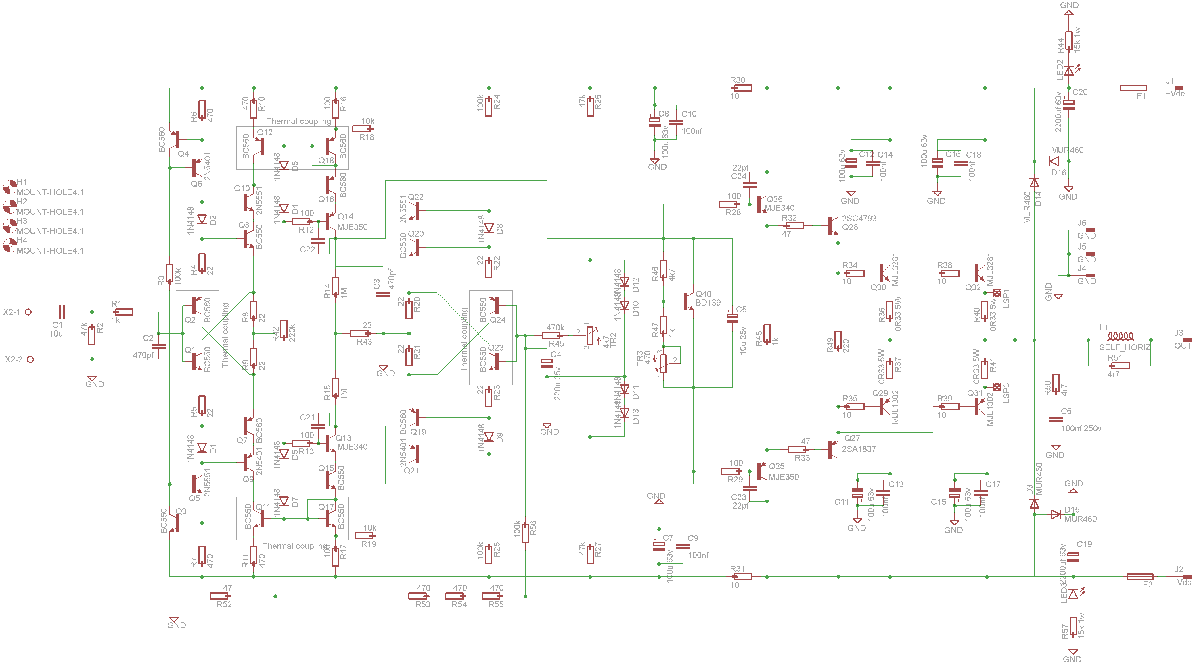

Hi Juan,
As there wasn't any part number (not value) on Miles schematic Eagle introduce them automatically. I just organize them : mostly symetrical part are numbered impair in -V area and pair for +V area then non symetrical left to rigth (Follow schematic under). I had to spend time on cheking layout but as eagle provide accurancy between schematic and layout with linking unrouted tracks issue can only come from schematic and issue in library model pin distribution.
Marc

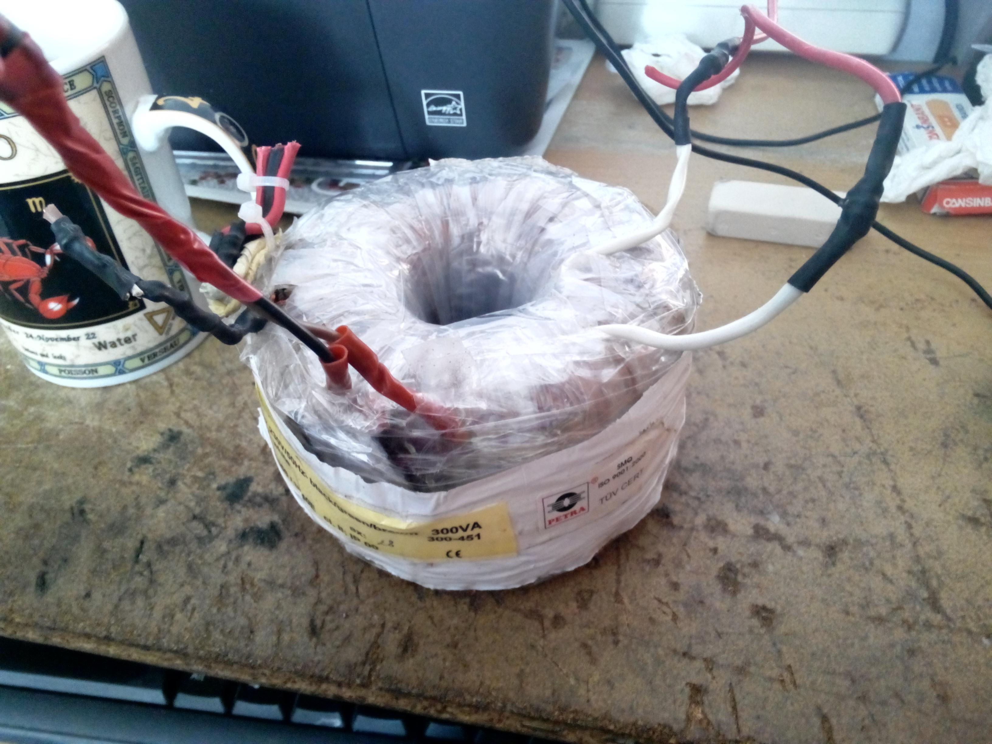

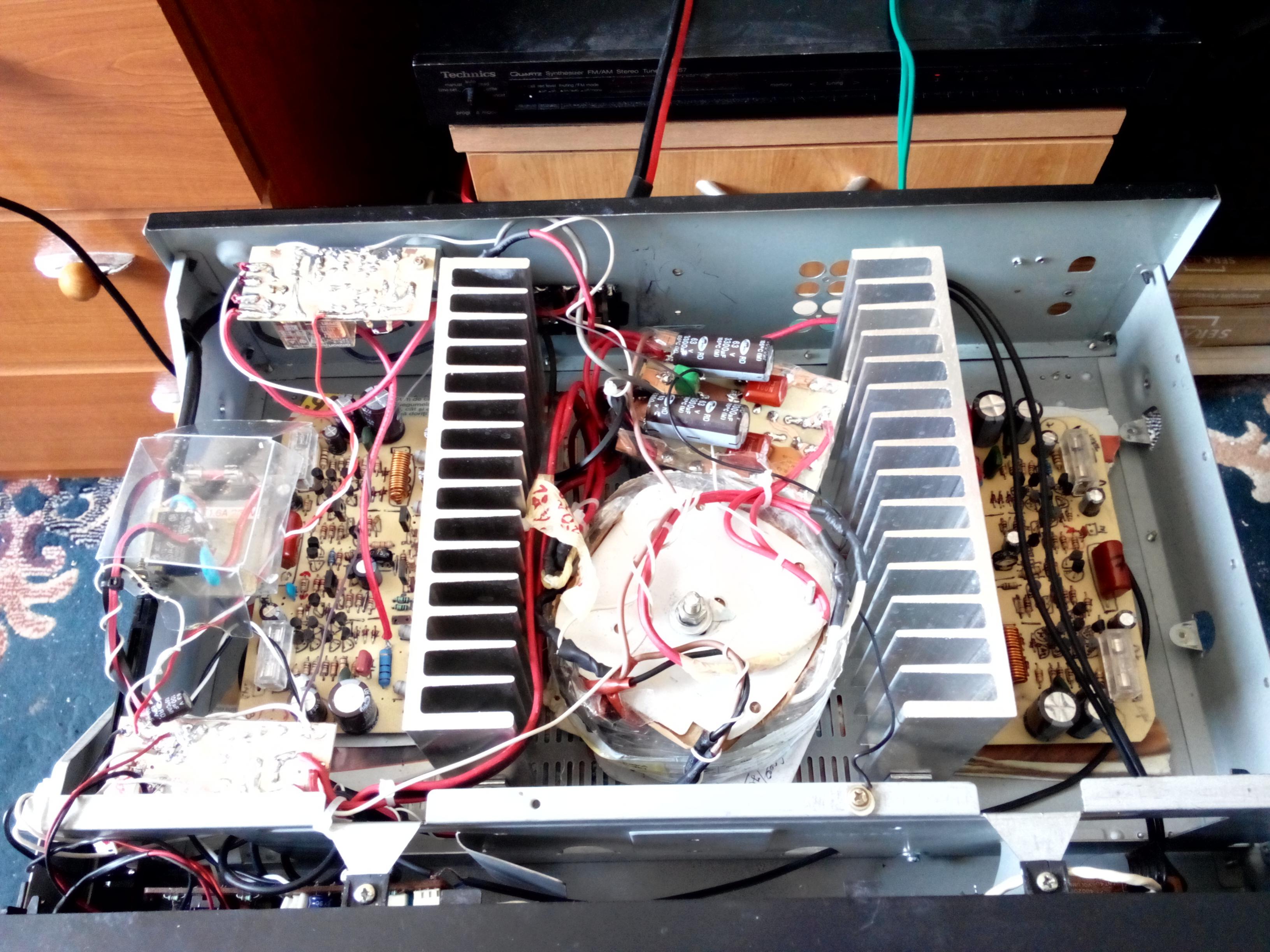

Finaly finished to put together my A33. For 3 weeks I tried to remove a annoying hum.
I used a toroidal traf , and couldn't reduce the hum not to hear it next to speakers at minimum volume.

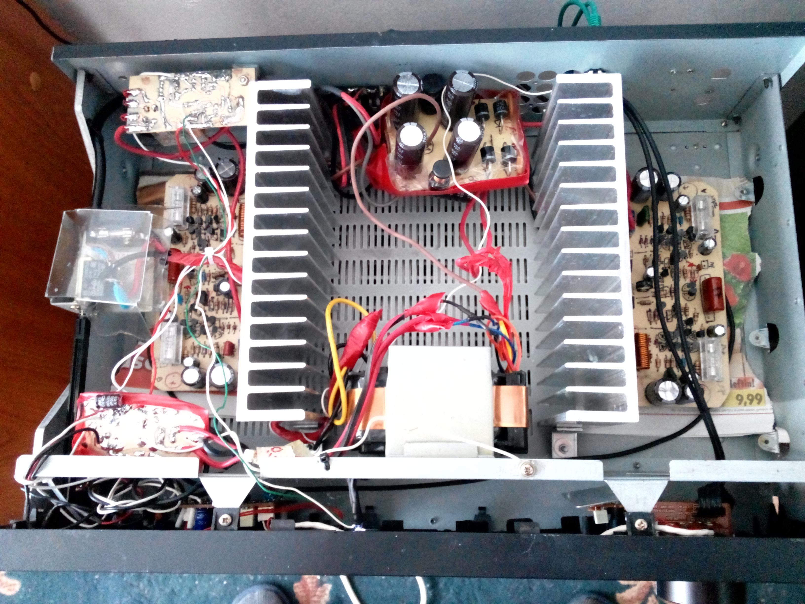

Last change was to replace toroidal traf with a regular one , section 15cm (square) and the hum disappeared. Now I can't hear it at minimum volume , next to a 90dB pair of speakers. At max volume , no imput, a little noise , but I never reach at that point. That (very) little noise(at max point) could be due to the preamp...
C21,22 from the last post (VAS transistors B-C), is needed to be put ?
I only set those 22pF from predrivers.
Now I have to set parts , inside the housing , in places.

A 10VA EI trafo will exceed a 1KVA toroid in emitted EMF.
OS
Maybe it was in wrong position , or something I misstake there. Or just maybe something wrong whith that item
I appreciate your work , and I submit that you are right.This is a particular situation. I post a photo of the first situatin..

Sorry, I put traf back on table now, and press it with a hard surface, like in housing, and.... Secondary winding deliver difference of 2.7V,when it's pressed. A little buzz,... I think I have to rewind secondary.....

Hello guys I just want it to show you a "visual representation" on how is gonna look like with two popular transistor structures TO-3PL and TO3P I think looks great 🙂 the PCB size is about 277.5 mm x 100 mm for power transistors I'm gonna use MJL3281A/MJL1302A or maybe Sanken ok guys I will then take a break on this until I have the PCB and test it I will post results
wish me luck guys :wave:
soon I will order
"sorry I have to edit" soon in a few weeks 😛
Regards
Juan
