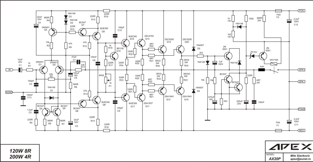

how max Voltage supply for AX20, for +-90v any part modify?
and recommended type of final transistors?

hello sir so far mister Mile mention that 65V+/- is the maximum 🙂

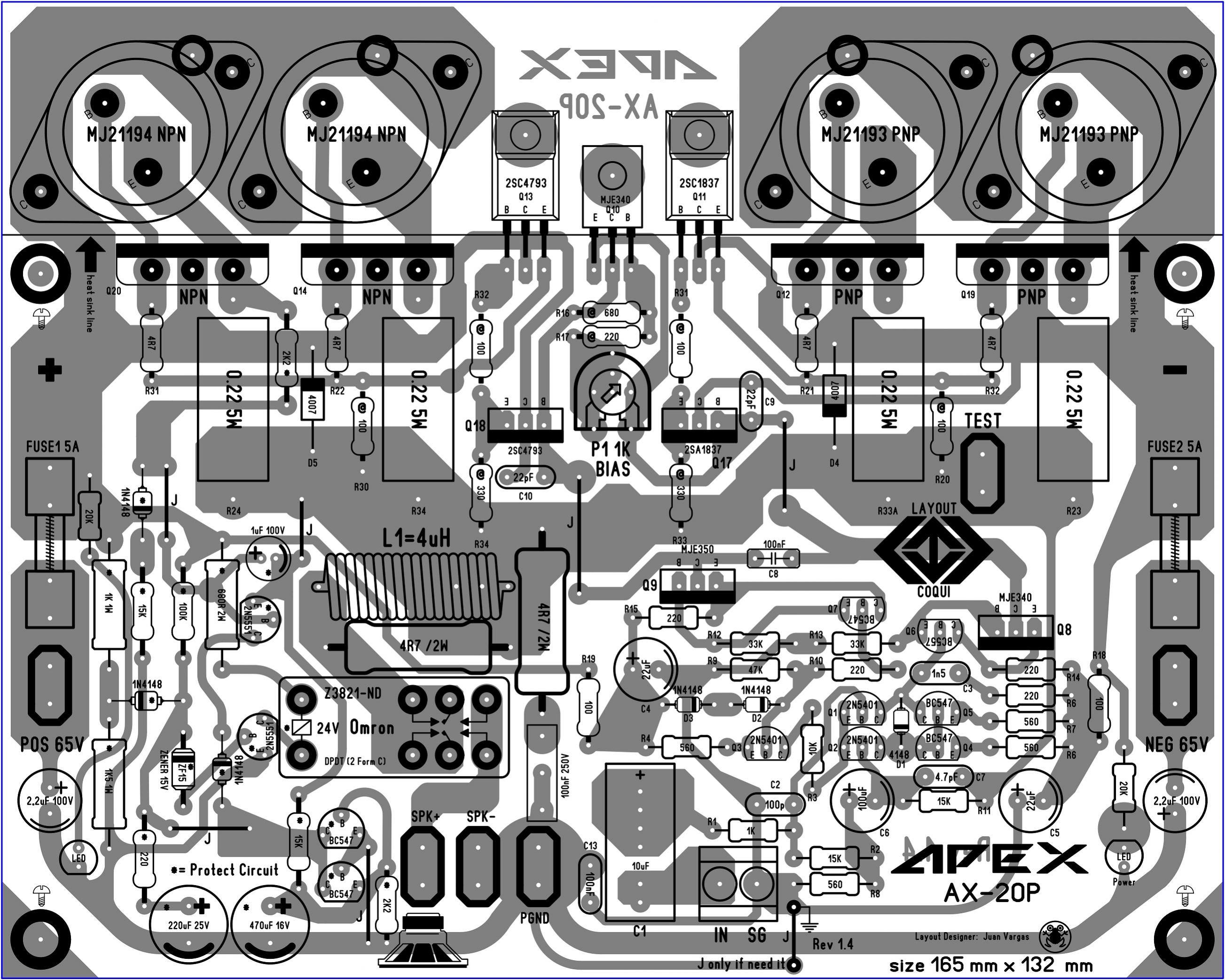

PDF for ironing Sir.
Hello sir here are the files also the reference schematics I use, I did some changes on the layout for my self but you can use the schematic and change some values of the AX-20P to be the original values from AX-20P schematic, I spend a couple of day already checking for error or better say "bugs" and I have not found any more so far, if you guys see any error let me know so I can fix it right away I said this because eyes get tired man 😛
ok here are the files 🙂

No part modify but you need 7-8 pairs of outputs.

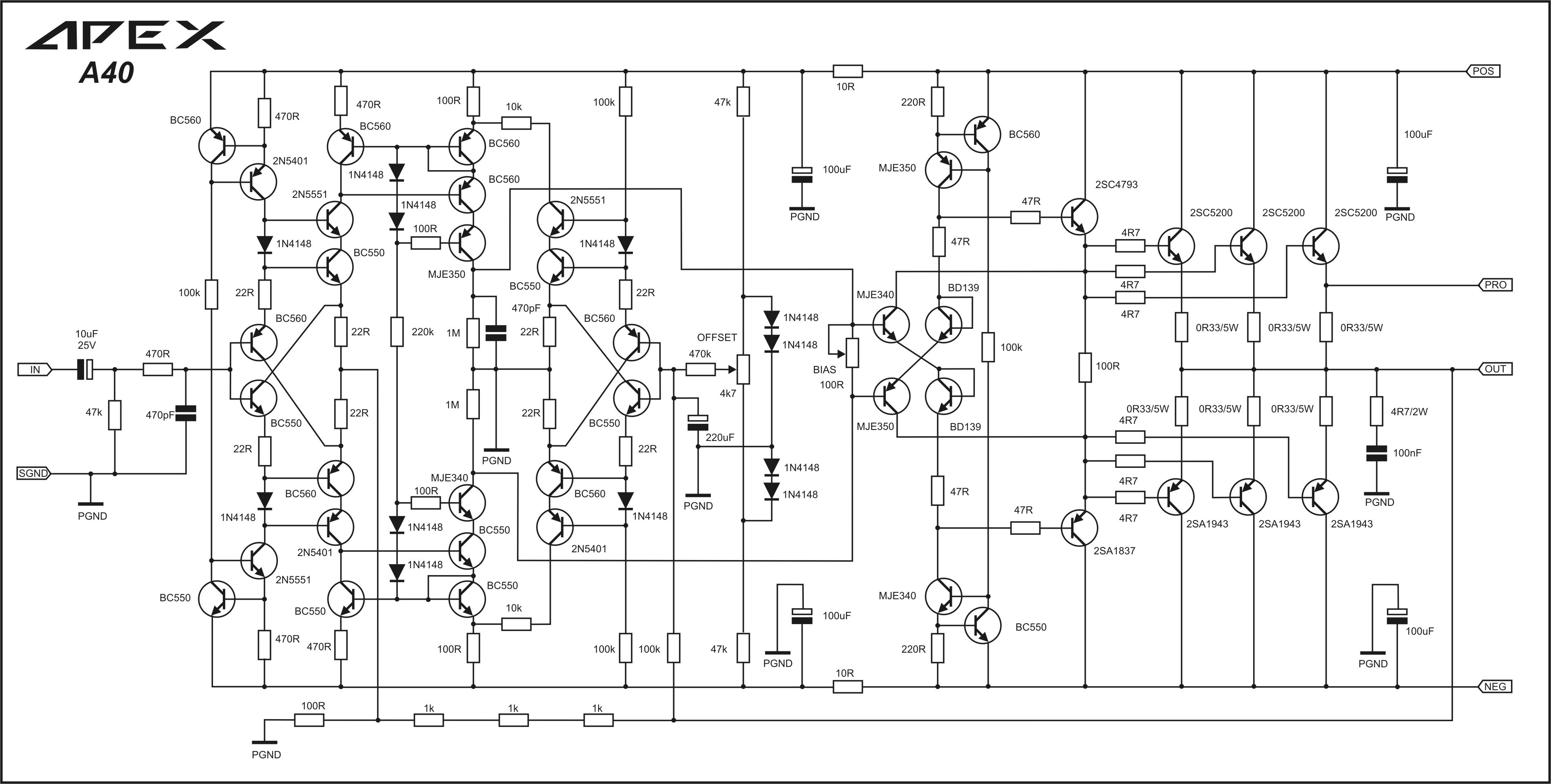

I suggest A40 🙂
Regards
I suggest A40 🙂
Regards
Has anyone done a layout for the A40 yet?
Yess Alex mm of course😉Has anyone done a layout for the A40 yet?
http://www.diyaudio.com/forums/solid-state/164093-100w-ultimate-fidelity-amplifier-415.html
I suggest A40 🙂
Regards
uhmm ... I will check that 🙂 thanks #4145 I can dude that with time of course 😛
Regards
Juan

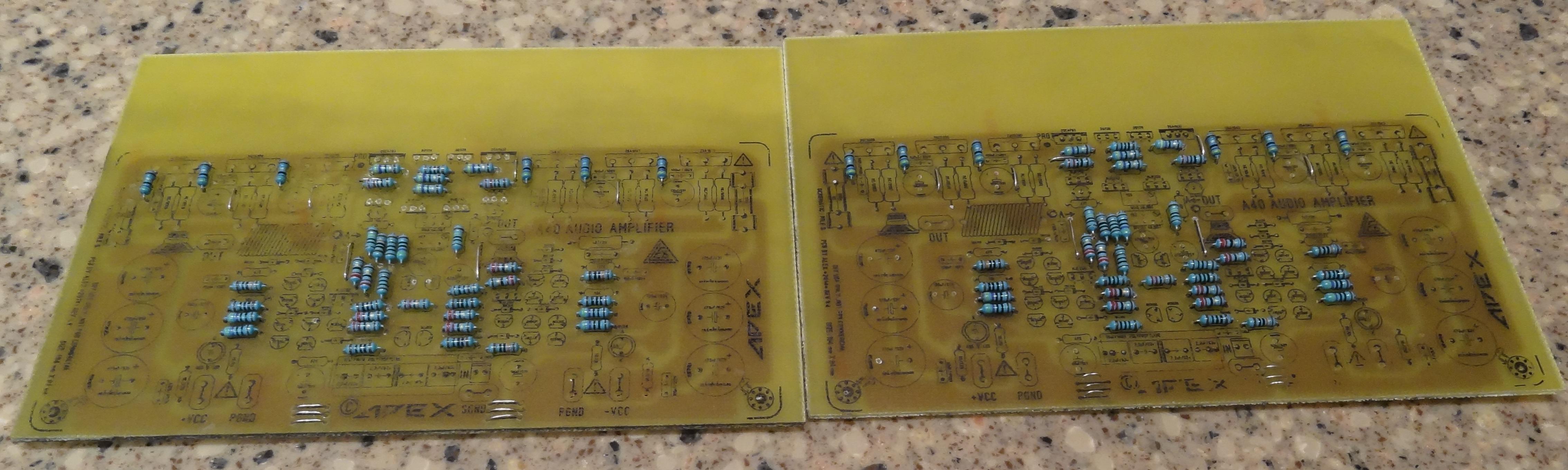

Getting a start on the A40.
Nice pcbs, A14 and A40 use diamond output stage,
