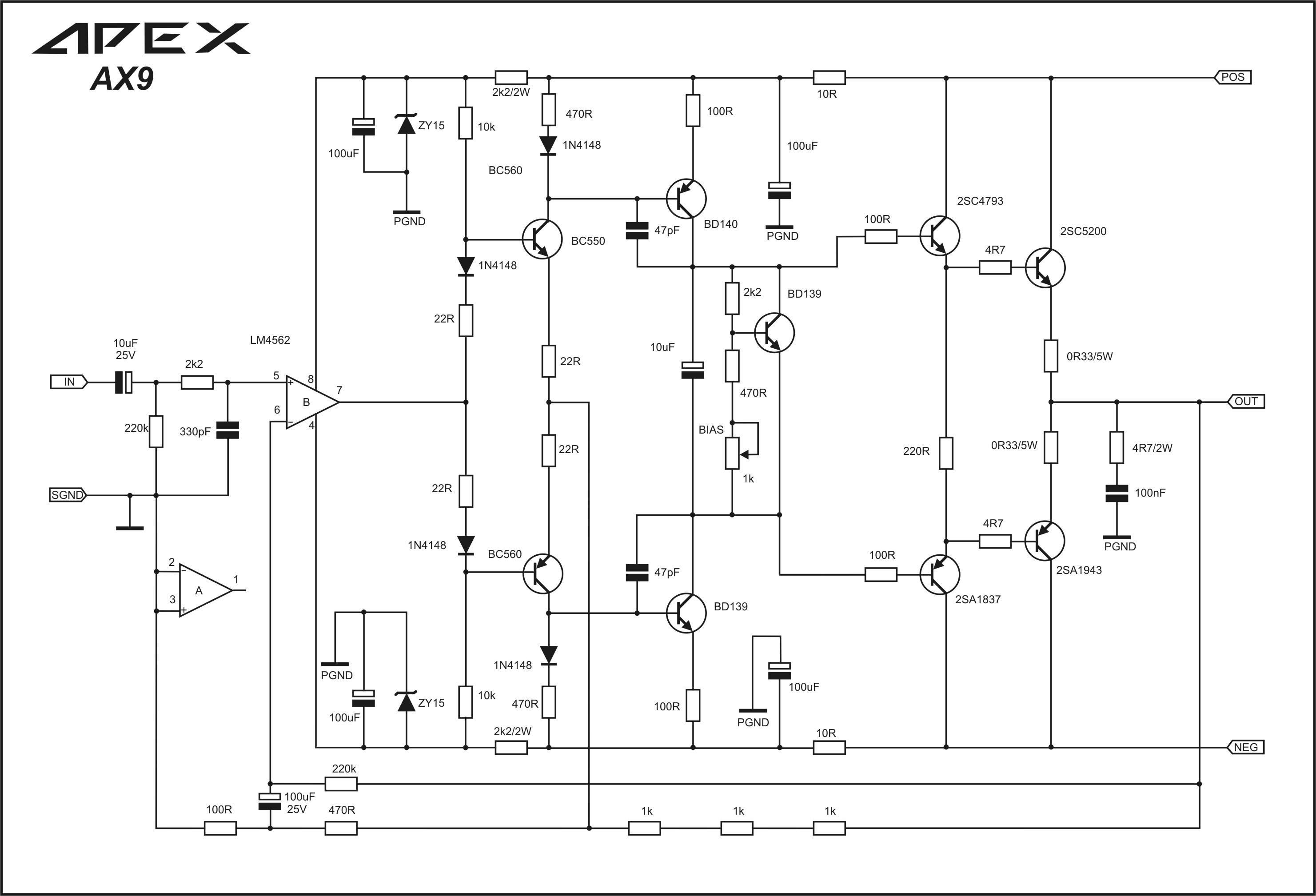

Ok, I tried 68PF, then added a 47pF to that, then 220pF. None of those work. The oscillation is the same. On the scope I am seeing oscillation just before clipping. If I push it into clipping the oscillation goes away. If I lower the rails to about +-28V it doesn't oscillate but that may be because it clips before it gets to the point of oscillation. I tried a few different ICs and still no change. It appears to be affected by voltage because the higher the rail voltage, the worse the oscillation. I suppose it may have to do with the outputs I'm using. As usual, I am open to suggestions.

There is no predrivers on AX9 only VAS and drivers transistor, try with 100pF base to colector on drivers transistor like on predrivers in A33.
Sorry, I meant VAS. I will try adding to the drivers as well and see how that goes.
Thanks, Terry
Thanks, Terry
I don't have circuit for this amp, does driver have base stoppers.
On a EF3 I use 100 R stoppers on pre drivers with good effect
AX9
Tried 47p thru 150p on the drivers B-C still oscillating with rail over +-30. Going to try lowering gain and see it that helps.
EDIT: just lowered the gain and still there. +-30v and no oscillation. +-32v and it oscillates. Strange it is not doing it on Sonal's amp. I wonder if we have anything else different?

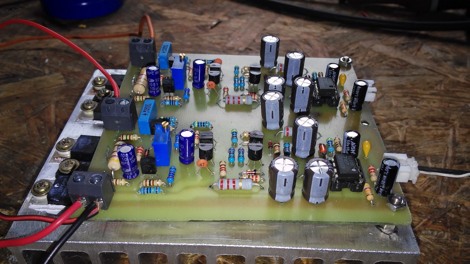

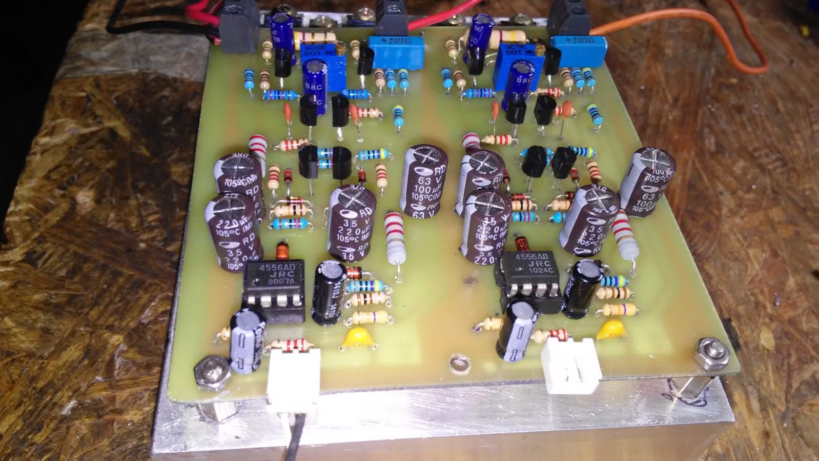

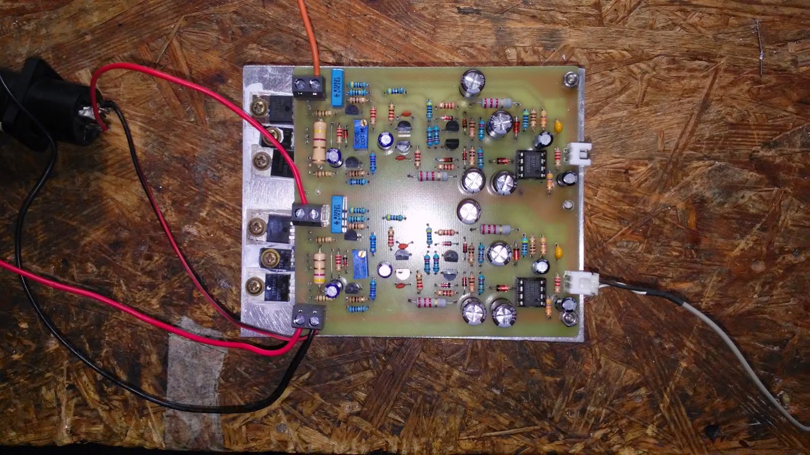

I got it fixed. Sorry for running all around but after all the compensation did not fix the problem I had to take another look at the VAS transistors. I remembered that I had two different brands in there. Fairchild BD139 and NXP BD140. I pulled those and installed Toshiba 2SC3423-Y/2SA1360-Y. No oscillation so I pulled the caps I added to the drivers and put 68Pf back in the VAS and all is good. Running right now on +-37V without issue. Sounds really nice. I did run some square waves through it and they get pretty rounded starting around 10khz. Not the fastest but still very nice to listen to. I hope this helps someone who may face similar issues.
