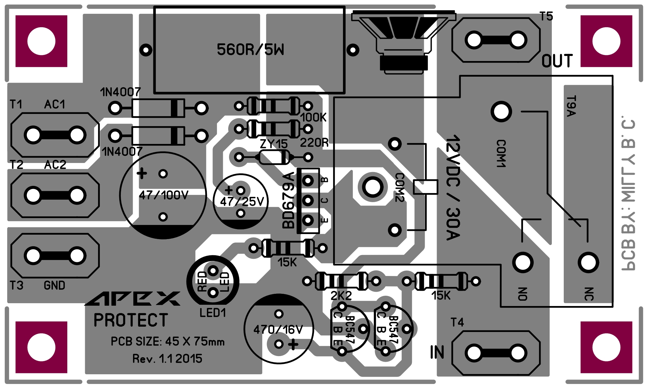

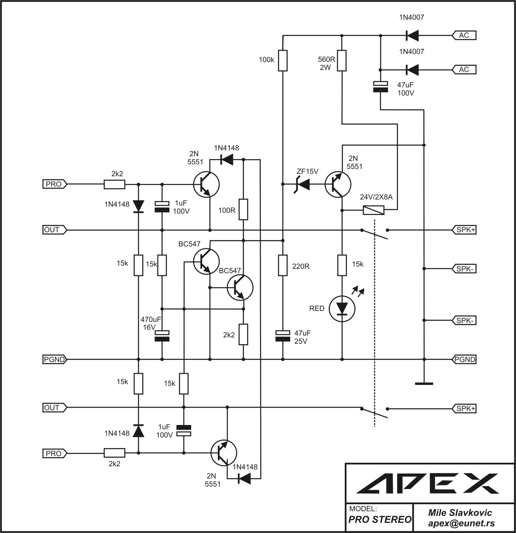

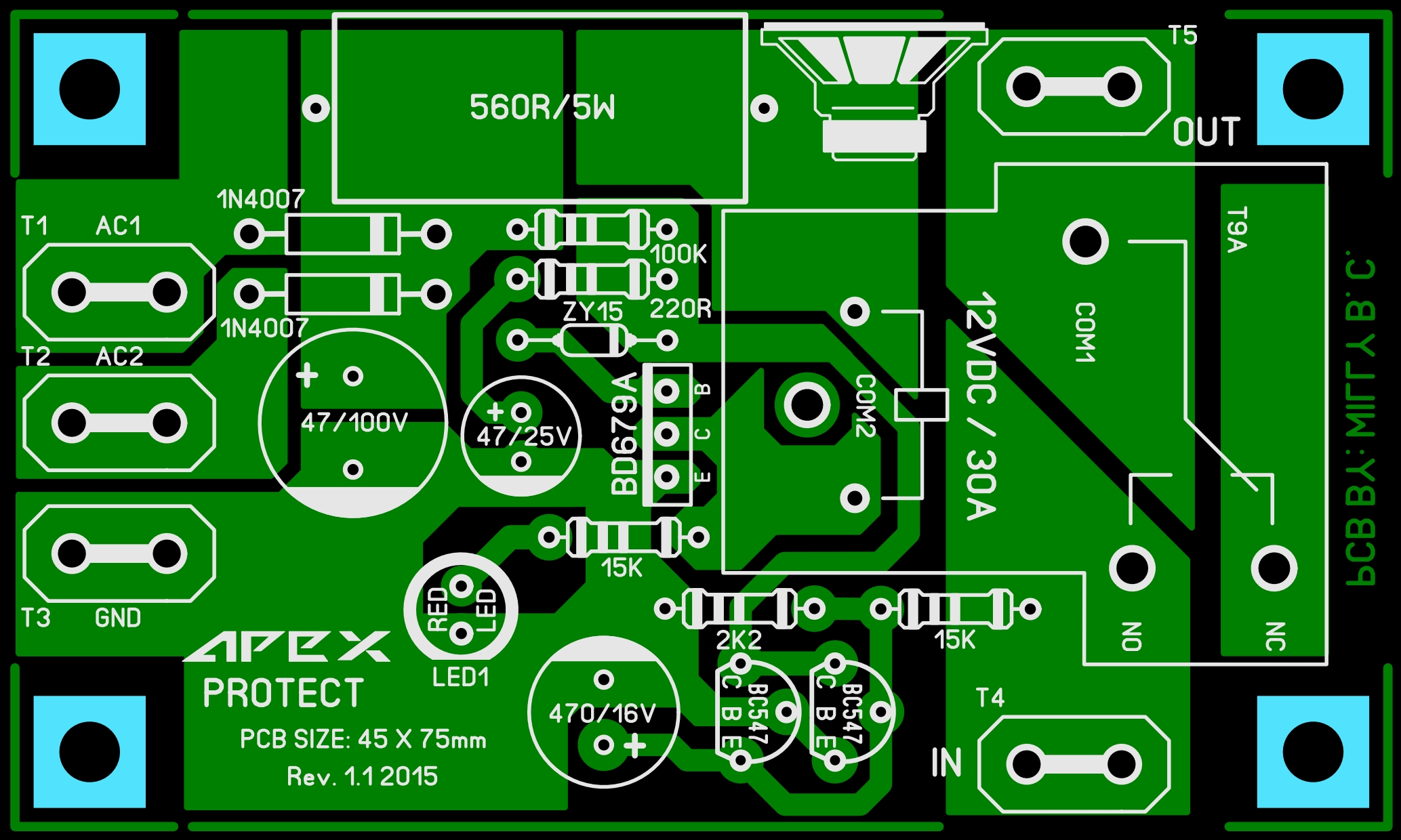

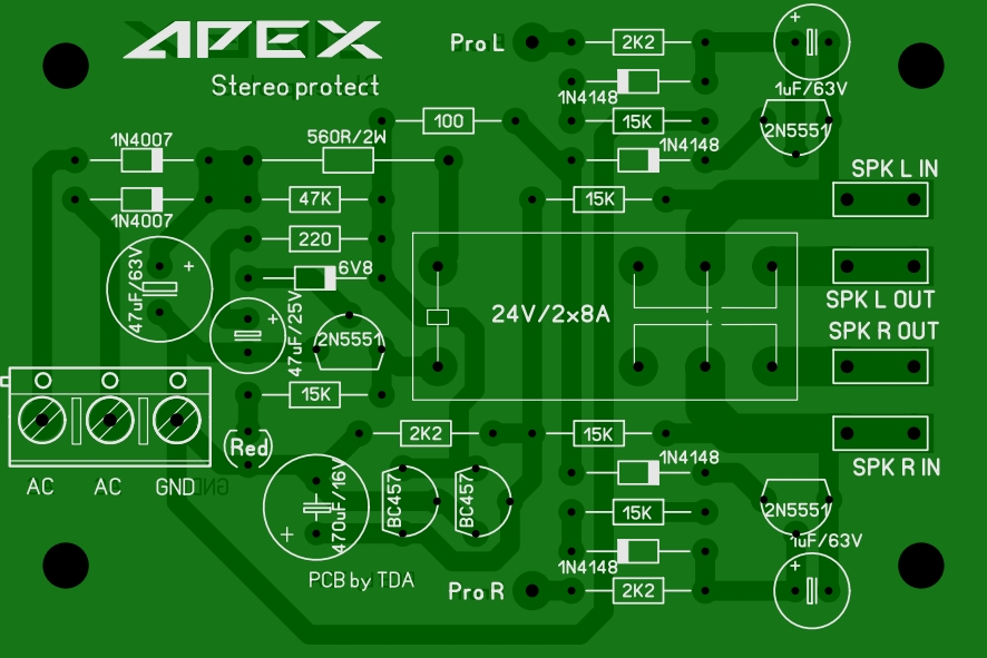

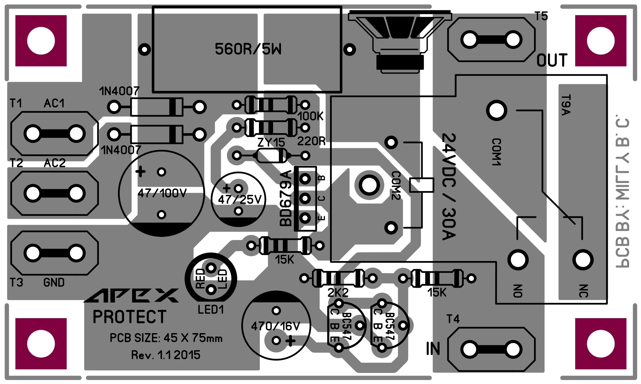

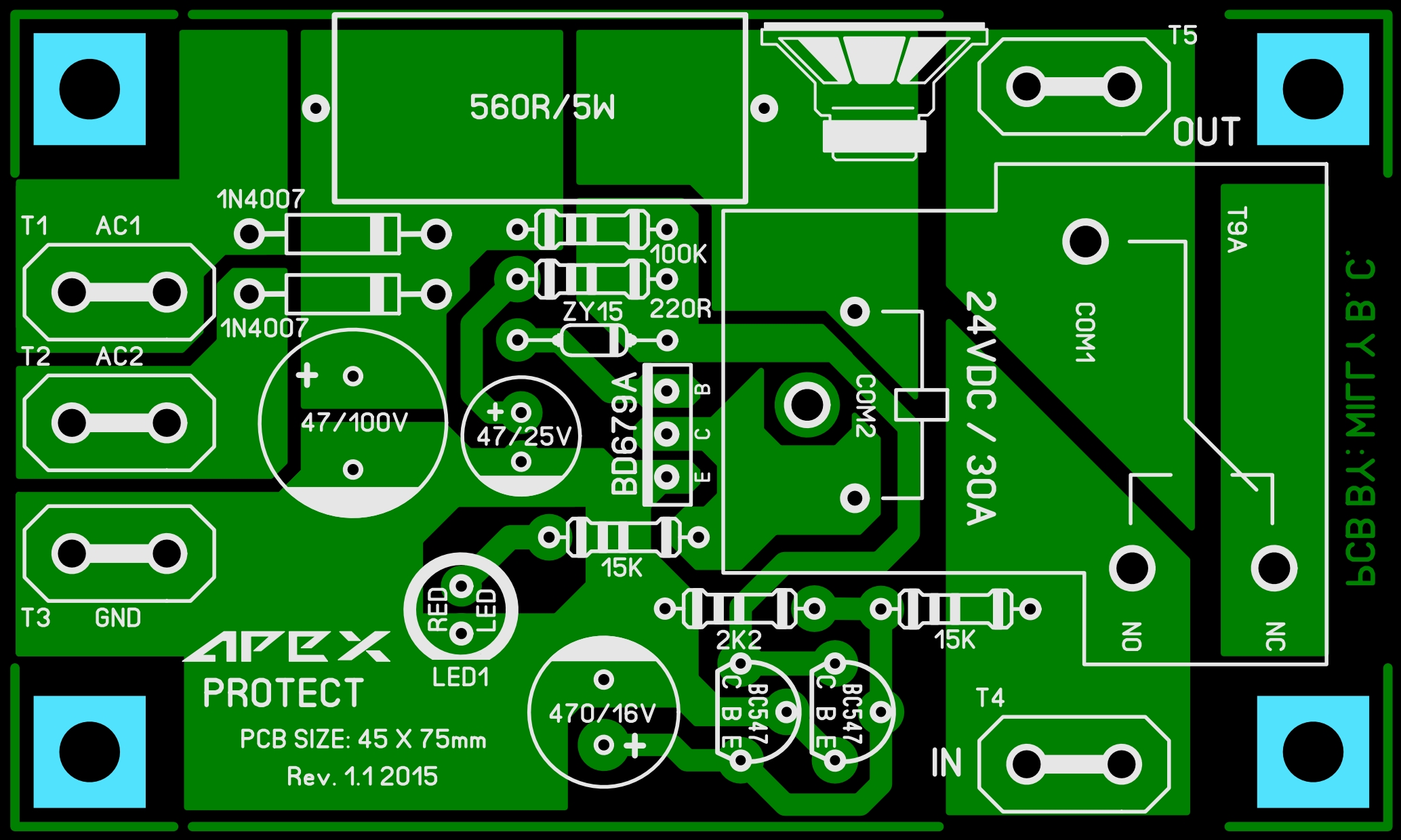

Nice work, use BD679 instead 2N5551 and 5W resistor instead 2W.

Thank you for this pcb design, relay coil must be 24V.

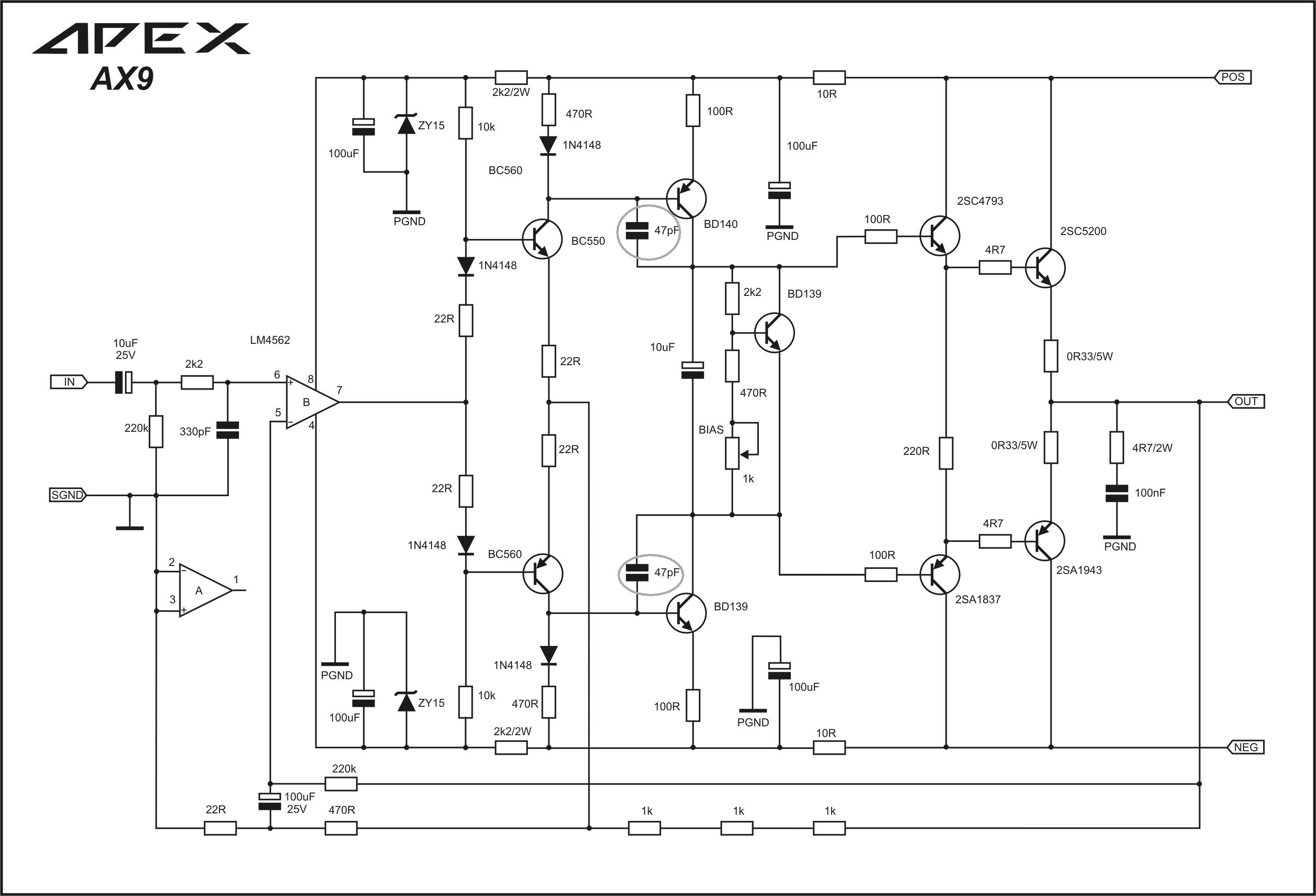

Miles, after listening for few days I like the mids of AX9 better then NX-14 on my PC monitor speaker.
Yesterday I changed opamp to LME49860 AX9 oscillated. I changed 47pF to 100pF amp is stable again, tomorrow I'll check with 56pF, 68pF and 82pF.
Apex A9 didn't oscillated when using LME49860.
I'll like to increase voltage for LME49860 to 22V. Is there need to change the value of 10K resistor.

Use 15k instead 10k with 22V zeners.

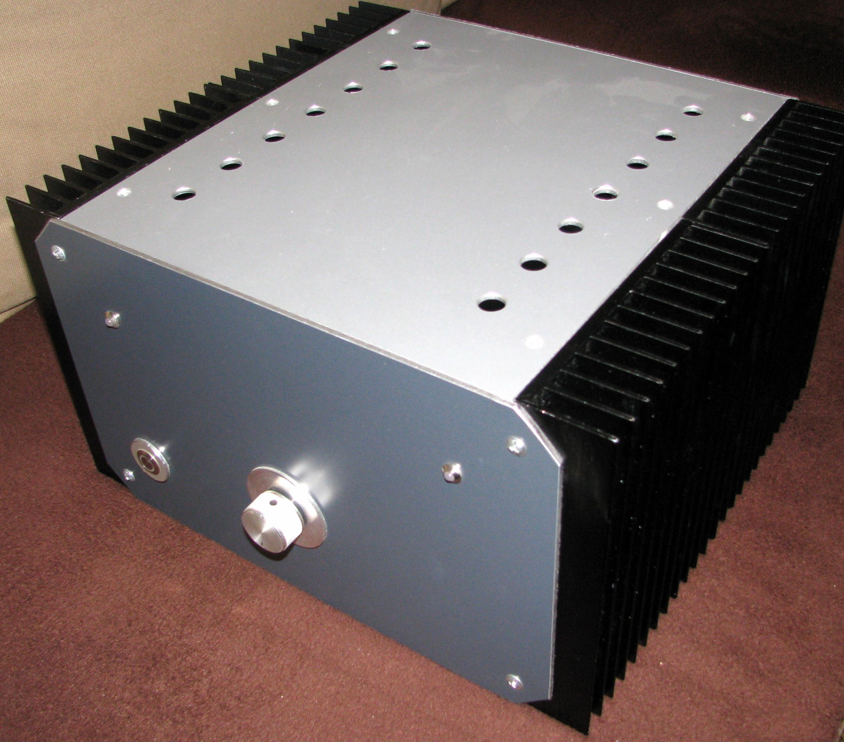

Here's my AX14TP, A big thanks goes to Juan for all the help without which I wouldn't have been able to do it !!
He sent me all the files (Gerbers) required for me to get the PCB done and also all the emails with pics and such, He's really great ! Unlike others who refuse to help when I request them,He was more than happy to help.
Anyways here's the pics of the PCB ( 70 Microns copper and Glass epoxy) :

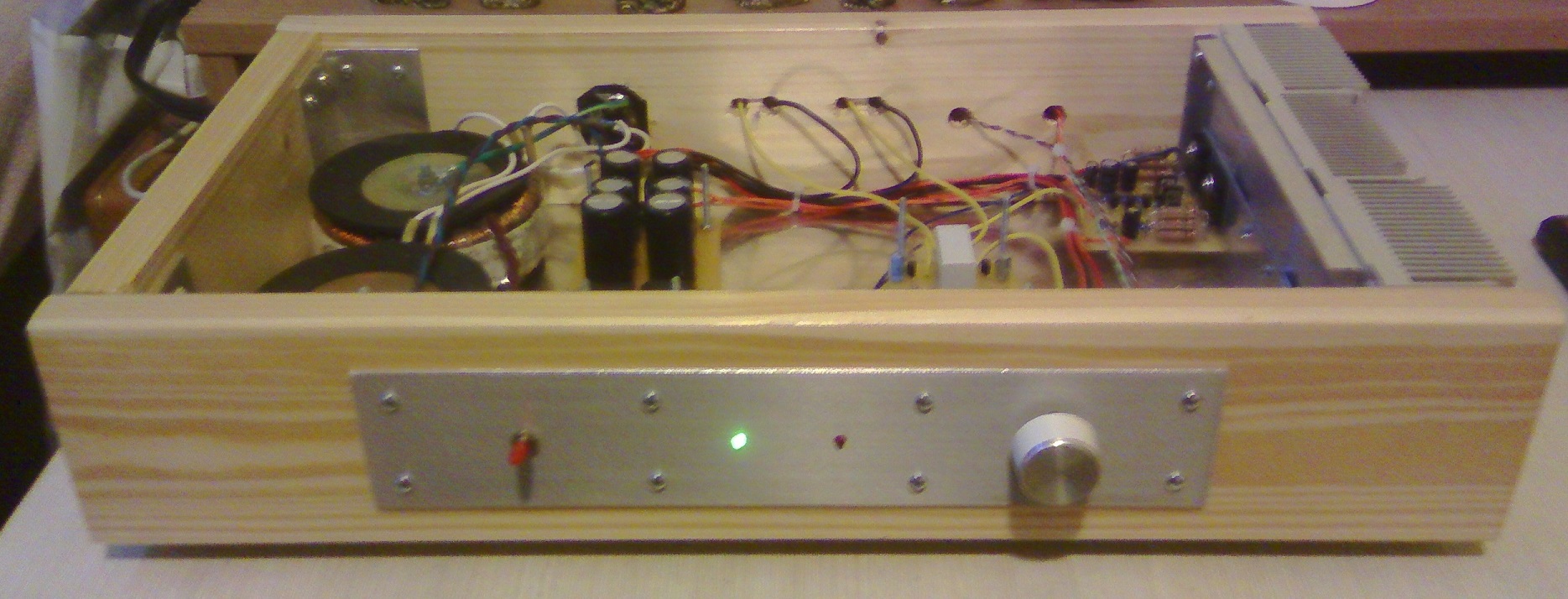

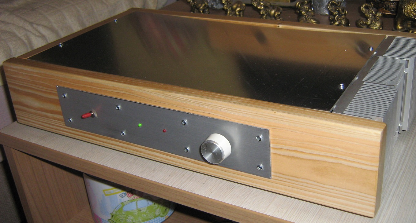

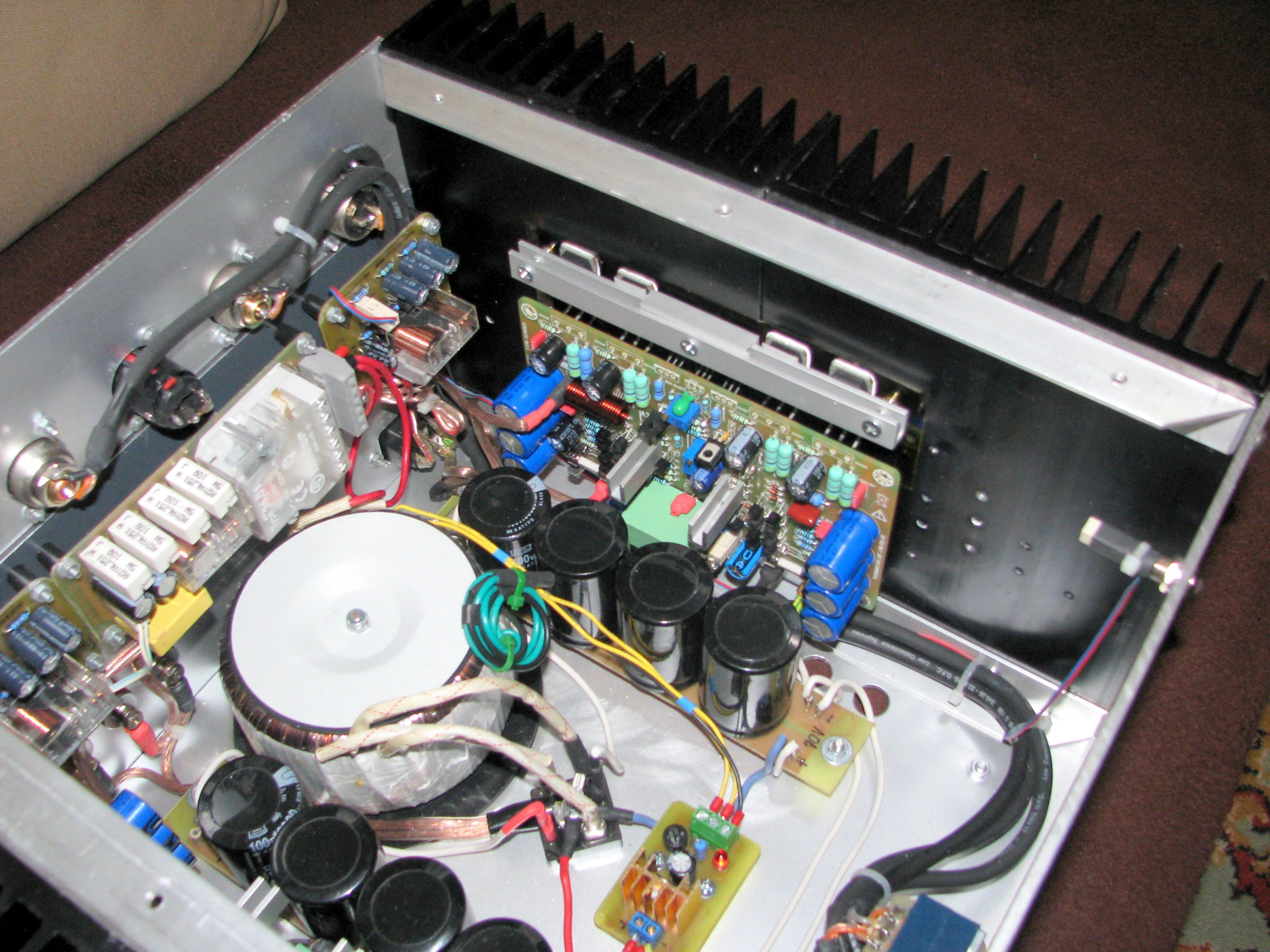

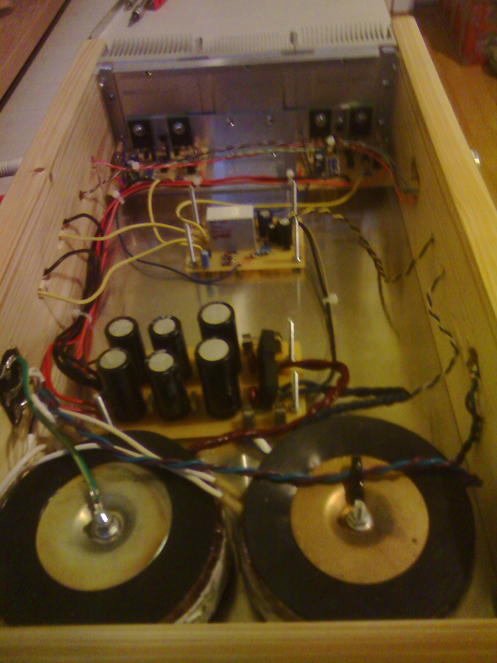

A33 finished
I'm ready with my new A33 amplifier assembled ,soft start,DC protection, and factory PCB .
Sound it's very,very natural I like how it's sound 😀 . Thanks to Mr.Mile S for every amplifier posted on this forum .
Regards,Alex
Regards,Alex
