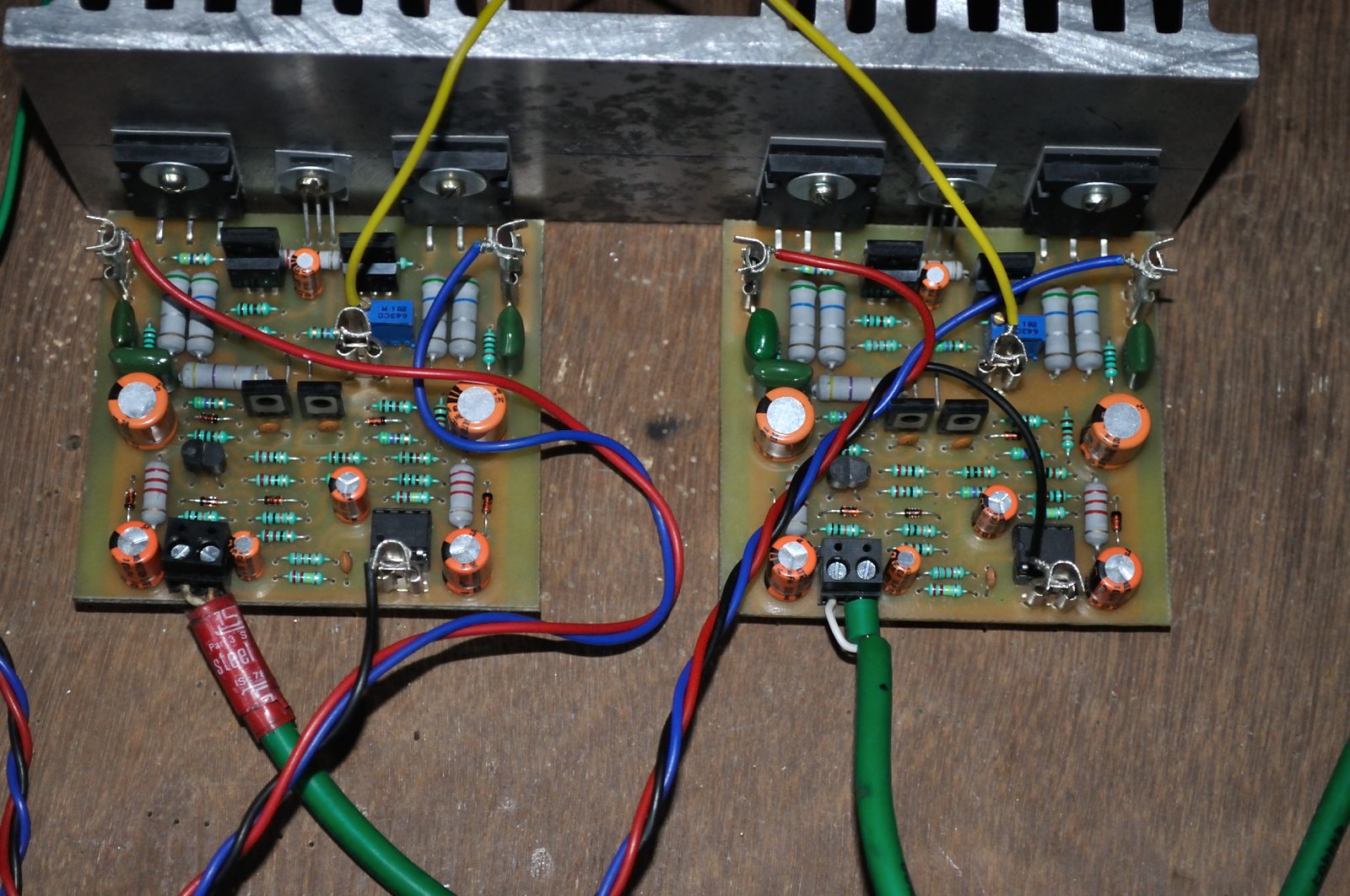

I finished my second A33 amp. Both tested +/-40V, single pair of output transistors.
I'll place them in an old audio amplifier housing.
The sound is very good for my taste.

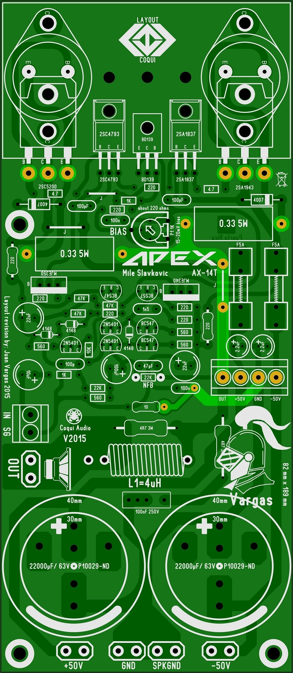

Thanks Mr. Mile for amplifier schematic , Mr.Alex for PCB design
Nice work, can you post picture of housing amplifier?
Regards

Hello guys
I have an idea because I always have the problem where I can place the power supply board on the case, so I place a capacitor bank and RL on the PCB to see how it looks 🙂
those caps are 22,000uF 63V so far I like the idea what you guys think ?
Regards
Juan
Regards
Juan

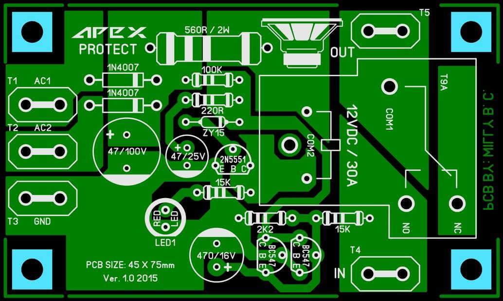

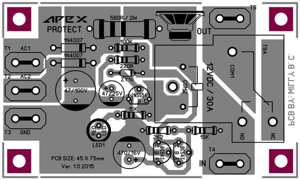

Stereo protect for A17,
Regards
What's the max. AC Supply of this protect.
maybe you should do 2N5551 in Darlinton with BD139 or even better MJE340 to get more hfe and to drive that relay with stronger/more powerfull transistor. usually relay coil uses about 20-40mA but that one can take 100mA,so BD or MJE would be a good choice to drive it...
