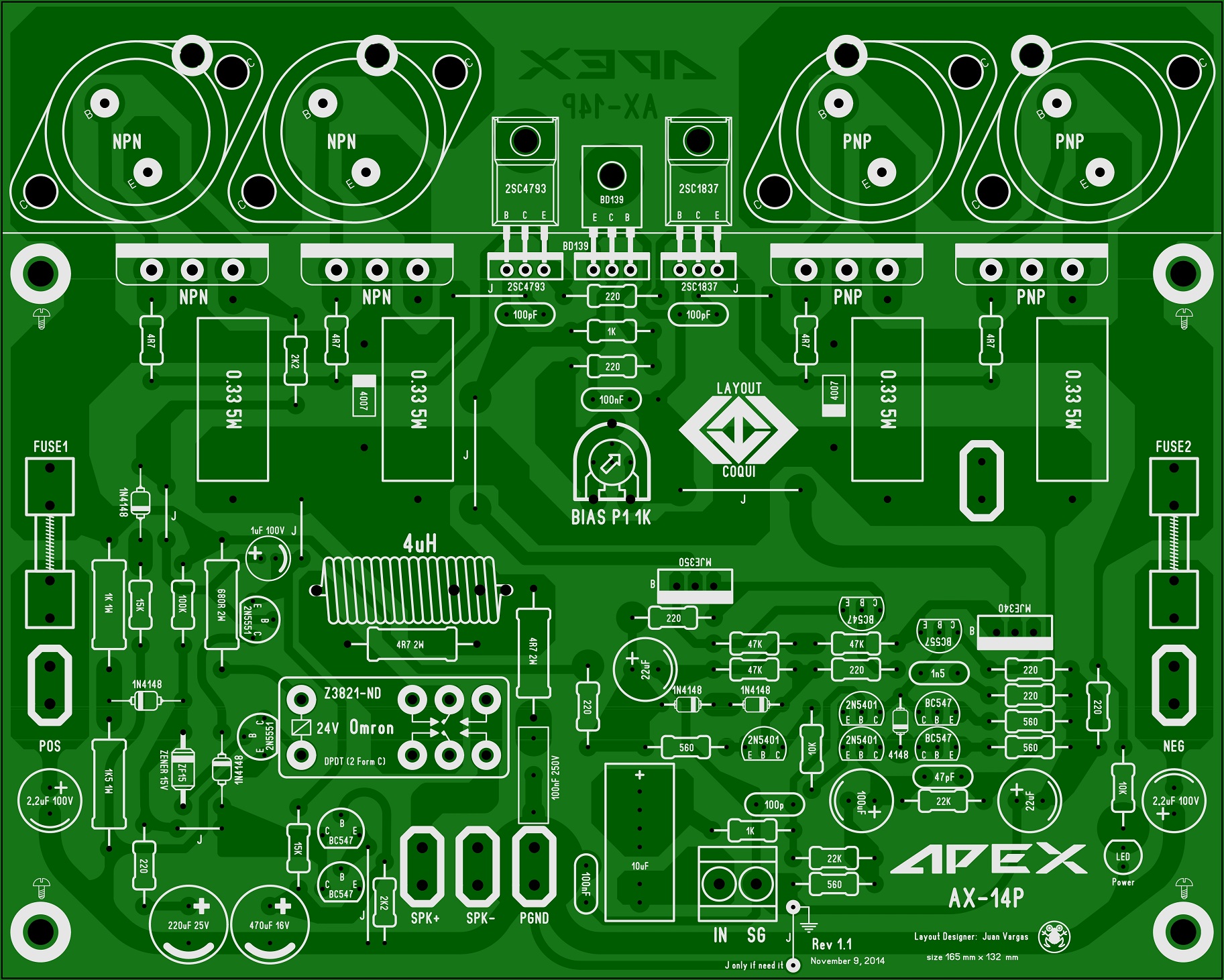

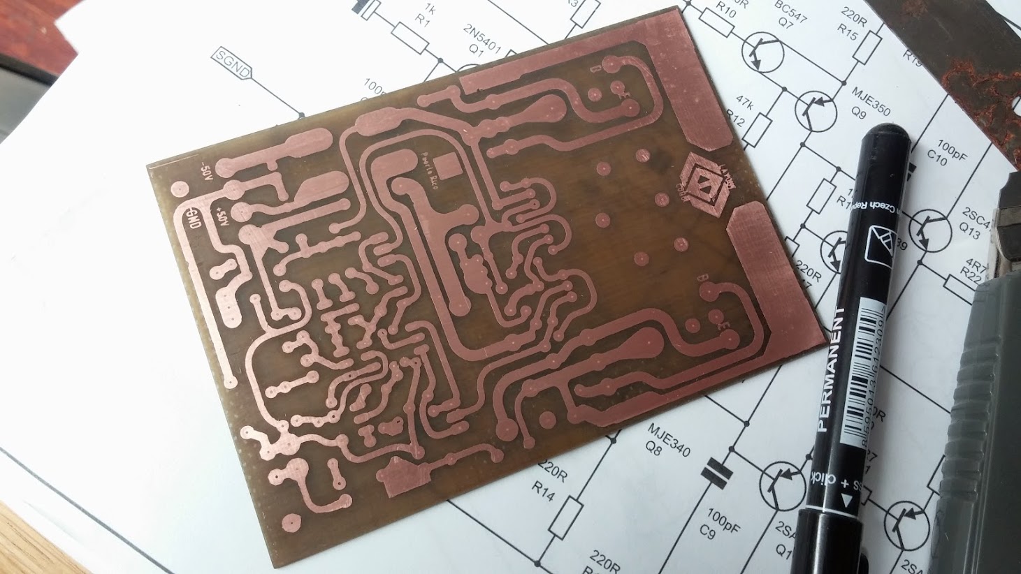

Sir Juan thank you so much for sharing of this file...god loves you always....Hello guys here is the files again I just detailed a bit more and I include here the heat sink guide for the punch the marks for the drilling of the heat sink,
the negative of the speaker connection is there on the board but is better to take it from the power supply GND star, that is just for quick test 😛, I did the simulation with 65V rails and it can give about 300W to a 4 ohms load so I think is plenty of juice for those Jazz drum moments 😀 ok here are the files please is some one see something let me know "we are not perfect" I will appreciate 🙂

the size is about size 165 mm x 132 mm man I think I'm getting old 😀

I wasn't able to get right dimensions 🙂 Pls, can you share bottom view, for both version..thx Marcel
Ok here are both files 🙂

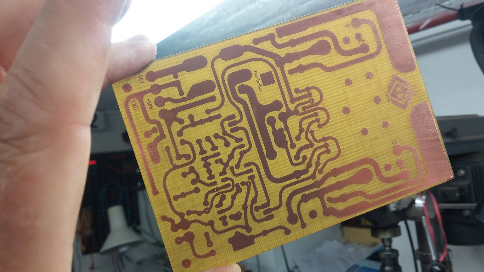

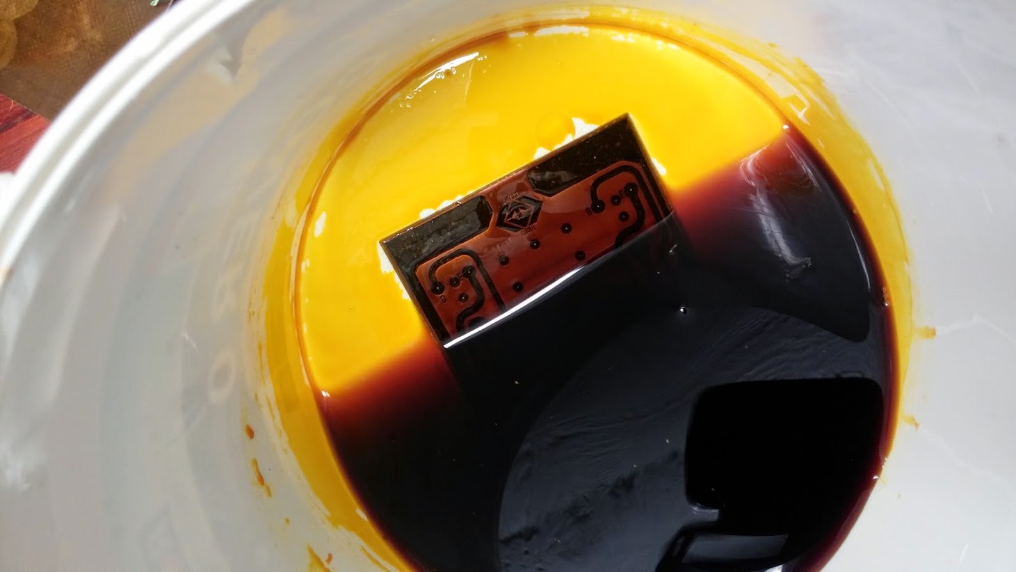

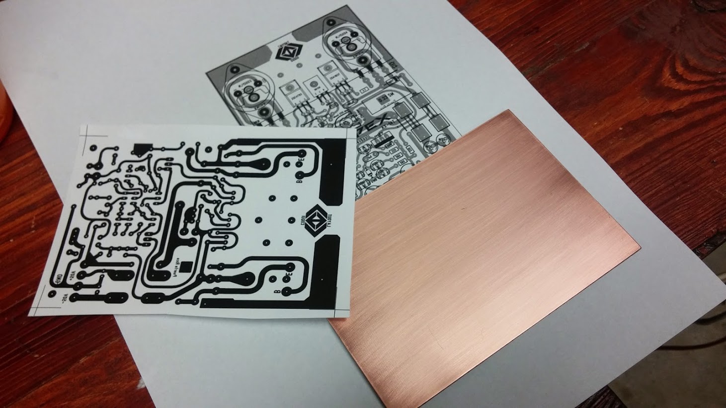

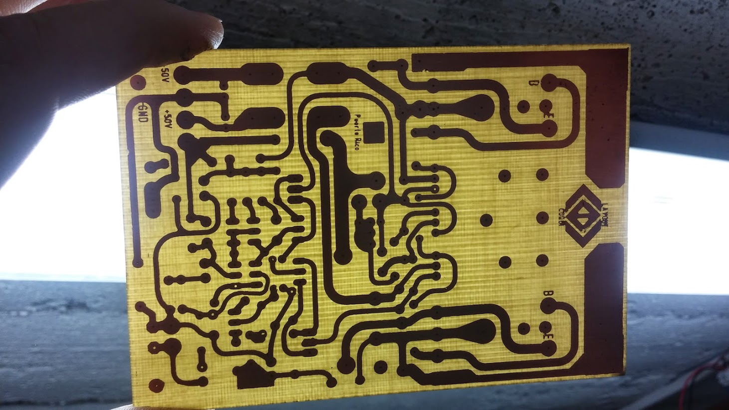

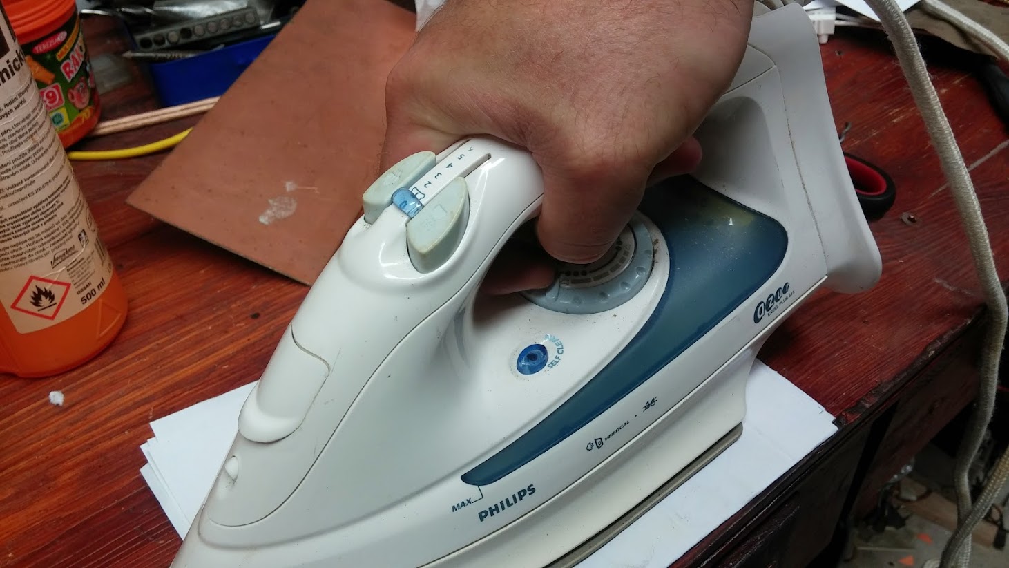

Thank you Juan for PCB sharing.. Today i tried simple method PCB making-toner transfer.... I am very happy with result, isn't so good like photo sensitive method, but still usable...

Very nice!
I wish I could get my toner to stick that well. I always have some things to fill it with a pen.

Inkjet glossy photo paper.. I think better should be glossy laser , but i have inkjet only at home...

thanks man 🙂 I'm not good at etching but I will keep trying 😀
