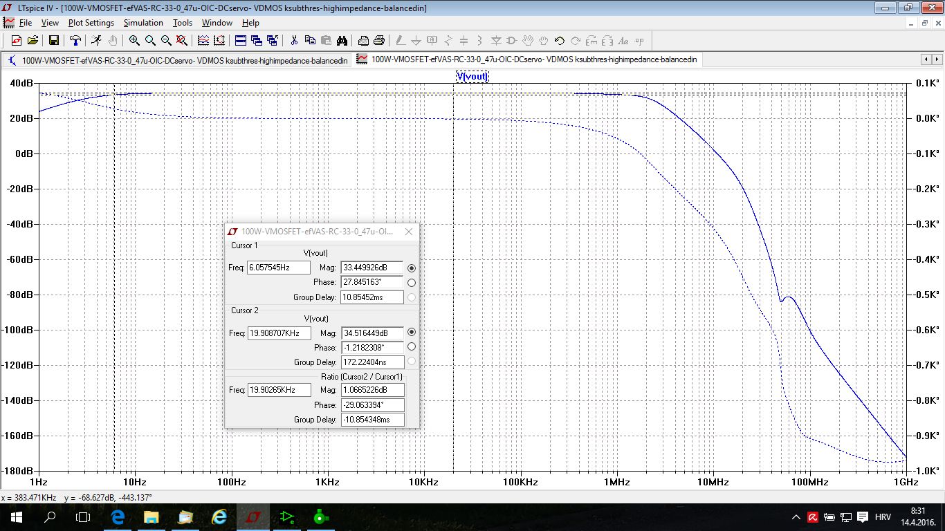

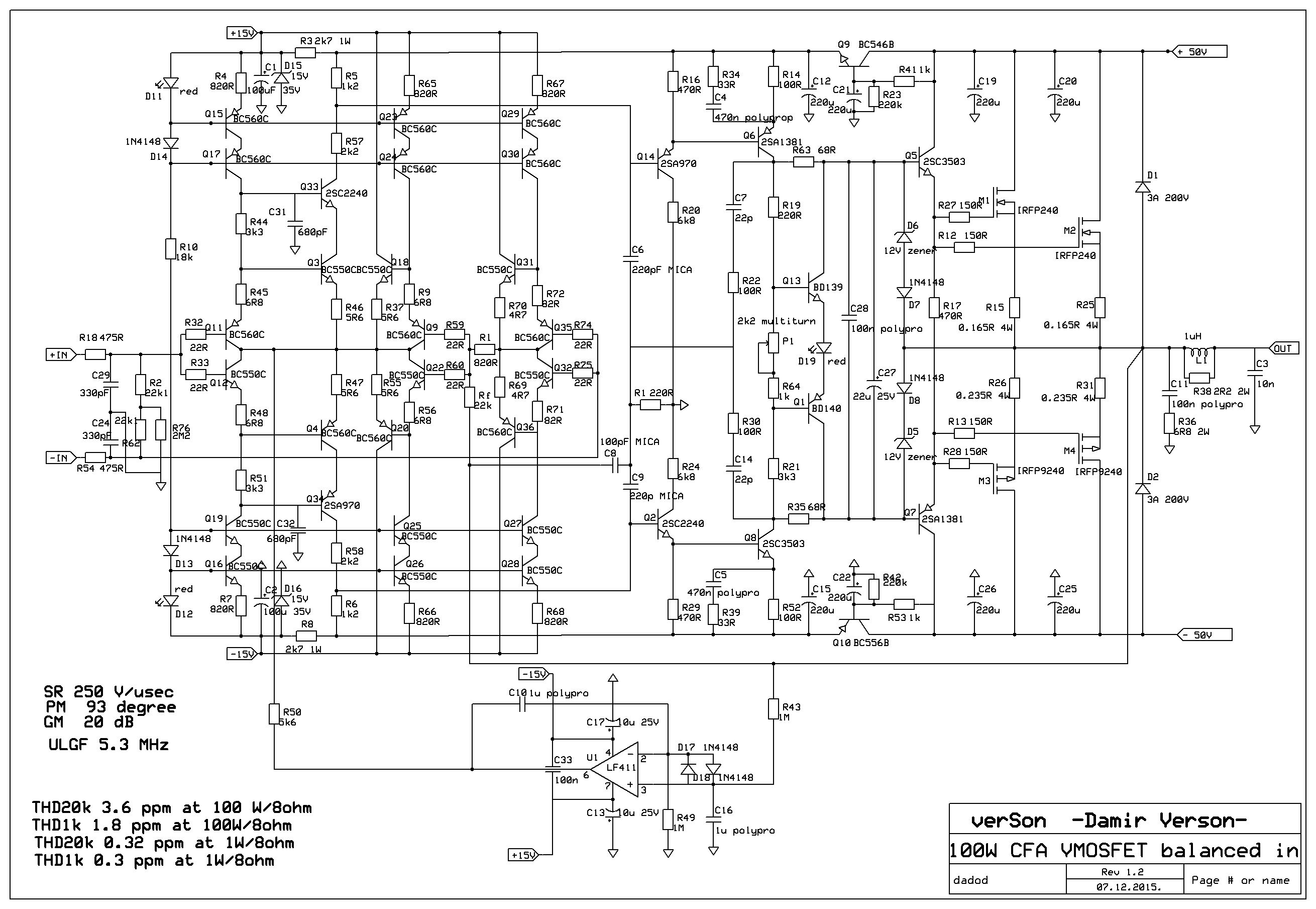

This amp is an evolution based on similar 100W CFA with unbalanced input only. It is possible to add an input balanced to unbalanced converter, but why not use the same electronic configuration to get it. CFA has very low impedance minus input not suitable to be used as balanced cold input. I used additional buffers to get high impedance cold input and in the same time to preserve CFA characteristic. I never saw something similar, but I could be wrong. By adding those buffers distortion did not increase.
To high CMRR, what is characteristic of balanced drive, it's very important to have very close hot and cold inputs impedances and there should be used 0.1% tolerance resistors.

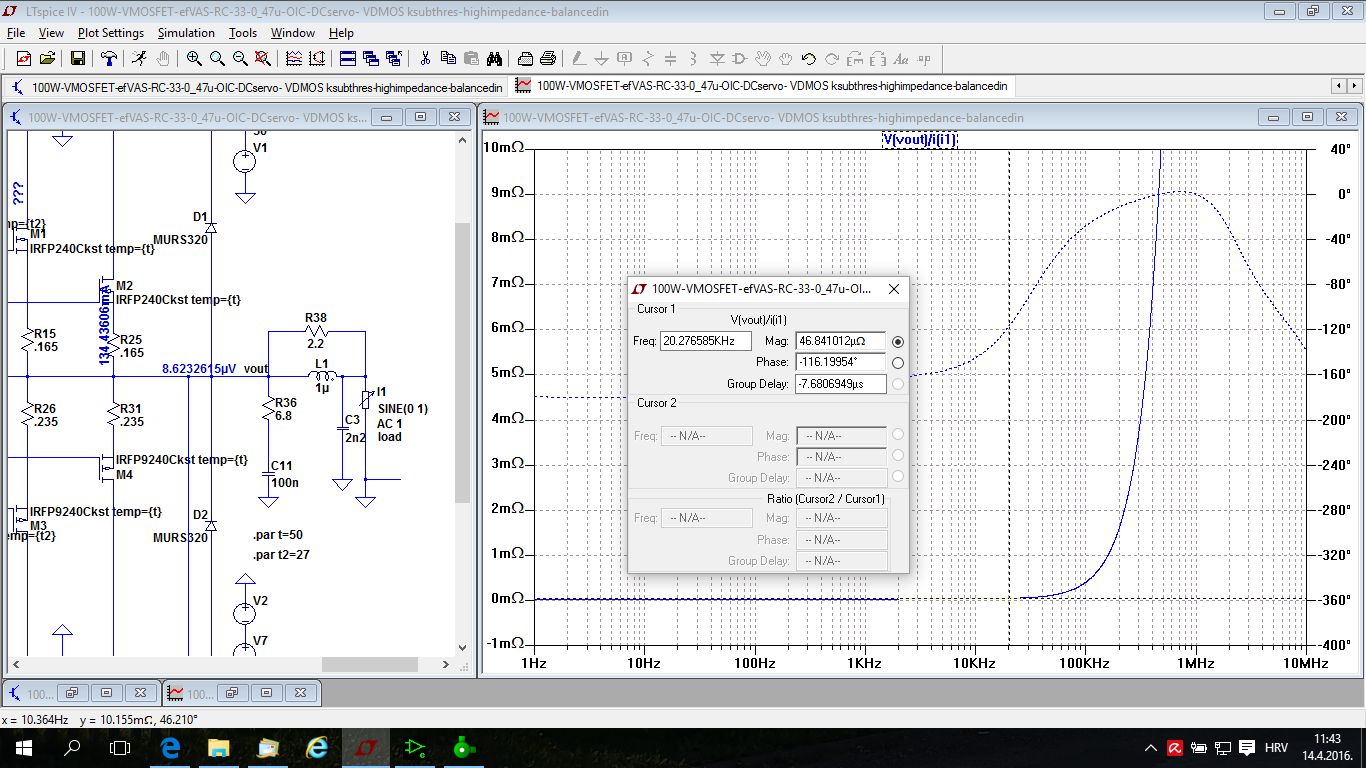

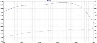

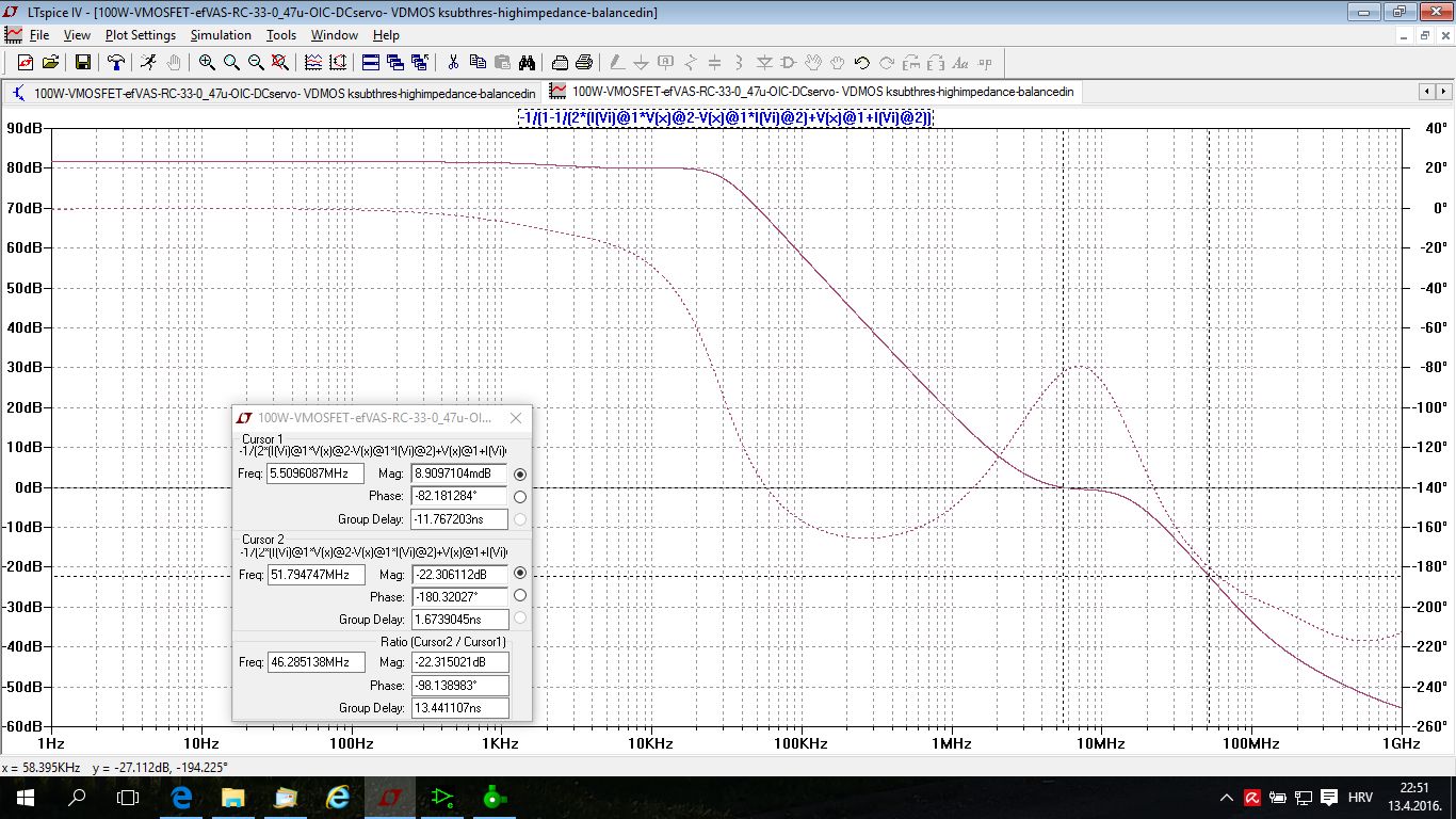

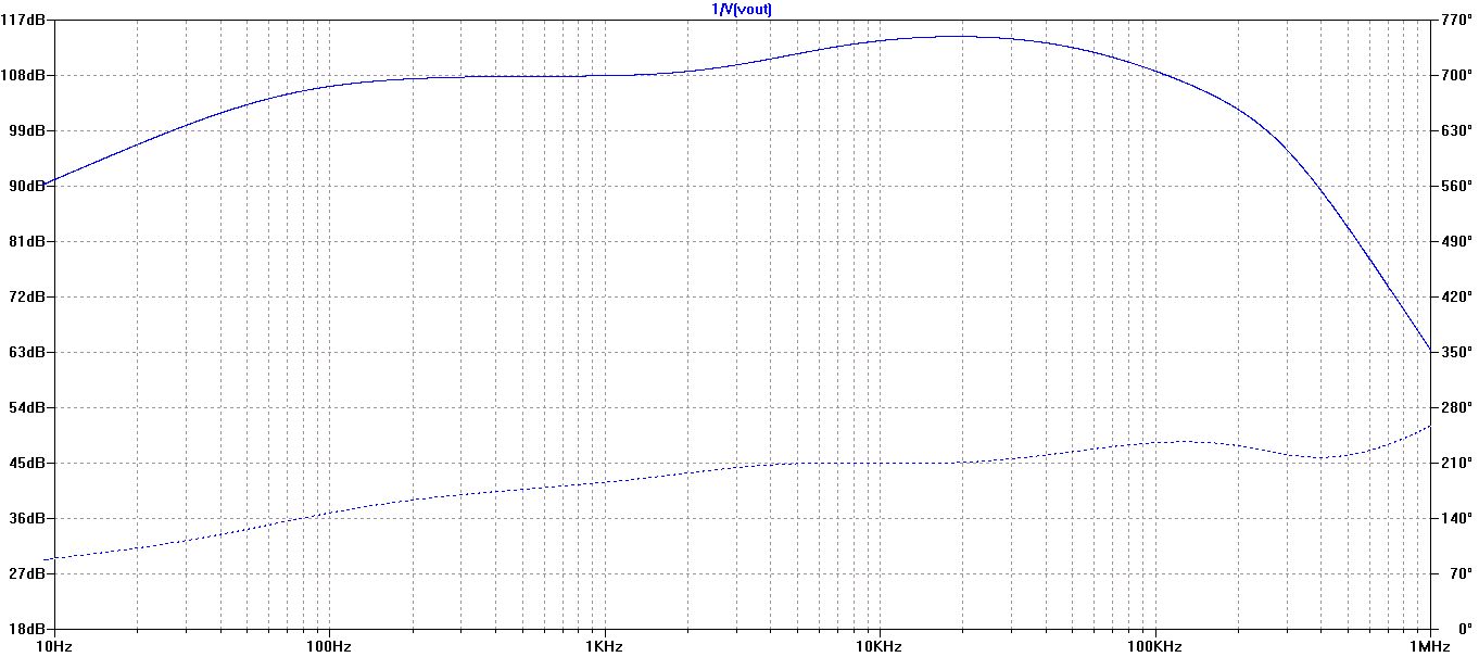

Here is the schematic, the Loop Gain and Close Loop Gain (balance drive) plots.

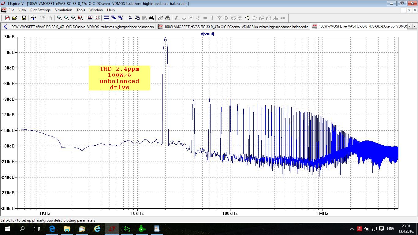

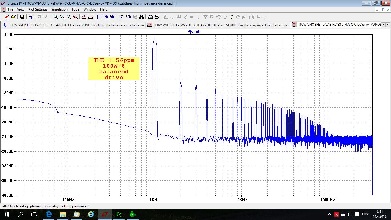

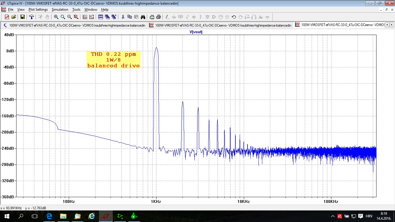

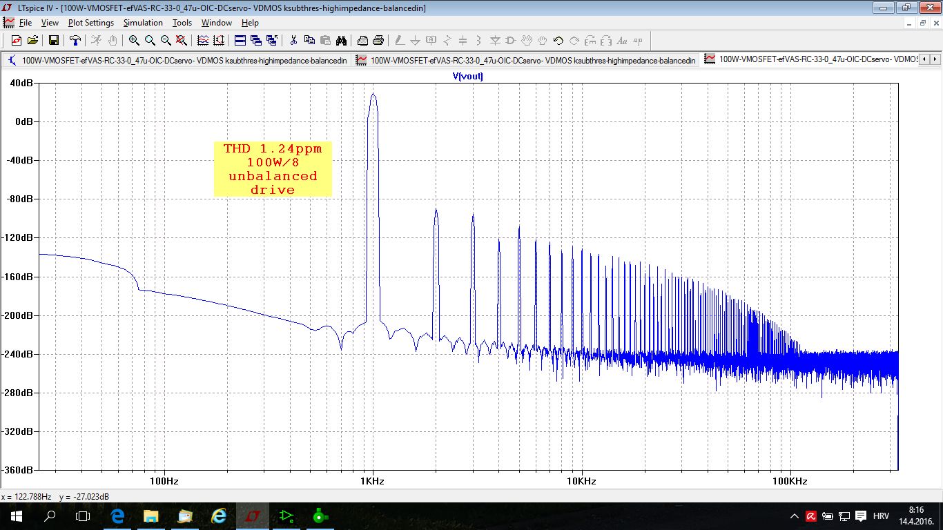

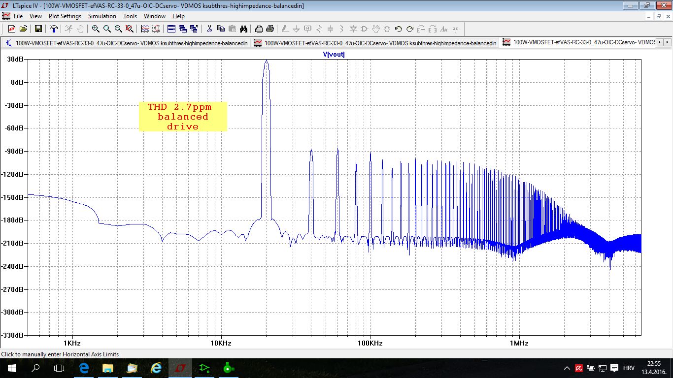

Some more plots.
100W CFA MOSFET -1-2-balancedin-FFT1k-1W-balanced-drive.jpg181.8 KB · Views: 652
100W CFA MOSFET -1-2-balancedin-FFT20k-1W-balanced-drive.jpg181 KB · Views: 631
100W CFA MOSFET -1-2-balancedin-FFT20k-100W-balanced-drive.jpg191.9 KB · Views: 231
100W CFA MOSFET -1-2-balancedin-FFT1k-100W-balanced-drive.jpg191.5 KB · Views: 235
It is quite easy to use this amp with unbalanced input, just connect cold input (or hot input for inverting work) to the ground.
Here are FFT plots.
Here are FFT plots.

Not that I want to ruin your fun, but it's actually not current feedback, to become that you need to remove Q9, Q18, Q20 & Q22.
My experience is that the cascode of the input circuit current sources are not really needed with the low input voltage swing and heavy feedback.
See also the circuit of t.ex. the LT1364....
For lower noise you might also consider the BC327-40 / BC337-40 or the 2SA970 / 2SC2240 you're already using, in combination with lowering the feedback resistance....

Don't worry, anyhow CFA and VFA are not the best way to describe amp topology, but I don't want to go into that discussion again.
I've have make similar configuration as in LT1364 or LT1363 op amp in my other design, look here http://www.diyaudio.com/forums/solid-state/253039-unique-cfa-120-230w-amp-16.html#post4428619 and I saw similar op amp (bastard CFA/VFA) later, just some idea came to me without knowing that everything was done before.
The cascode lower THD considerable and permit to use complementary transistors BC550/560 for the input super pairs. I don't see why BC327-40/337-40 would be better suited for that job with higher Cob and not low noise types.
I tried different feedback resistance, and chose this as a compromise. You can notice that lower resistor(R73) is not connected to the ground but to the buffer output, and output impedance influences the feedback ratio. With to low feedback resistors this influence is to high.

How's the PSRR?
PSRR!

In the schematic diagram of the first post, as drawn; is Q36 correct?

PSRR!
Was any output load connected for this plot? Also was there any signal present? I've found both make a difference to the result, though having an output load makes almost no difference at all with no signal present.
You have very sharp eye, of course it is up side down. In the simulation, schematic was correct, of course.
Here is corrected schematic.
Output load was connected, 8 ohm, but the input signal level and the load do not influence LTspice PSRR simulation.

I'm not talking about the cascade on the output of the input circuit, but the cascade on the current sources, Q17,Q24,Q30,Q19,Q25 & Q27, those are not really needed....
You might want to read the interesting thread here on low noise transistors, in transistors, noise is mostly related to Rbb, and the BC327/BC337 are driver transistors with low Rbb and therefore with significant lower noise than the BC550/BC560, although they're not specified as low noise.
Or get the 3rd edition of "The Art of Electronics", very interesting chapter on transistor noise....
A lot of designers ignore noise in power amplifier, I like sensitive speakers so noise matters to me.... With very few changes you could improve noise level significant, but hey, it's your design....

Could you support that claim with some data about noise superiority of the BC327/337 over BC550/560. For sure thy are inferior in Cob for about 5 times.
Regarding those, according to you redundant transistors, together with diodes are current mirror and improve temperature stability of the CCS.

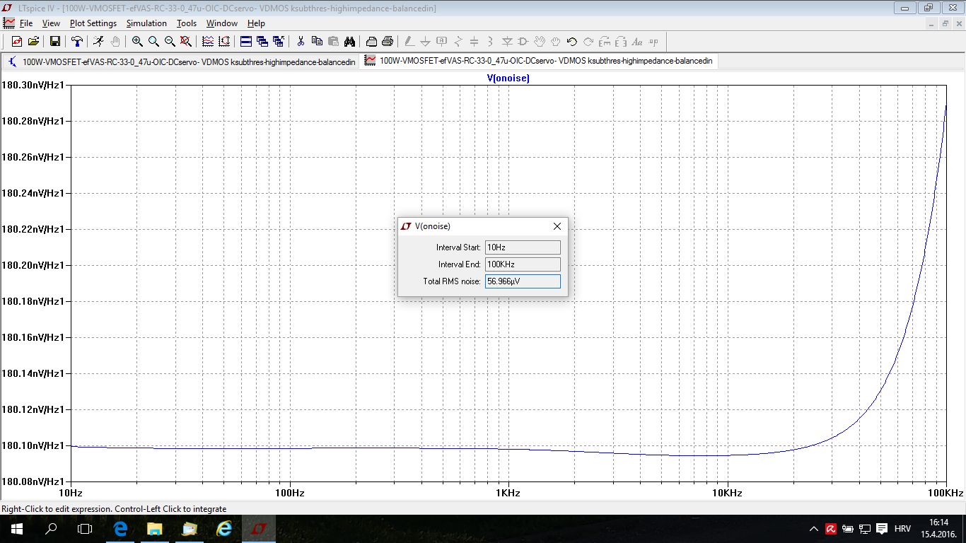

Here is noise simulation of the amp.
With 20 mW over them ? The current source transistors temperature coefficent is about the opposite of the LED reference anyway....
And btw, don't trust noise simulation, most models don't have correct Rbb so they model badly....
