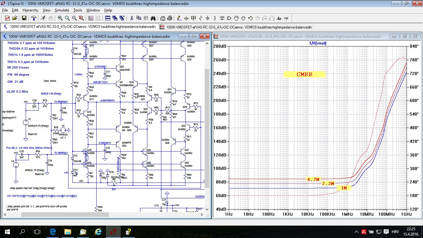

I plan to make SMT layout in near future, so if you have a list of recommended transistors, specially those for higher voltage and VAS I would appreciate it.
I used Cordells models for my simulation, but not sure how correct are rbb.

C29 (C23?) & C24 take interference currents into the audio ground. That will probably have an effect on amplifier performance.
Instead move these RF attenuating capacitors so that they take interference directly into the Chassis.
