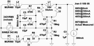

Results of winging it without a schematic, then drawing it later...
I was trying (and succeded I think) to limit the inrush, widen the
conduction angle, block voltage doubler DC imbalance, and stop
LC circuit ringing.
Wanted to use this rediculous 10H choke I bought on impulse
without any plan. Didn't realise then that simple CLC with this
monster would ring at low frequency. So come up with this
bizarre scheme: I would put big C in the middle of the big L.
Anyways, it works, but 600ESR is obscene. Probably useless
now anything but guitar. Did I mention, at least it won't ring?
These measurements with only the 242V secondary wired.
Not yet loaded with any filaments or fixed bias. It might drop
further by the time those other loads get wired.
Also 3A fuse on the primary. I earth grounded to the copper
strap of the beast, took a propane torch to melt solder to it!
The motor runs limit and equalize how much current is drawn
per phase. They aren't for conventional storage or filter...
The diodes are 1000PIV 3A fast recovery, not MUR460.
Thats just closest diode LTSpice had to offer.
L2 & L3 don't appear to do anything significant. But they are
there, and hard to remove now. I can short across them if I
need the extra Volt or whatever. They were for power factor
correction before I got the idea to use the motor runs...

I measure 667 volts no load, so 600 sounds realistic. Same CXPP 5K/100W OPT,
plus 10H Hammond! All three lumps about the same heft. On a giant slab of wood
1.5in thick. Ugly, ugly, ugly, and not an easy lift... Lots of exposed voltages. My
6L6 are in relay sockets that threaten to melt. Its only a breadboard for tests.
