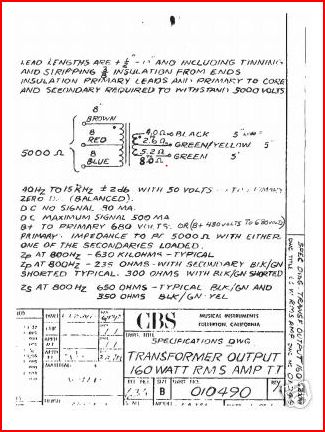

Here's the OPT #010490 for that Fender amp:
Fender OPT on ebay

That OPT is near identical physical size to the 10 pound power tranny in this thread.
I have a pair of those monsters. The measure out at 7k P-P for an 8 ohm load, so they will take 700-800v of B+ to deliver the stated power rating. They're big enough for the job, though, and somewhat better looking than your average Hammond monster (if you like black, that is).The power transformers, however, got a thorough whippin' with the ugly stick....
The datasheet says 5K primary impedance. Is it the same transformer?
The Fender amp that used this OPT had 700V B+ and was rated at 160W Po with only a pair of 6550s
If you closely peruse the data sheet, it's rather elastic as to output impedance. If you load with one impedance inside the range specified you can get 5k. If you load with 8 ohms, you get 8k. I tested the turns ratio, which is the real determiner of impedance.
Sure enough. The amp schematic shows 2.6 ohms speaker load connected to the shorter winding. Maybe someone marked up the datasheet with the conflicting impedance numbers... How does the frequency response of these measure?
