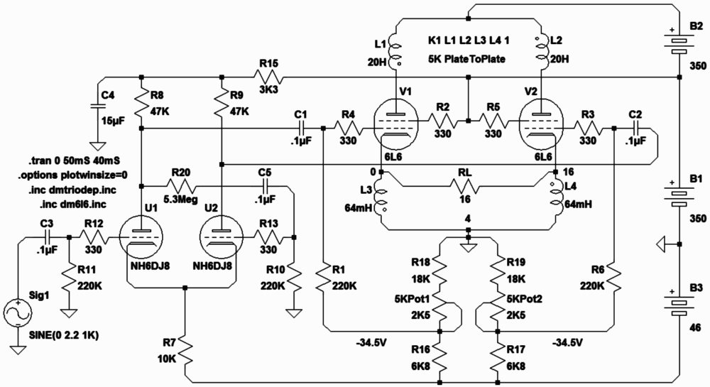

Assuming I copy the CBS/ADA power supply, is the rest of this optimal?
My load would most likely be an Eminence Wizard 16ohm. Input handled
by stomp box, so's hopefully no need for actual "knobs".
I am concerned mainly that somewhere I've been too conservative?
Most peeps squeeze more than 50W from a pair of 6L6 with a 5k opt,
or am I mistaken? Or is that sort of power only unlocked with AB2?
Or they are counting the full area under a square wave, not sine?
Why did CBS/ADA seem to think 130W was the magic number?
I don't have that OPT, so its maybe not apples to apples...
