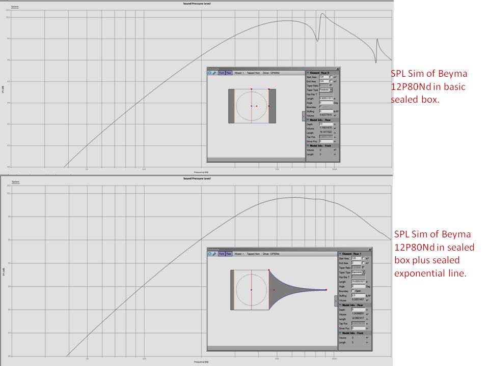

A transmission line simulator will allow you to explore a few different internal volume shapes, like a rear taper, which can remove resonances effecting a wide bandwidth midbass. Most TL simulators will also allow you to model different absorption material density and location. Someone on diyAudio has a backup of the Leonard Audio software which you can download.
