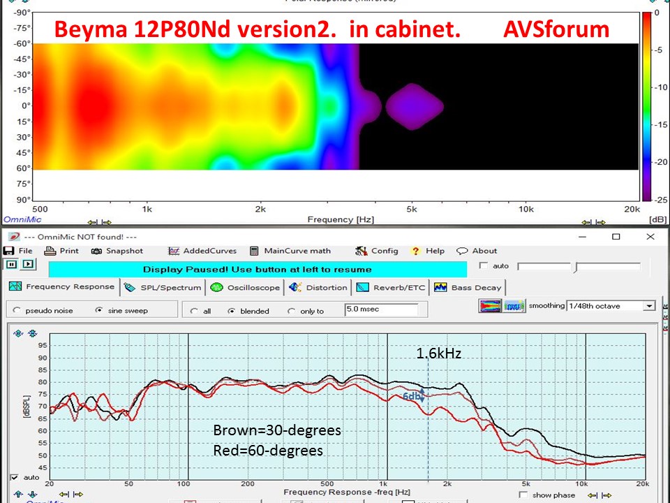

At 1600Hz, the TPL-150H horn's 80H polar response is a "decent" match to curved cone 12" midbass like the TD12M or Beyma 12P80Ndv2, and also using a steep crossover slope like LR4 @1600Hz helps reduce higher frequency cone breakup. The physical offset of the 12P80Ndv2 is very close to the TPL-150H, and if after cabinet construction you want to null this difference, you can try shallow routing-in one driver.

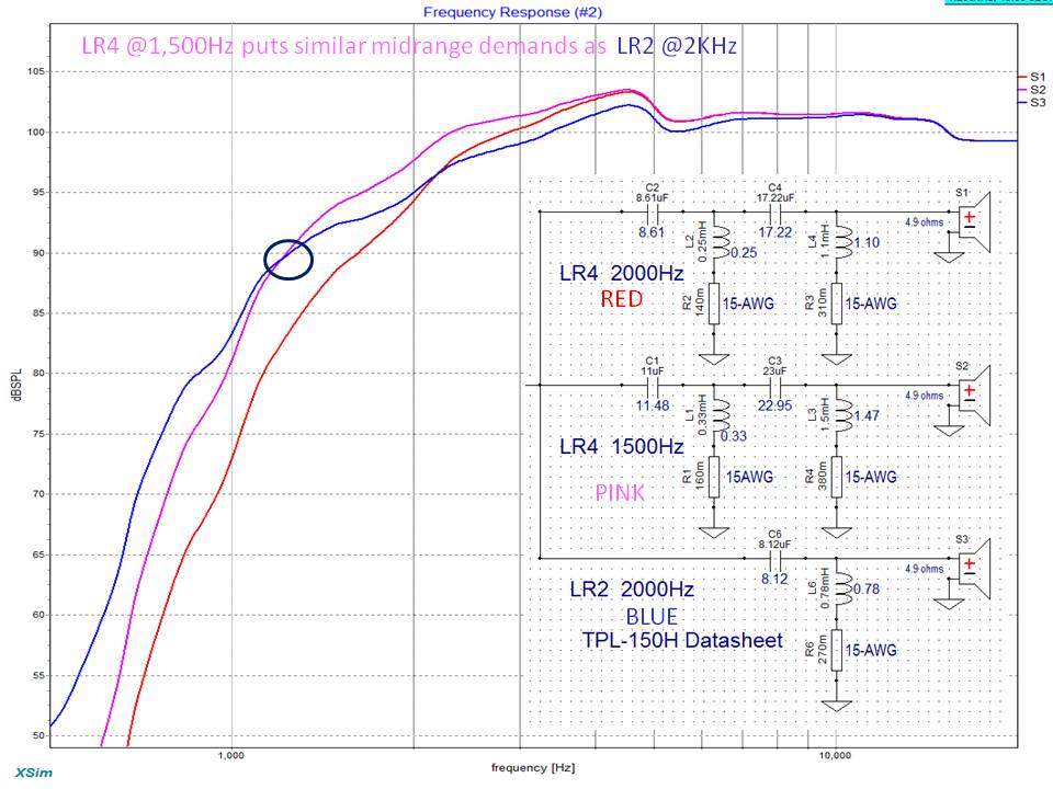

I will probably go with the TPL-150/H for its directivity characteristics.
I does seem that people have converged on these drivers and perhaps a few others.When you pay $500 for a tweeter, you probably want a midbass which matches the efficiency and dynamics.

I am intending to tri-amp.

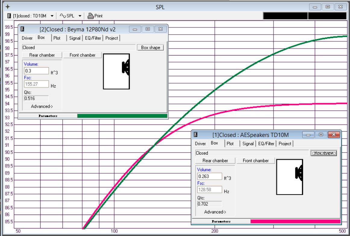

I found a 2015 thread where you leaned to the TD10M over the other options - how do you feel about the TD10M now?
The AES TD10M remains an excellent TPL-150H partner for modest size close listening monitor designs which favor shallow slopes like LR2 for close-up mid-tweet blending.Linesource: how do you feel about the TD10M now?

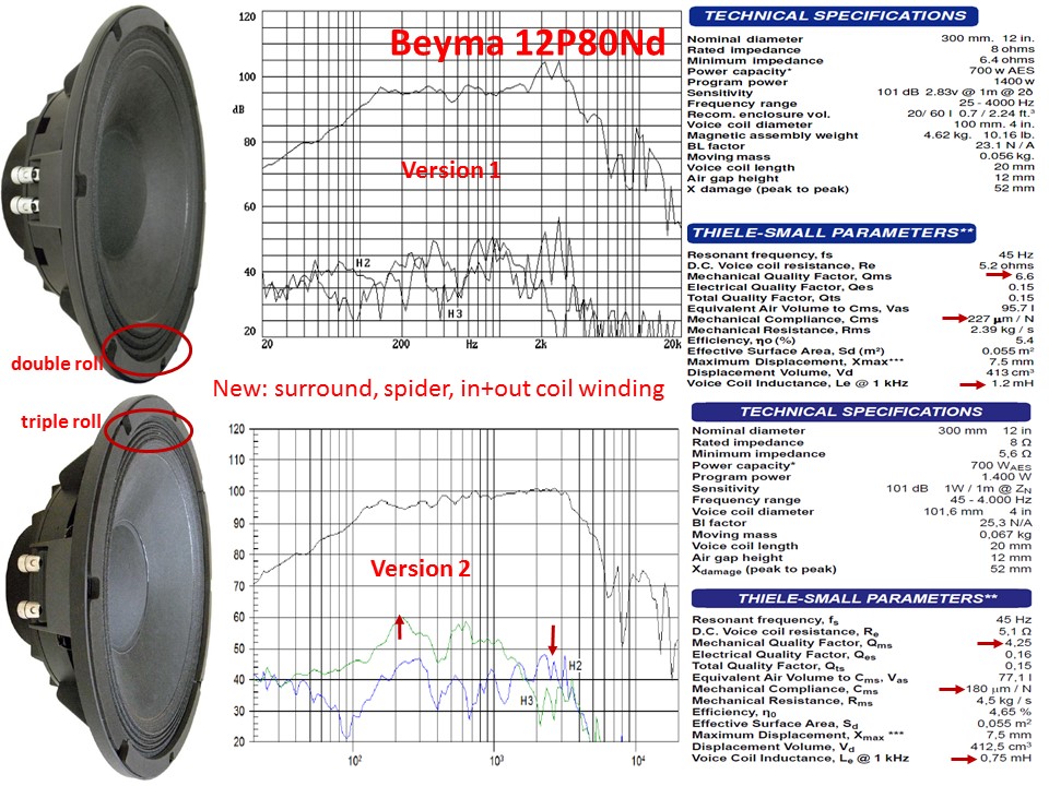

In 2015 Beyma released a version_2 of the 12P80Nd which uses a triple roll edge suspension to remove the cone break-up around 2Khz in the version_1, which made the 12P80Ndv2 a better match for the TPL-150H's "desired" 1600Hz minimum crossover frquency.
In 2010 Beyma published research on new materials and folding techniques for the TPL-150 film-foil planar AMT construction. The data in this paper showed smoother SPL's at both the lower ~1kHz frequency range and 20kHz. Beyma quietly changed the TPL-150 datasheet SPL graph to suggest this tech went into production, which improves a 1600Hz LR4 crossover desired for 12" midbass like the 12P80Ndv2 and AES TD12M.
