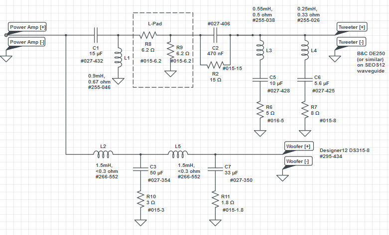

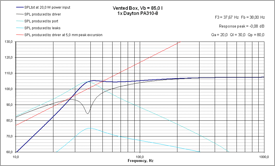

Dayton DS315*8 12" Designer Series paper cone Woofer Speaker 8 Ohm
-F3= 38Hz 2.2cuft volume
4" dia 13.3" long port
If the speakers are close to the walls, a bass-shelf alignment can extend the deep bass.
