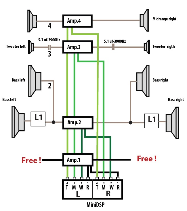

Thank you, appreciatedRe: "What value should be for 7 Ohm ?" - use the formula in post #2.
Re: 'where an inductor should be ?" - if wire as your original diagram, L1 is it
Note that, as wchang has pointed out, my response in post #4 is incorrect if your original wiring diagram is used.

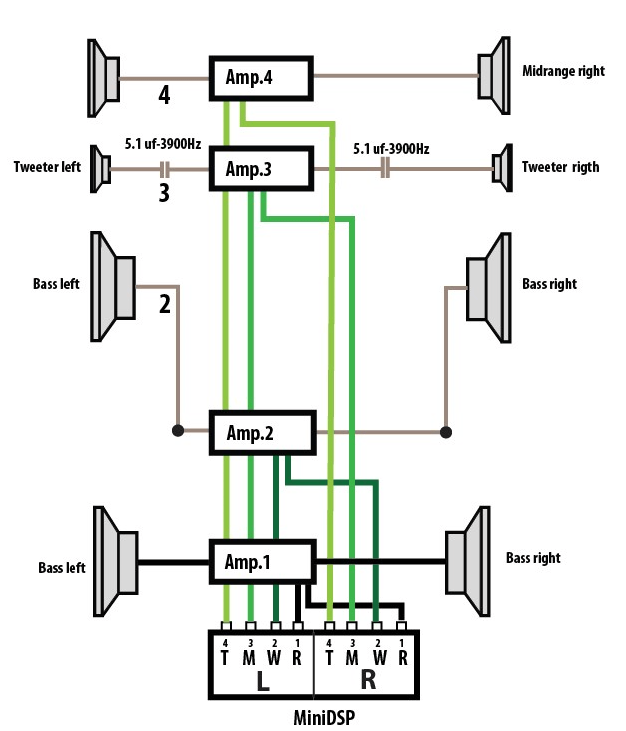

Ok from there you can see all applied filters in set upI can't comment further without pictures and a diagram of your set-up but so far what you are saying is not making sense to me.

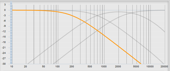

Two woofers ,we are talking about ...one of them has 1 order crossover at 200 Hz the other one at 700 Hz.
Mids are crossed at 700 Hz to 5000 Hz.
Tweeter is crossed at 5000 Hz.
Right now, wiring looks like this
And I would like to get like this ,keeping 1 order crossover for one of the woofers at 200 Hz

While the diagram helps you've left out the information on the drivers involved, that can have bearing on what advice people give you.

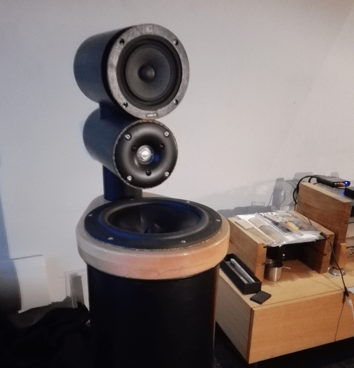

Thank you, trust me ,don't have a wish a form how I should be assisted. No rules for it. Have just asked for advice, what coil of 1 order passive XO to use for one of two DaytoAudio rs225 drivers, because would like one of them play only up to 200 Hz. It is quite simple. I have given all information you asked, made drawings, used time for it . And you just throw me "under the buss". Will it help include a photo of speaker? Please, do assist me, how you find comfortable and the way you see it.I'm not upset at all, I'm simply not able to assist you in the way you want.

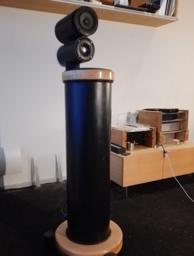

At the bottomWhere is the second woofer? in middle of pipe? At the bottom?
I hope some day mine will look and sound as good as yours.

Keep on dreaming if you think the backside radiated higher frequencies (what phase would those have…) from the higher crossed woofer will not in any way pass the cone of the lower. Just like PR’s (and to a lesser extent BR ports, but they have their own ‘merits’) leak some midrange sound. Just stuff the enclosure well enough, was my first advice. Applies to all X.5 systems with shared enclosures.Thank you, a pipe is 25 liters in volume to share by both divers and this configuration works beautify.... 30 Hz reproduction sound as clean as a spring water..no complaints in there ☺️

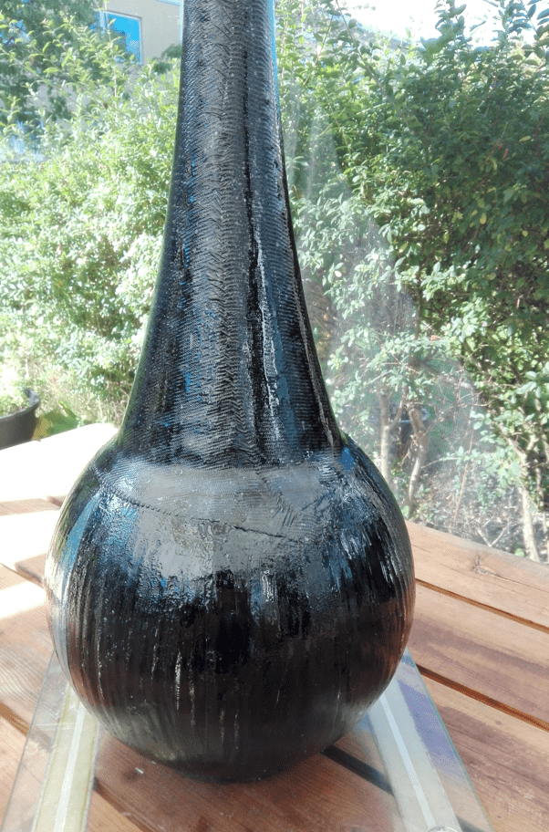

First layer is 3D printed when for second layer rubber applied and then 3 layers of glass fiber. Hope is as will damp all enclosure's resonance.
