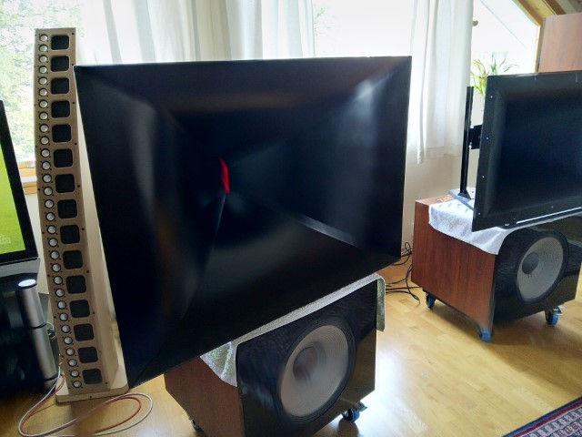

I have considered it. Or offer a 90x60° horn with 1.4" exit, which is the same as the the 80x50° horn except the minor wider beamwidth. Picture of it below on top of a woofer and next to Klipsch K402.
attachment.php
Right now, it would effect the complete system because we're not able to manufacture much. It wouldn't be particular cheap with the building method (much improved over PA horns like the Klipsch K402) and low production numbers. Because of the size, shipping cost will be high as well. Most DIY'ers generally expect low prices, so not sure if the market is really there. Then there's the possible challenge with demand for assistance with crossover, EQ, etc. And I'm certain some will ask about using it with other drivers than the Radian 951, which would require a new design of the adapter.

sfaik the K402 is a highly respected horn design. You say that your horn surpasses it in several ways and compare it directly to a competitor. Could you prove this with BEM simulation figures? Radiation impedance, polar?
Btw, it looks very similar to what the Celestion horn wizard puts out.

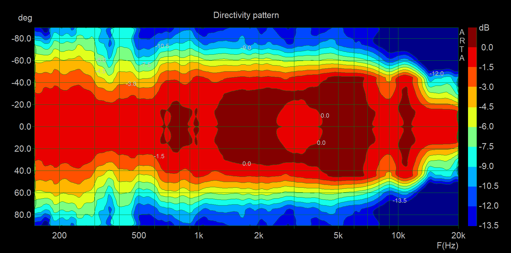

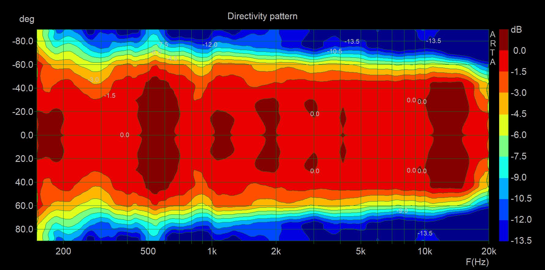

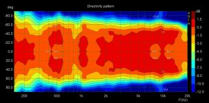

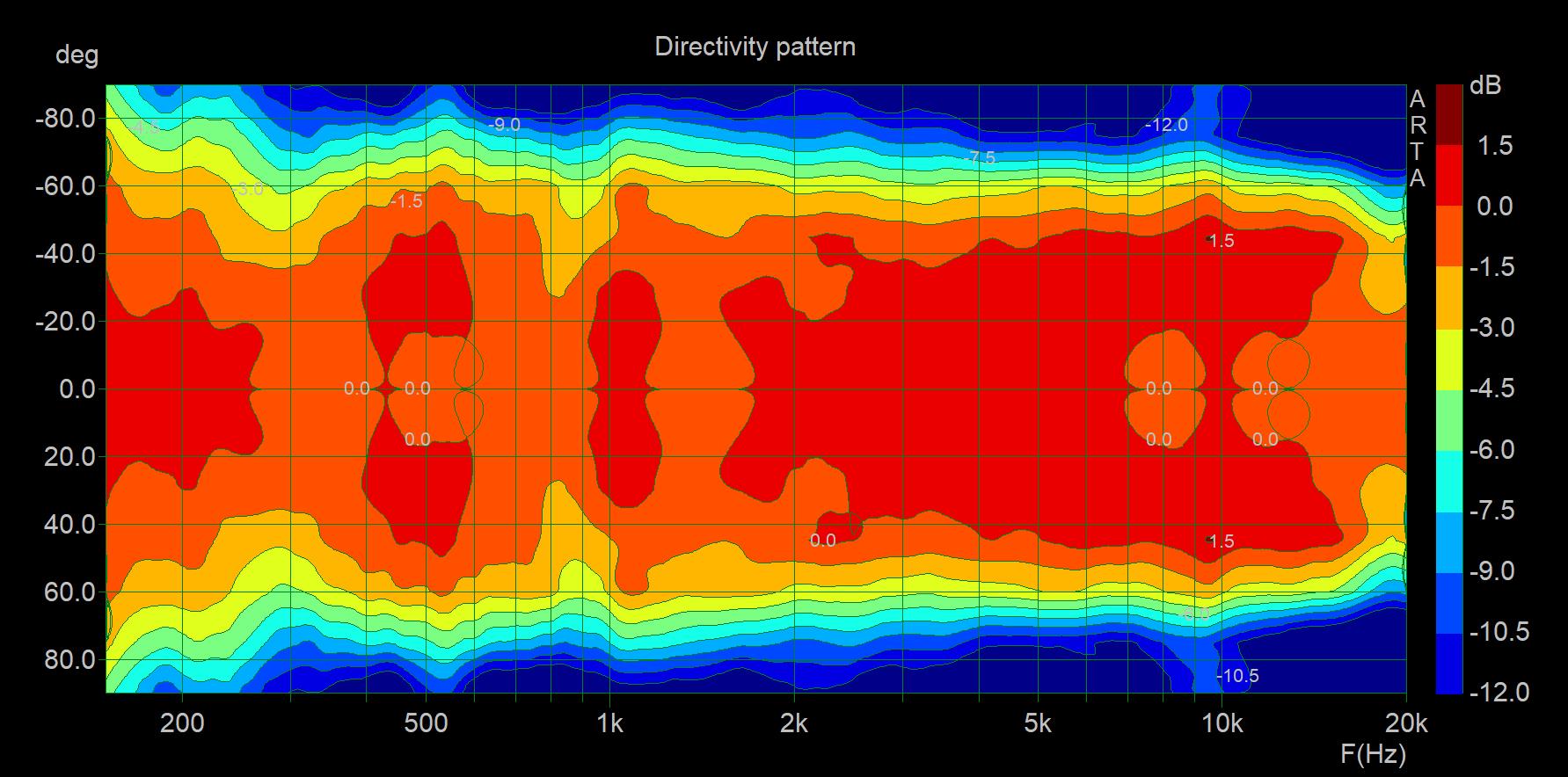

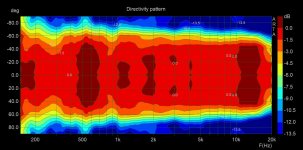

I don't think you can prove much by a BEM simulation because that requires an intepretation which will vary among many. And it's only one part of many parts that come into play. We'll post finished and anechoic polars and other measurements eventually. My crude horizontal indoor measurement can seen below. As I mentioned in another thread, my indoor measurements become much wider than what the speakers actually are or anechoic. So avoid looking at the actual beamwidth please.
Klipsch K402 indoor horizontal polar with no gating:
attachment.php
90x60° horn indoor horizontal polar with no gating:
attachment.php
80x50° horn indoor horizontal polar with no gating:
attachment.php
Obviously proof is in the pudding though. And which is done by AB listening (or even better: ABX if possible). But there wasn't a subtle difference, so personally I never felt a blind test was necessary here.
We AB testet it over many days in both mono and in stereo. And the Klipsch actually had an advantage here because it was using a beryllium diaphragm, while our horn wasn't. But the horn is really much more important than the driver. A customer bought a prototype of the 90x60° horn and sold his Klipsch K402 right after getting it and felt it was an improvement. Not that proves anything but anyone how buys the horn are welcome to do the comparison and make up their own mind.

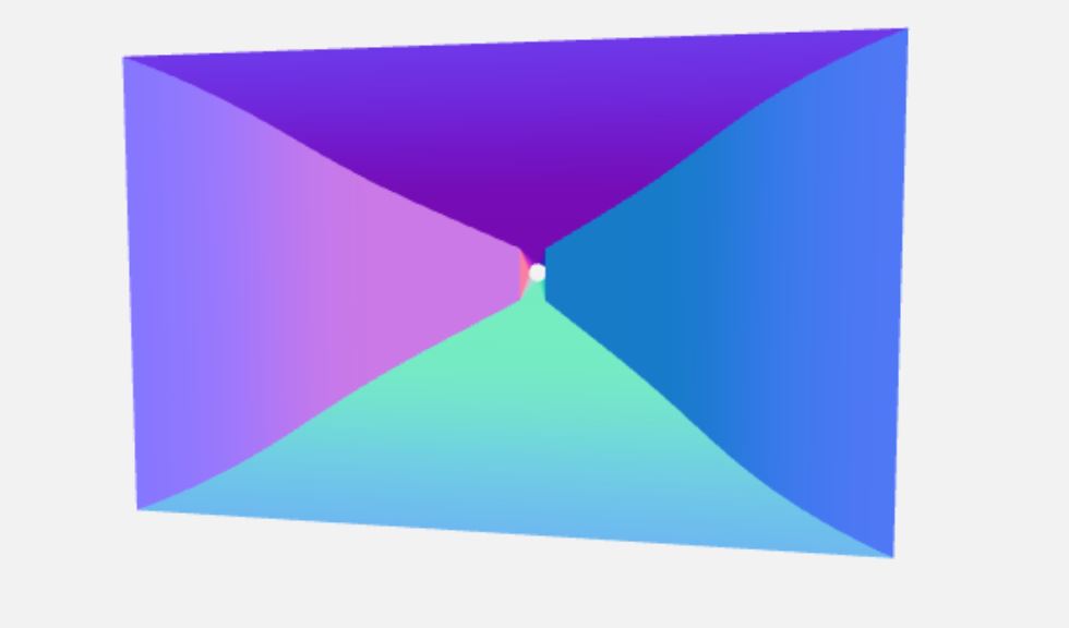

all this over the mechanical drawing?
i think there's an assumption being made that one of the views is a mid line cut view, when in fact it's an "outside" view, so what looks like a "throat pinch point" is in fact illustrating an "outside" casting lines!
there's enough perceptual problems with audio let's not bring visual distortions into the mix!

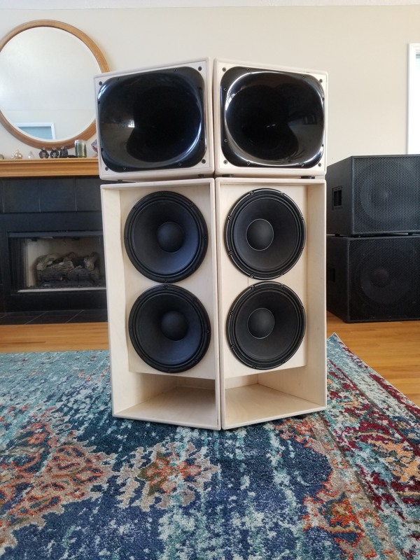

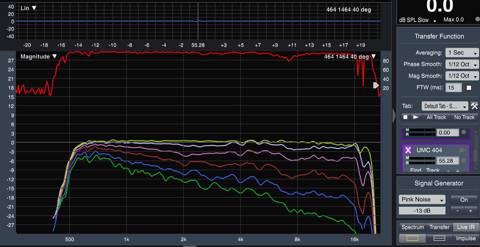

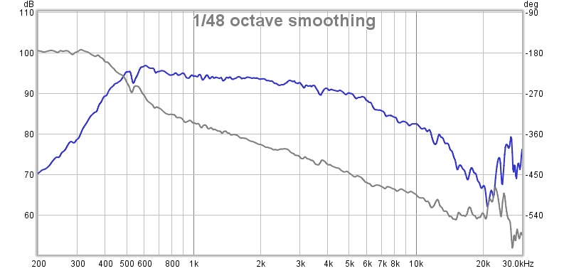

I don't have any measurements of the horn alone for comparison, but here's some from one of the XT1464 boxes pictured.
The box is a trap box with side angles designed to let two or more xt1464's splay together for even coverage in a modular PA system.
It's as small as i could make it, and also exchange the baffle with other small horns.
dcx1464 processed at 0 deg .
Steep 500Hz hpf in place.
10 deg increments

This horn (XT1464) is used in the Unison MAX2 together with the ND1480
Thank you. That's a great example. Seems I am reinventing the wheel. Good to have some confirmation.
My project is modular, with a separate mount for the tweeter on top. Similar look to the Unison Max 2, but in 2 parts. Woofer boxes are complete. I needed some ideas for the tweeter box/mount. Free standing would be cheap. I don't know if a box would positively or negatively affect response. It would look more finished. The whole is slightly taller, wider, and deeper than the MAX 2. The Unison MAX 2 has a better finish. Mine are painted on all sides.
10 deg increments
Thanks Mark. Your modular trapezoid boxes look good.
The curve of the dcx464/XT1464 is impressive.

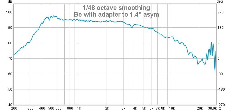

What I can contribute is quasi free-standing measurement with ND4015Be (with 18s adapter) near mouth. The more the mic is moved away the LF part would come down. I generally make some initial measurements near mouth in order to blend out the room reflections. But loading is excellent down to at least 500Hz.
