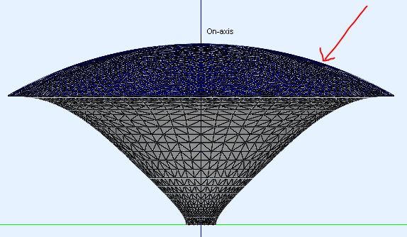

Is the waveguide unbaffled? That will make the edge treatment critical and not actually give the best results. A baffle makes things much better.

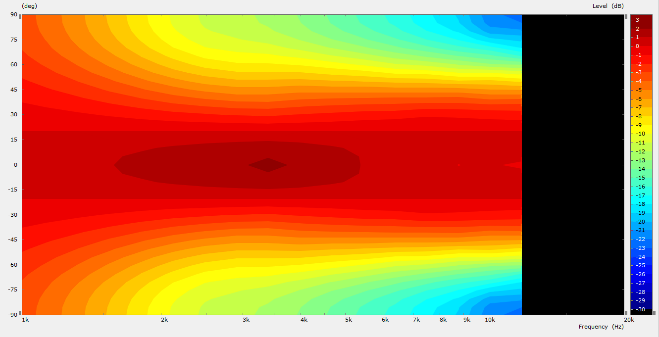

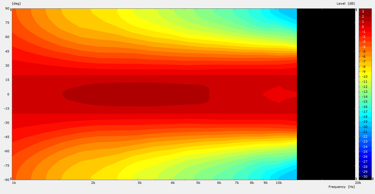

Try the second one then 🙂... Had a quick look at the round OSWG and it works like a charm.
As Fredrik says it's in an infinite baffle. Otherwise it would be a disaster as you say. It would be possible to run it that way however (been there), it would take much more computation time as the back side would also need to be modeled - it can't do sheets of zero thickness. I will definitely add an option of a box as an alternative to IB condition. Yeah, Gmsh makes the modeling a piece of cake.Is the waveguide unbaffled? That will make the edge treatment critical and not actually give the best results. A baffle makes things much better.

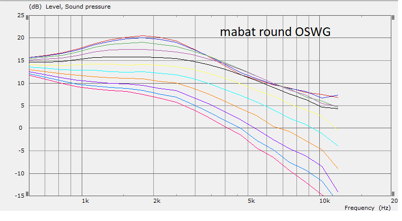

Works perfectly, and the response looks really good! Better than the round OSWG which still show some irregularity in the 0-20 degree area.

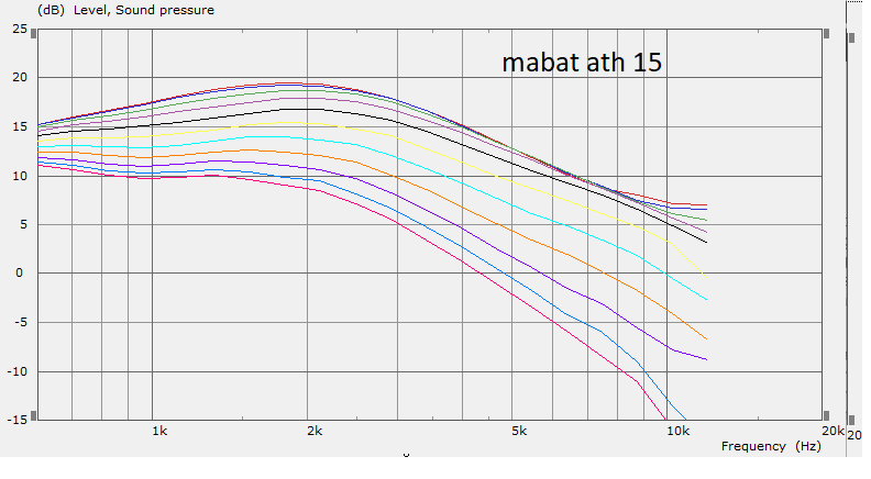

Round mabat- OSWG curves:
Rectangular mabat design (ATH-15)

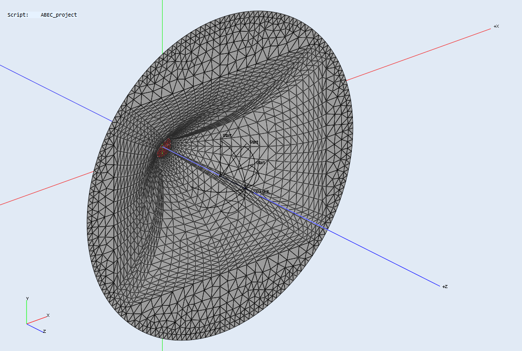

One ABEC specific question; I see that you are using a curved/spherical interface at the horn mouth.
Why is that? I have so far only used a flat mesh for the interface:

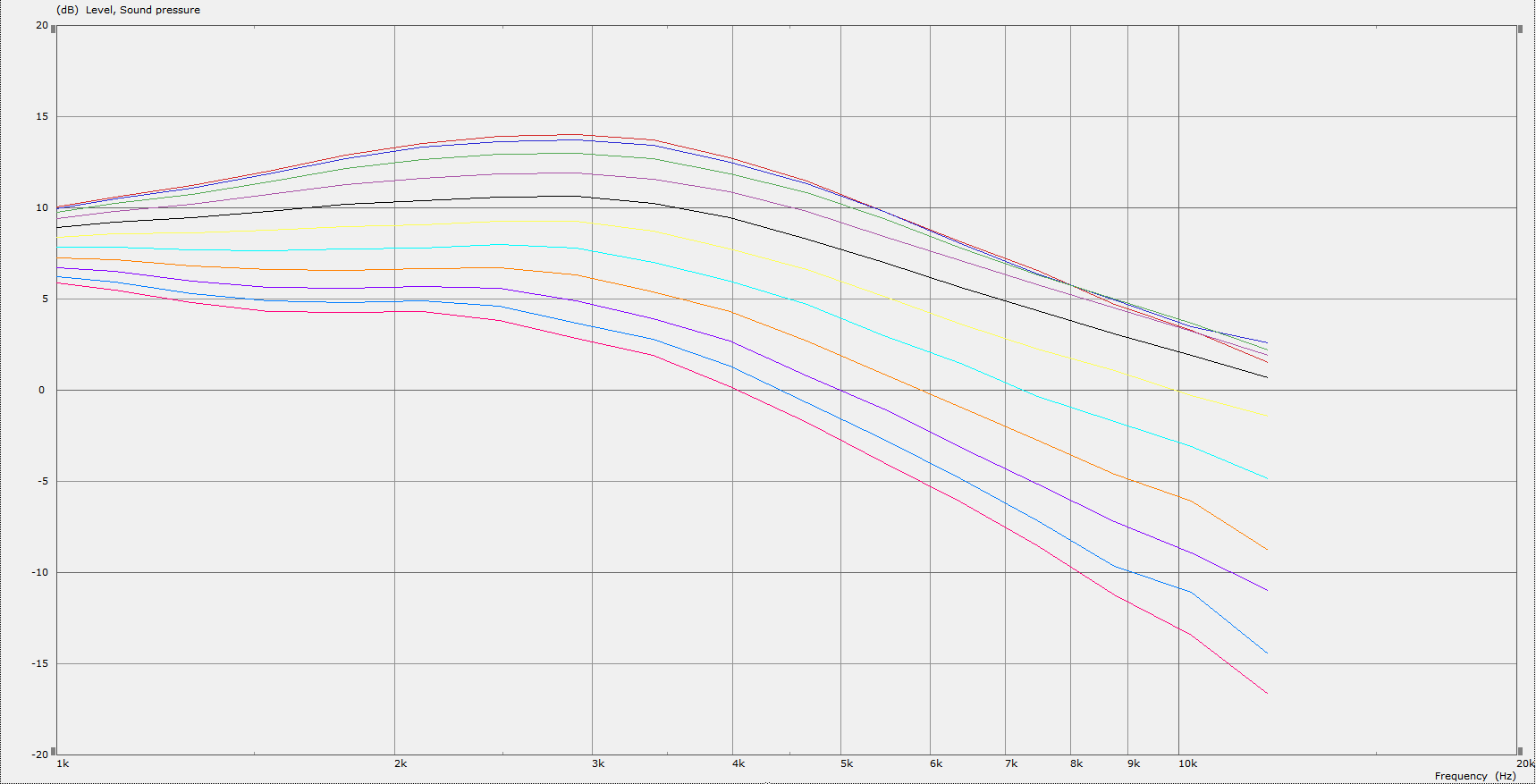

Your solution looks also very smooth Fredrik. When I try to squeeze my horn to 10" (256 x 236 mm actually) I get to these results (polars are 0 - 75; step 7.5°) -
More on the interface later...
Nice! Your design seems to have better control over directivity at the lower end of the passband.

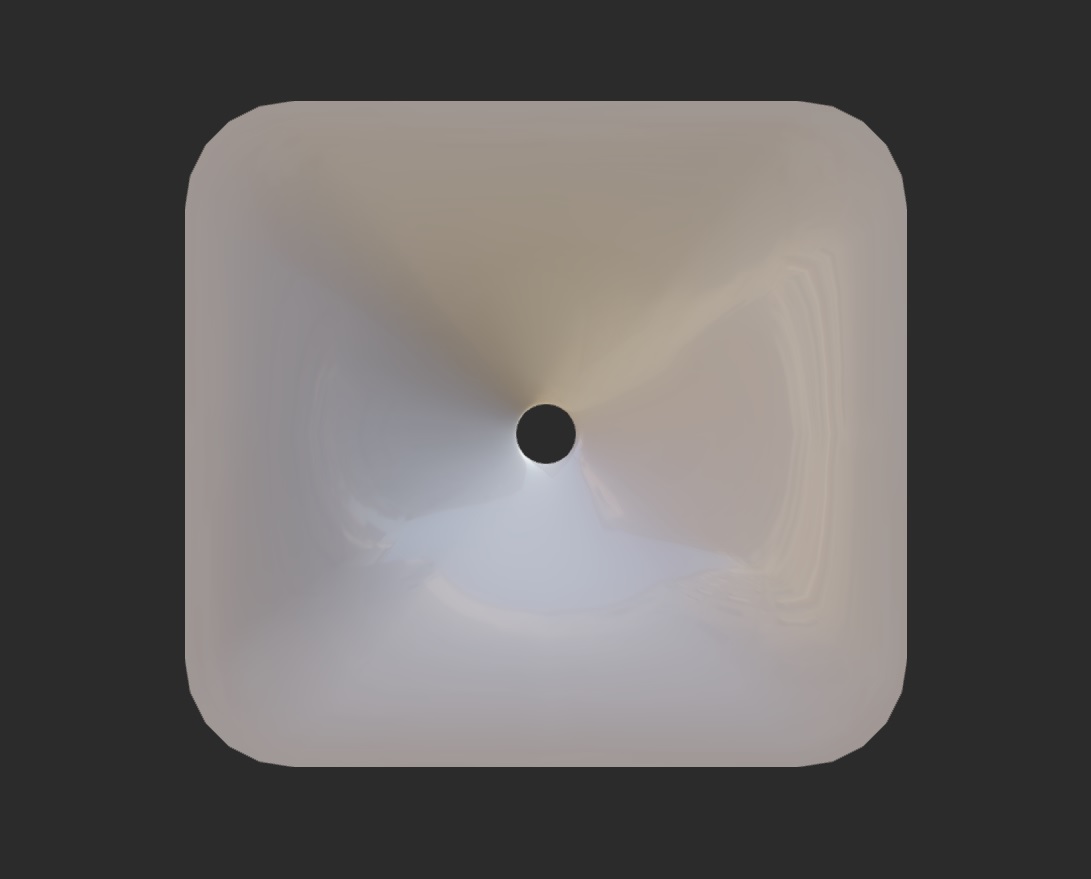

For sure, otherwise it would be useless. This is an excerpt from the definition script (the horn just shown), all can be changed:
It seems to me that in case of a rectangular shape the available mouth area (for a fixed enclosure width) can actually be utilized better. Just my impression.

I don't know the particular driver. I got throat size, entry angle and the size limit so I came with this OSWG which is about 15.3" (6.3" depth) and "ATH" which is 17.3" x 15" (7"). Since the throat is for 1.4" I would expect the xover around 700 Hz without issues. Maybe a bit lower with the ATH. Depends on the driver and the woofer used. The request was also for 80x80° coverage which may complicate things a bit. Personally I would make it wider.

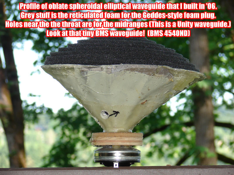

I simply cut mine with a scissors:
I suppose you could glue the layers together, but I didn't bother. I wrapped the whole thing in spandex nylon and the compression held it all together.
For comparison's sake, here are my Summas, which had a solid plug milled using a hot wire by Geddes.
Yes, I have used a hot wire in the past. I'm not completely new to the foam plugs. I wouldn't do it again. 🙂
