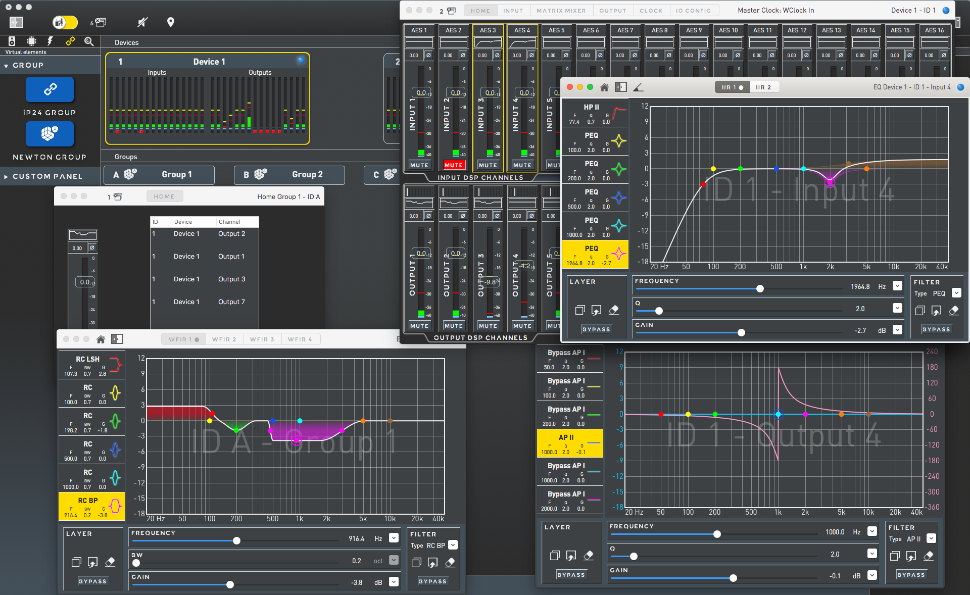

This company did apply patents for their line-array and DSP technology.

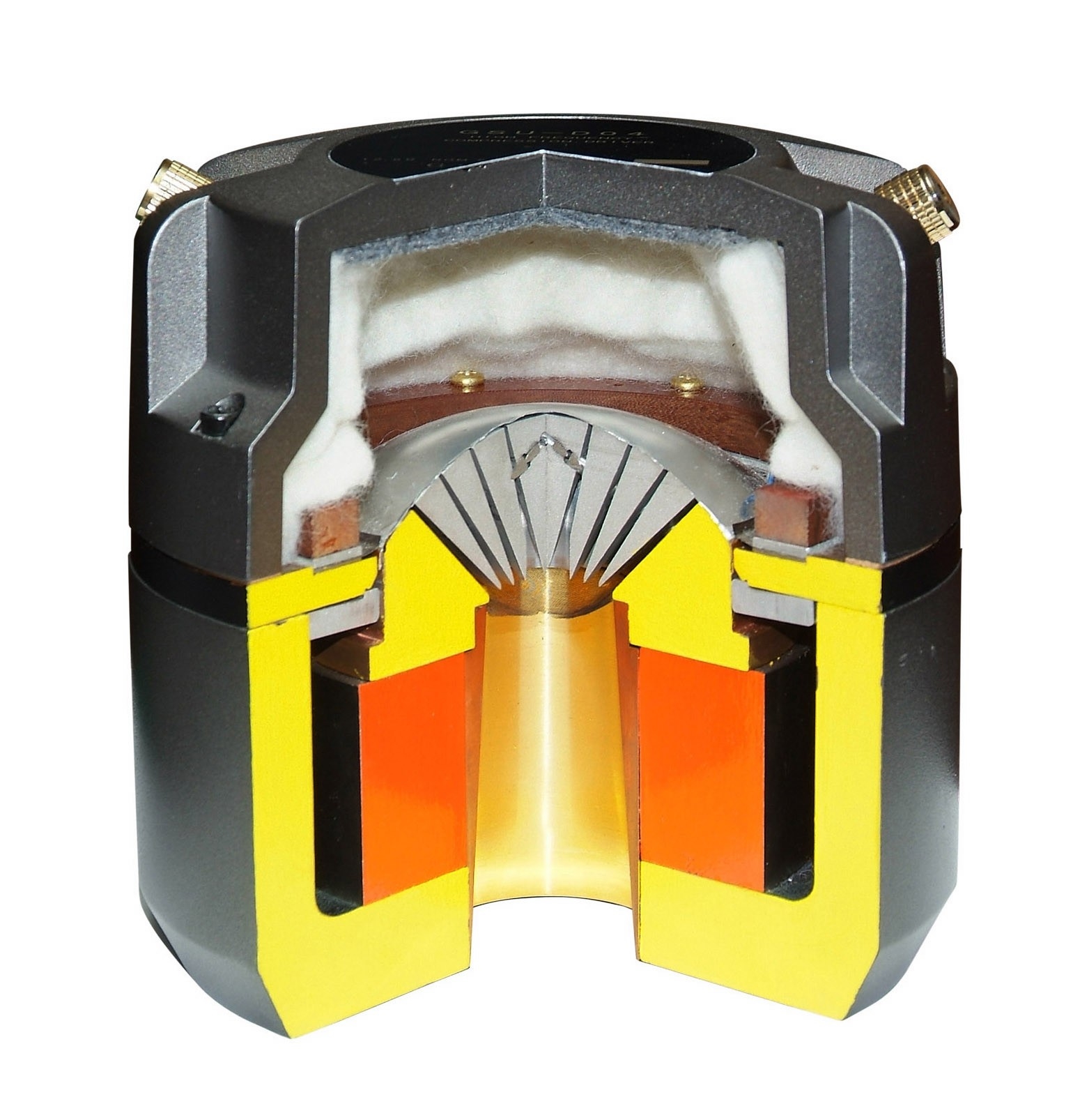

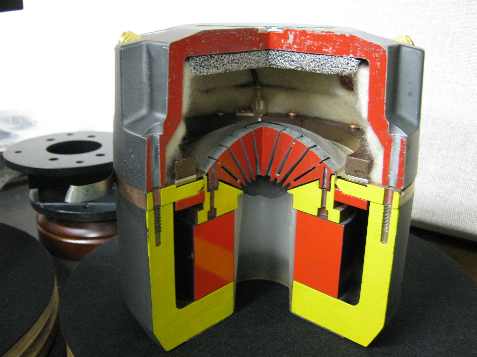

Those are SUPERB drivers, especially the Sony compression driver!
The Sony drivers were supposedly developed with input from ALE/Goto engineers (mr. Goto) ao.

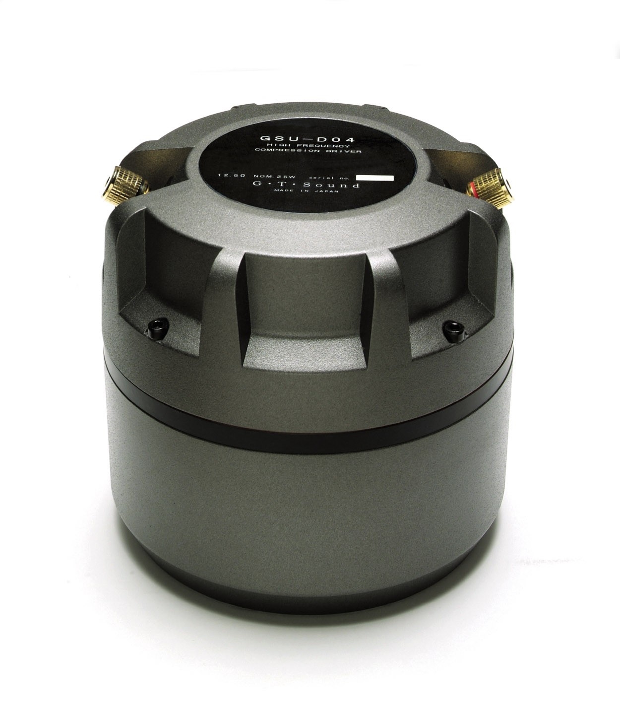

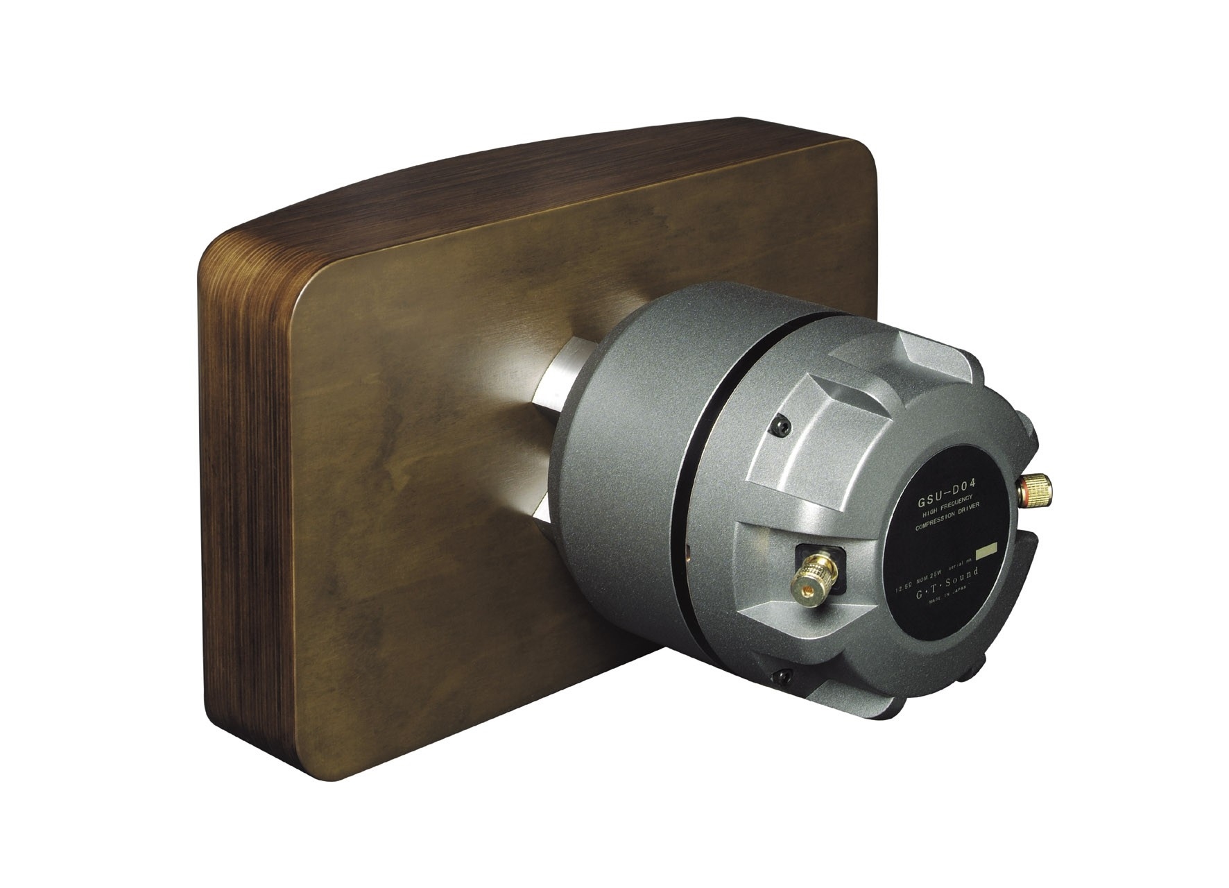

The SUP T11 is more or less identical to the G.T. SOUND GSU-D04.
(Translated) specifications:
Thickness 35μm aluminum diaphragm and the voice coil is electric welded.(no glue) →Light weight vibration system. It is almost flat up to 24kHz. Even a minute signal reproduces plainly.
Adopted pure brass throat with gold plating → The throat has huge effect on sound quality. By making it in pure brass it is able to create a clear sound.
Adopt strong alnico magnet (weight: 3.1Kg) →High magnetic induction of 20,000 gauss.
Phase plug is assembled without any glue. All machined out structure →Low distortion and improvement in low frequency and magnetic efficiency.
Adopt edge wise wind up voice coil →superior in conductivity and line mount pure aluminum stute wire for excellent reliability and linear.
Adopt aluminum machined out phase plug →By its multiplex structure it produces solid structure and beautiful finish with low distortion.
Back cover is made from zinc which has high vibration absorption character →Lowers Back Chamber's resonance and natural sound with no coloration.
Precise parts, production quality control, measurement and adjustment →All products are matched→Left and right channels sound uniforms→Low distortion.
Official impedance: 12.5Ω
[Horn throat] diameter: 49.2mm
Voice coil diameter: 101mm
Bandwidth: 500-24,000Hz
Recommended crossover frequency: More than 500Hz
Ratings input: 25W
Output sound pressure level: 110dB/W/m
Magnetic induction: 20,000 Gausses
Externals size (outside diameter × height): 178×175mm
Mass: 18kg

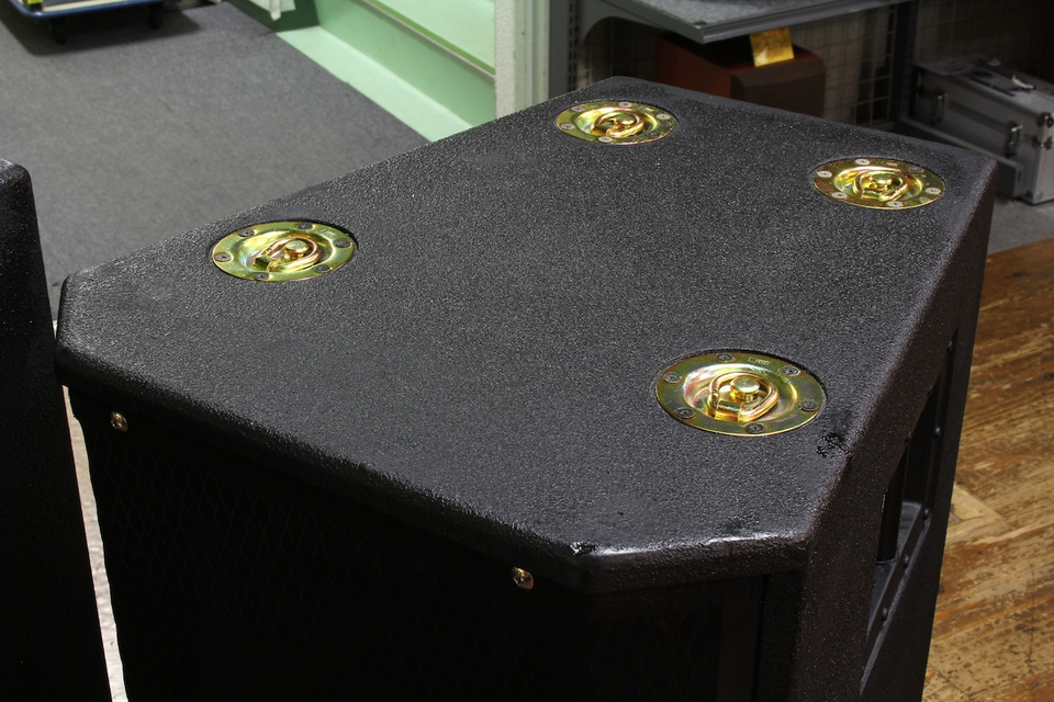

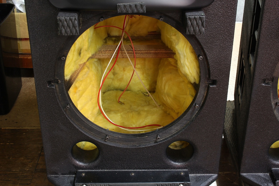

Check the build quality of the PA cab.

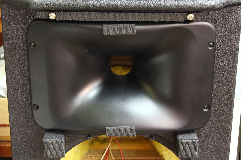

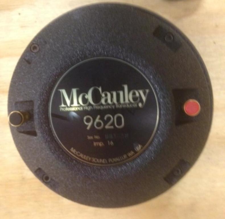

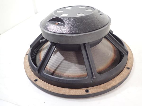

For the PA cab naturally Sony didn't use expensive SUP drivers.
Instead the company cooperated with McCauley and mounted a modified and rebranded 9620.
This is still an excellent driver, Jean-Michel LeCleac'h liked it a lot.

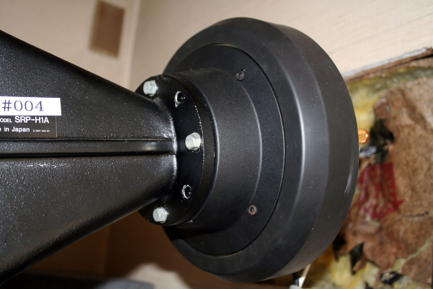

The same Sony/McCauley drivers were used for Sony's professional cinema loudspeakers. These are extremely rare.
I think most of us have never seen these before, or knew about their existence.

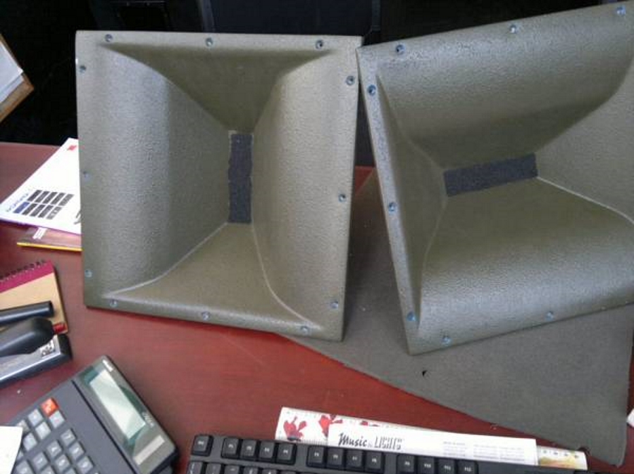

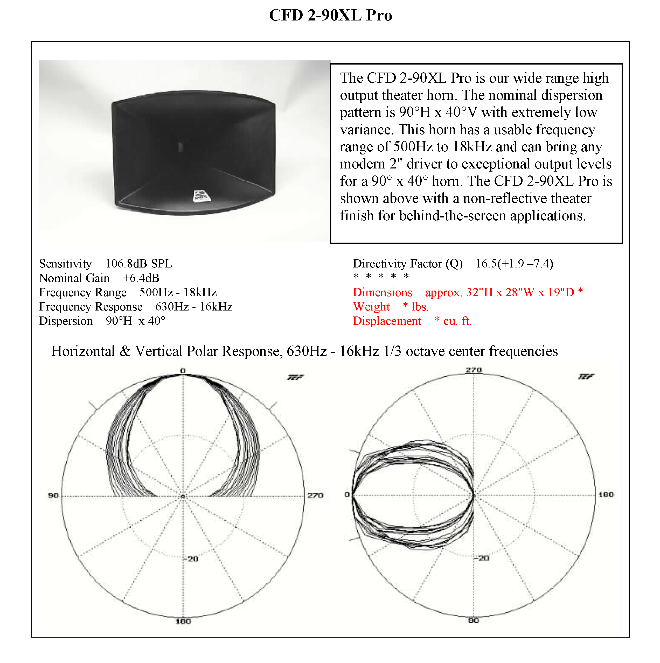

In the US, you could buy these DDS horns that look somewhat similar, but are smaller.
The slot length is considerably truncated, which usually is a good thing.
These cost about $250 each.
There's at least 1 member here, that has a number of these in use.
