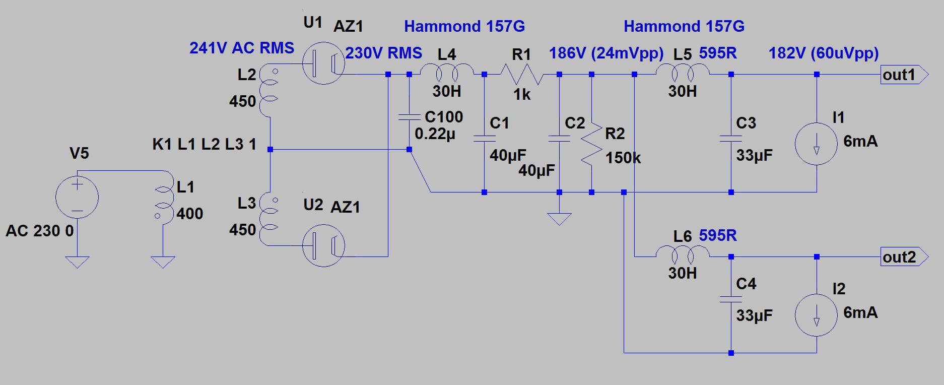

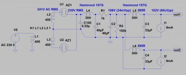

Thanks for the info. I just need to try to understand it now! Here is the actual HT supply I have at the moment, changing R1 to 1k sims to about 170V with this layout, assuming 4mA total draw per channel. I1 @20mA is the 15k bleed on the first cap. Would it work? Or do I need another bleed?
I would rather not add a cap at the front if I don't need to, just a switch from the current 2k5 R1 to whatever it needs, 1k probably, to raise the voltage. However if there is an overwhelming reason to change that then of course I will.

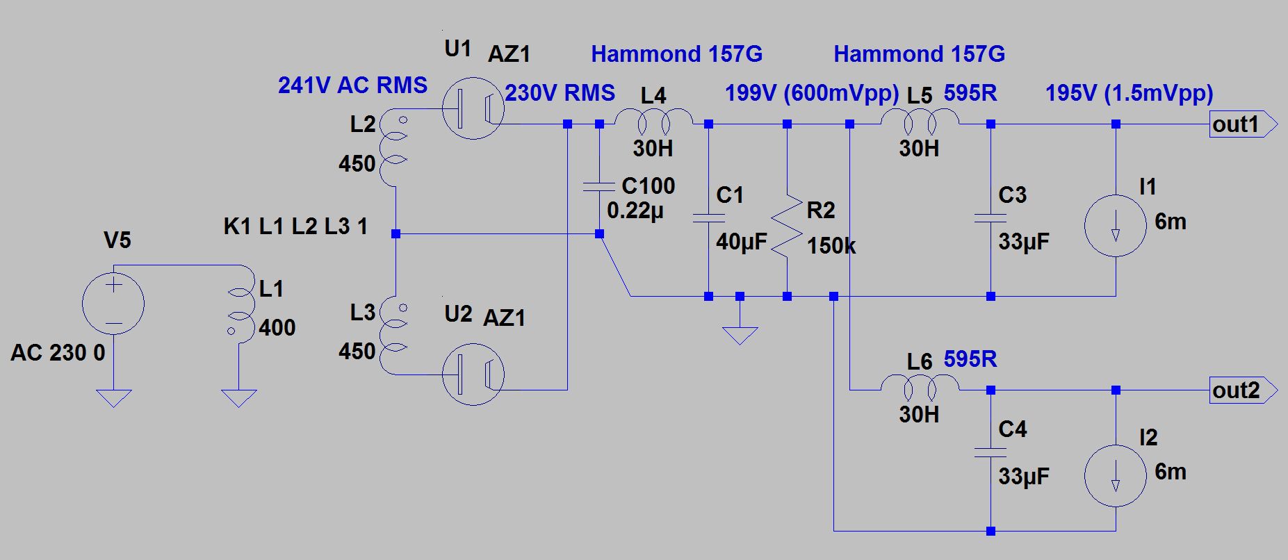

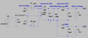

The minimum current for a choke input supply is Imin(mA)=Vin(RMS)/L(H). You can then subtract 2 times the 01a current (rounded up to 5mA) and the remainder should be what you have to bleed. Put the bleeder after the 40uF capacitor. I'd try to reduce the 2K5 if you can and introduce a tuning capacitor (100-470nF) before the input choke to dial the output voltage. Play with the PSUD2 to obtain the desired output level.
Voilá.I'd remove C2 and R1.
Great stuff. With the 30H input choke the bleeder is only required to discharge the caps and not not guarantee choke input operation. Only important point to highlight is that if the preamp isn't connected by any chance the supply will work as cap-input and maximum HT will be delivered so the caps need to be rated to 500V ideally.
IMHO this PSU is significantly overdamped.
The output "hum" is in the microVolt region.
The gyrator doesn't require this "clearness".
However, this is the PSU I have. I am not going to start removing large parts of it unless it is absolutely essential. But I will try modelling different simple changes. I remember when I was building the 26 (my first attempt at something like this), Andy in particular was trying to persuade me to forget that and go straight to this design. I'm happy I didn't!Agreed Béla. I'd remove C2 and R1. Sufficient smoothing is provided by L5/C3 and L6/C4. Having extra 12V won't harm at all.
The 40uF are ASC oil and the 33uF are Clarity Cap Kelvin polyprops.I assume from 40uF and 33uF values, that these capacitors are oil (for example ASC, or GE) or polypropylene types, over the 400V.
