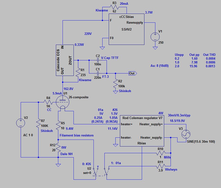

Nice picture - I have finished my 01a preamp week ago, but my tubes are not so bright - light is barely visible.
Does it have to do something with manufacturer of tubes or their state? I use Cunningham globe 301a.
I am pretty sure that I have biased them well - 0,03 volts drop on 10R resistor. Filaments are 3.4 volts exactly when measured with multi meter.
That is the answer.
01a requiring 5V/0.25A as filament.
I think that in Ale's preamp that is on picture above they are slightly starved - 3,4V 0.2A, so there should not be difference with mine.
Otherwise you are absolutely right - they will be more bright at 5V 0,25A.

It's current starvation, so voltage across the filament will vary depending on the valve filament resistance. You should measure current, not voltage across the filament

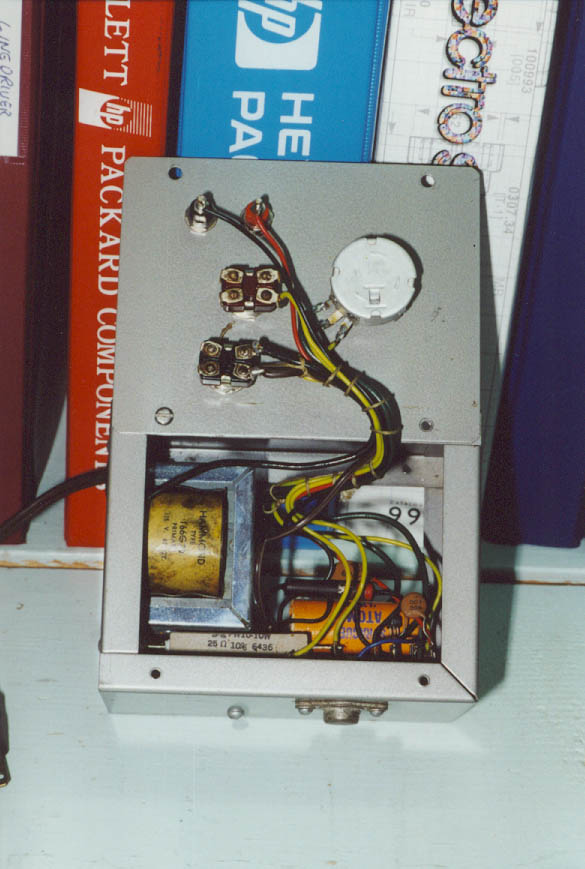

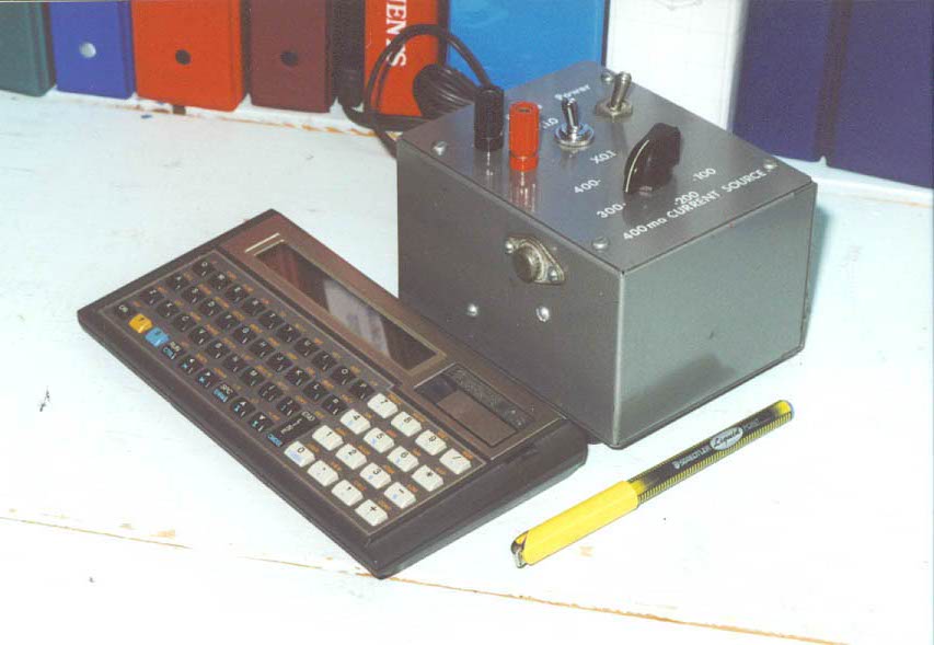

🙂I get the sense that some here are measuring their 01A heater resistance with ordinary VTVMs or VOMs. Whether digital or not, different makes of meters will give different answers. We don't know what current is applied during the measurement.
To get an accurate answer a constant current power supply is useful. Some example measurement results are attached. I don't have any 01A's in my stash, altho they were quite common when I started out. In 1969 I built a very useful CC Supply, still in use today.
Ok, that is clear. But you can measure current inline with circuit or voltage across resistor to calculate current.
How do you do it? Measure voltage across filament resistor and set it to 4V on Rod' regulator? 4V/20R=0,2A. I will try it that way back home and check voltage drop across filaments. Might be reason of dim filaments.
If it's too cumbersome to place an ammeter in series then you have to measure first the resistance of the filament bias resistor. Then you can calculate target V=203mA*R that you should read with your voltmeter across the filament bias resistor. With the filament starvation you should expect a dimmer emission though.

BTW I have incorporated a connection in my 26 so I can plug in an ammeter to adjust the filament bias; no room for permanent meters on the top plate, sadly
MY #26 HT in the separate PSU chassis is this, which I would need to use, with mods -
I would expect to make another chassis for the 01A, with another set of Coleman regs, the gyrators (instead of the LL2745s) another pair of chokes and caps, sockets, pot, etc, to replace all of this -
Is this sensible?
