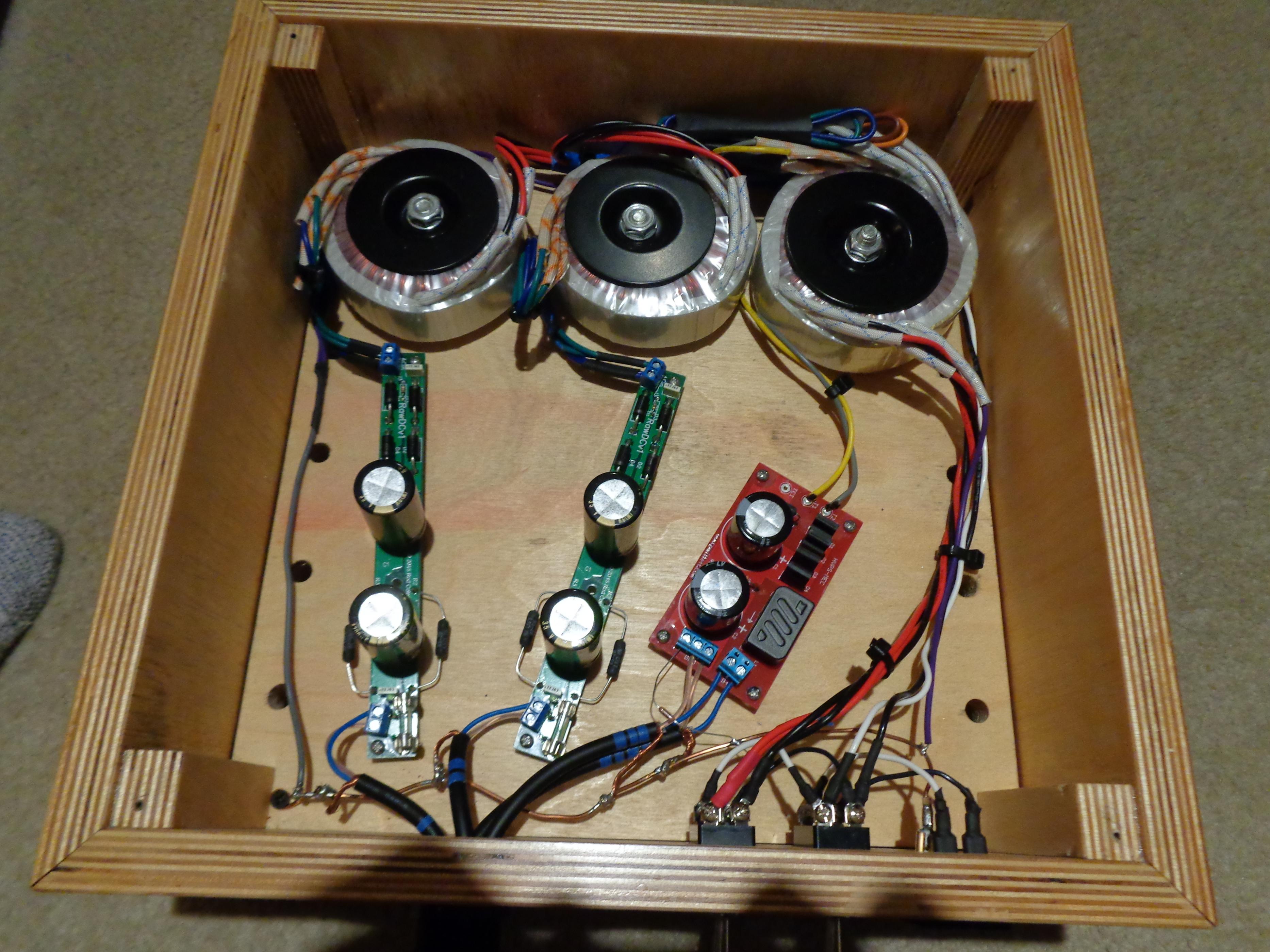

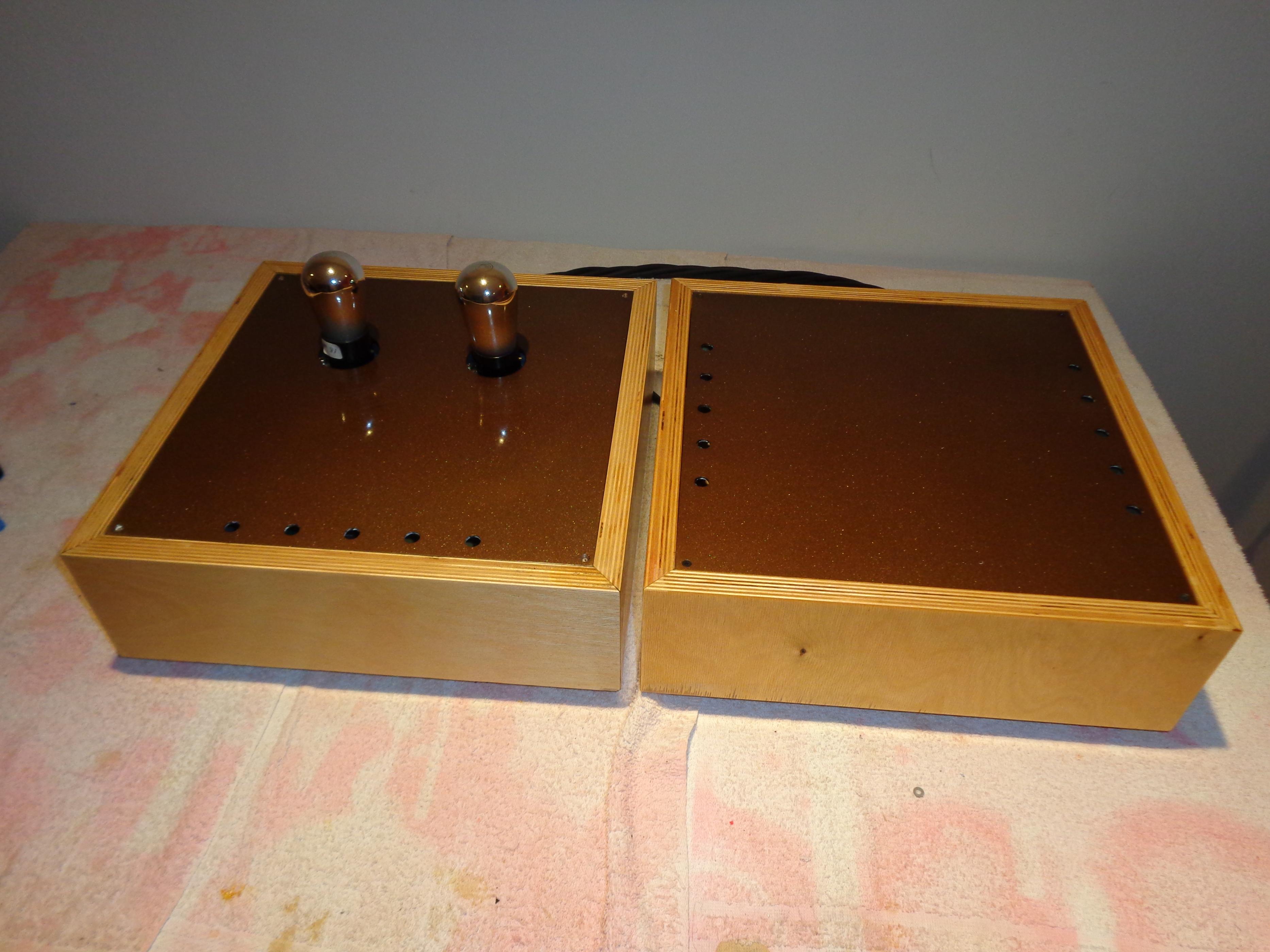

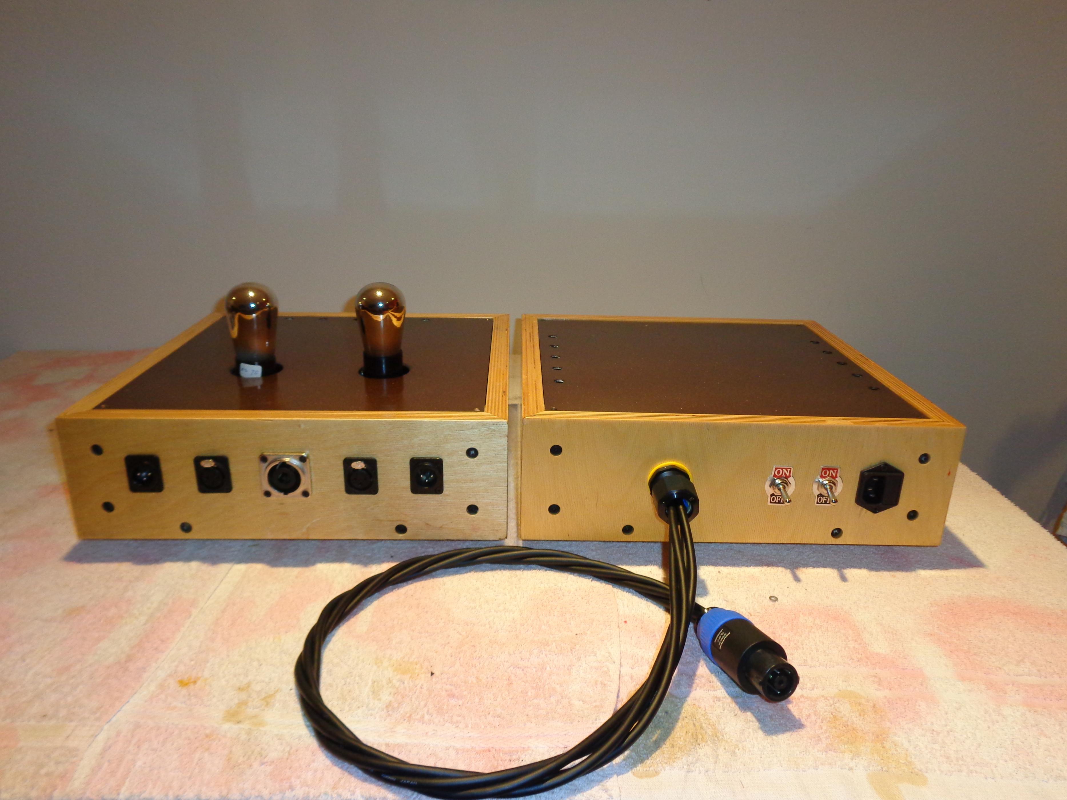

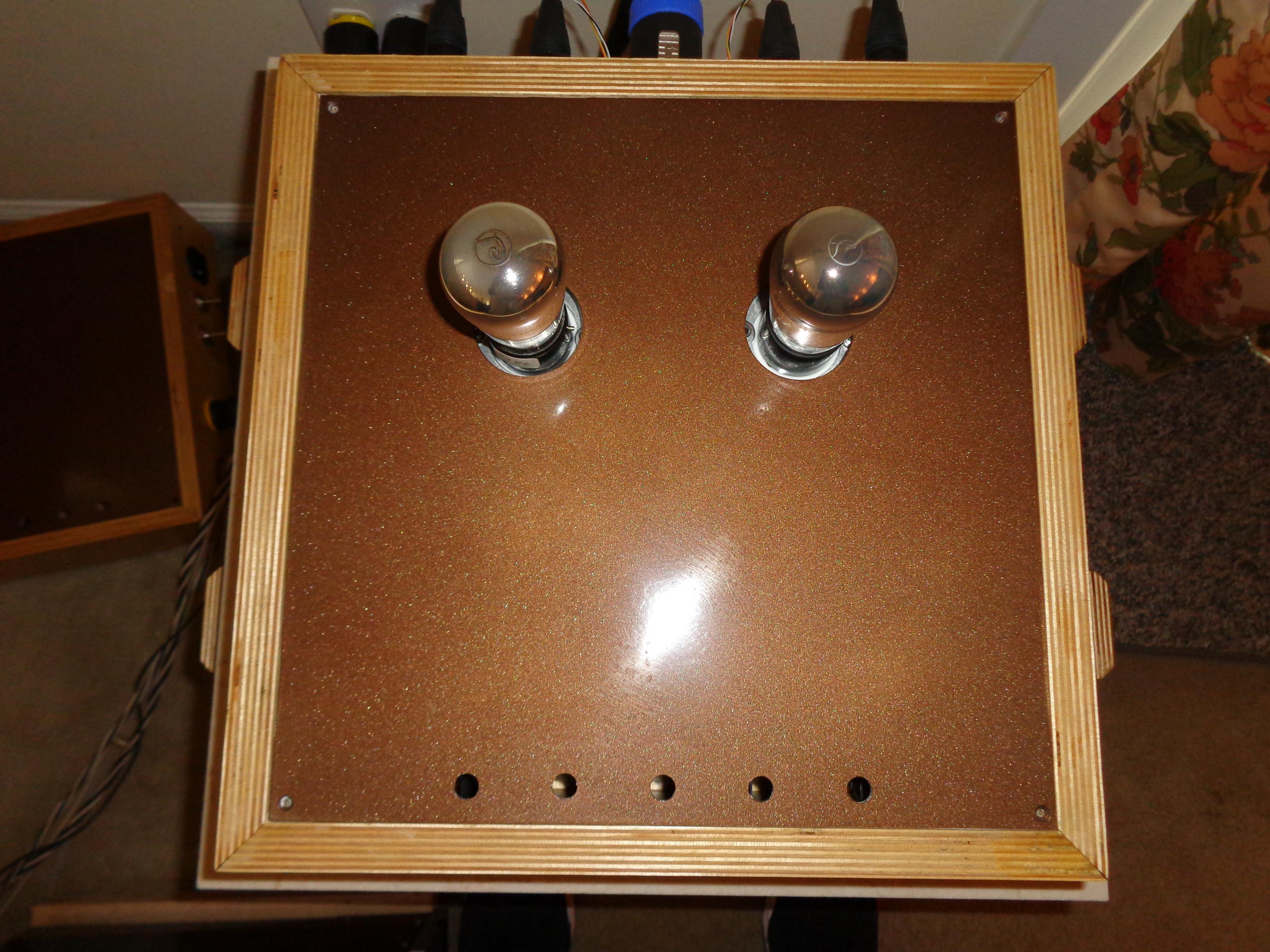

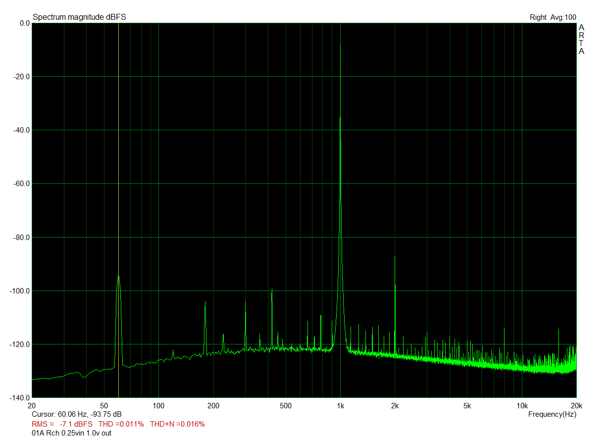

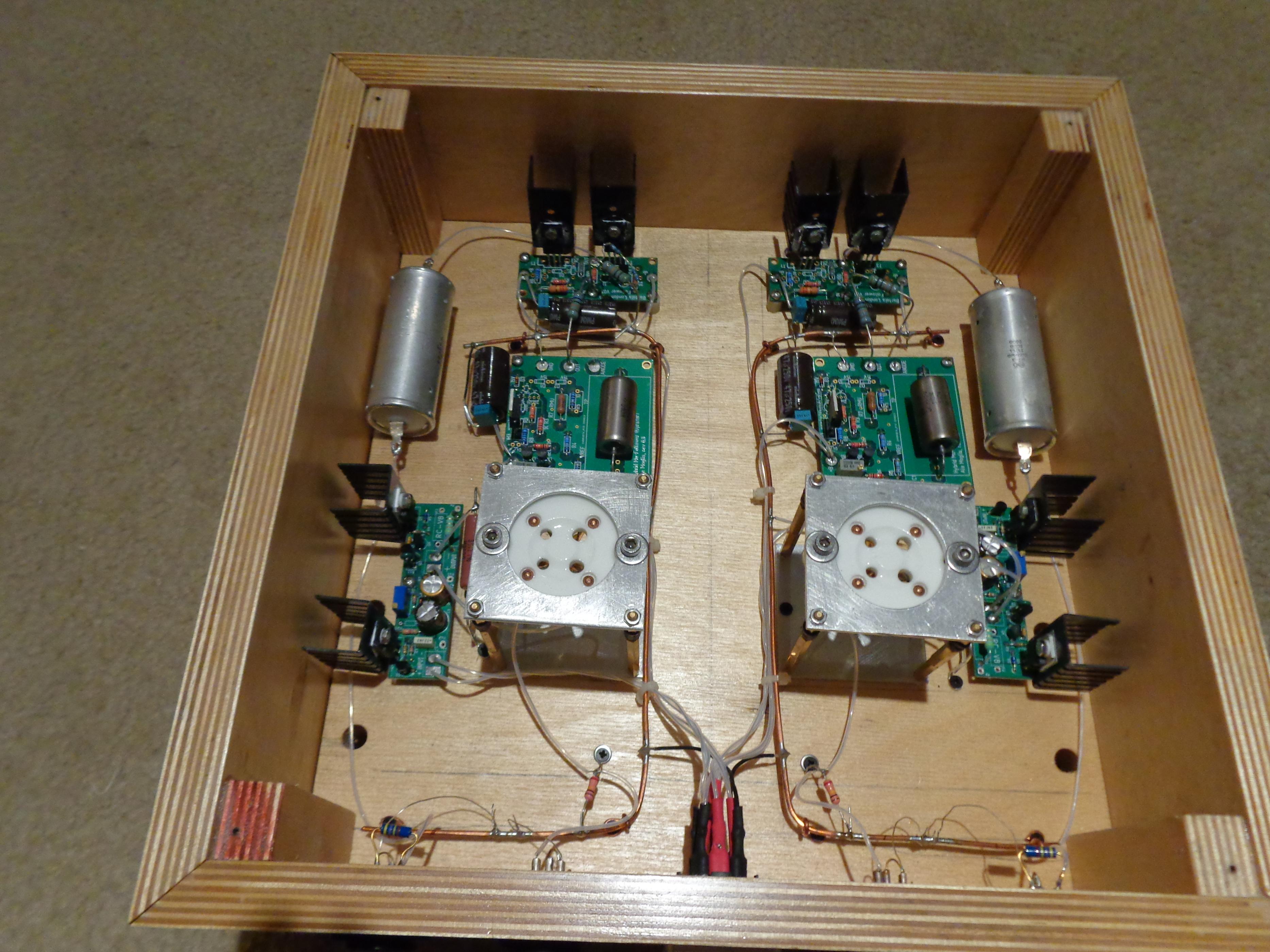

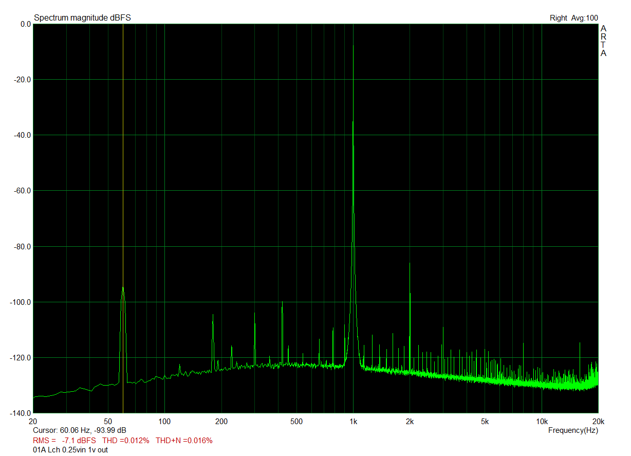

Two box 01A build
I finally completed my two box 01A build based on Ale Moglia’s low gain 01A which includes a voltage divider and source follower. The output feeds my Slagle AVC for volume control.
The PSU box contains two raw DC supplies for the filaments on Rod Coleman boards and the B+ is on the red Pete Millett board that has a Tent Labs MEC50 electronic choke. Four microphone cables form the umbilical. There are two switches wired in series, the first turns on the filaments and the second the B+; second one will not turn on unless the first is on. The tube towers have isolator blocks on them to control microphony. I used separate grounds for the L and R channels tied at the 0v HV in the PSU box. All wiring in the preamp box is 22awg silver except the short input/output wiring which is 24awg. Gyrator and source follower boards have 47uf electro’s // with 100nf stacked film caps for decoupling.
THD at 1v out is about 0.011% and doubles to 0.022% at 2v out. Gain is 4 with 100k/100k dividers; a difference of about 0.3db between the tubes at roughly similar operating points which I evened by padding the dividers.
The sound is excellent; detailed and well balanced with no harshness and the right amount of body and weight. I was surprised how well it does with large scale orchestral work. Superb image rendering of instruments at the rear of orchestra. Great dynamics. Zero hum and noise with ear to tweeter with my 93db OBL15’s at loud listening levels rising to a faint rush at full volume.
My sincere thanks to Ale Moglia and Rod Coleman and all those here who have inspired and helped me to build this preamp. I am very glad that I did.
Comments and suggestions would be appreciated.

How are you filtering the HT? I can see a diode bridge and 2 capacitors but there's a grey device I can't identify. What's that?
Thanks PRR.
Andy, that small black box is the TentLabs MEC50 electronic choke. Works very well, I think. Just for a test I replaced it with a 100r resistor and saw the noise go up quite a bit on the spectrum analysis. I specifically reached out to Pete Millett and asked whether it would work well with Ale's gyrator and he replied that he thought it would.
nash

It's been a long time since I built my Dave Slagle AVC. Do you know what Dave says the source impedance should be under, for it to perform at its best?
If I remember you are going directly from the gyrator to the AVC? Ale's SF boards significantly reduce output impedance compared to gyrator output impedance. I measure about 400r output impedance with the SF at 1khz using 100k/100k divider.
nash
nash
I don't remember but Dave did change the gap a little on mine so it wouldn't saturate from too much gain. The 01A mu is 8 so even something like a 6N6P might saturate the AVC. Max voltage on AVCs are usually about 8-10v.
I did do some plots based on several different caps before the AVC.
I think the AVC likes higher source impedance, the output impedance varies on volume setting but typically in the 600-1000ohm range unless its cranked up.
The AVC is connected to the Gyrator and not using any kind of buffer. I wouldn't change a thing, its the best pre-amp I've had in 40yrs.
