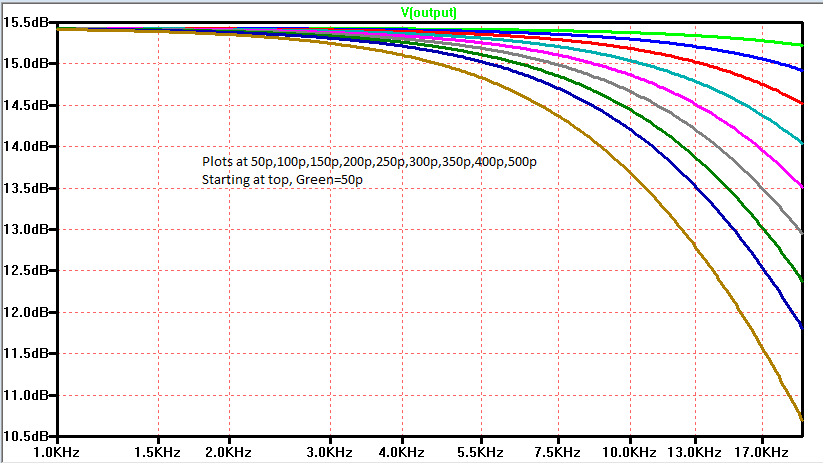

This preamp either needs some really good cables (low capacitance) or the impedance needs to be lowered by a buffer or AVC.
This is what it could look like with various cables without the AVC at output.

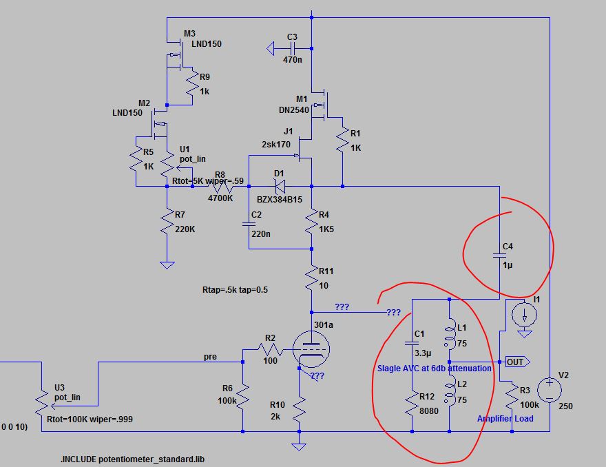

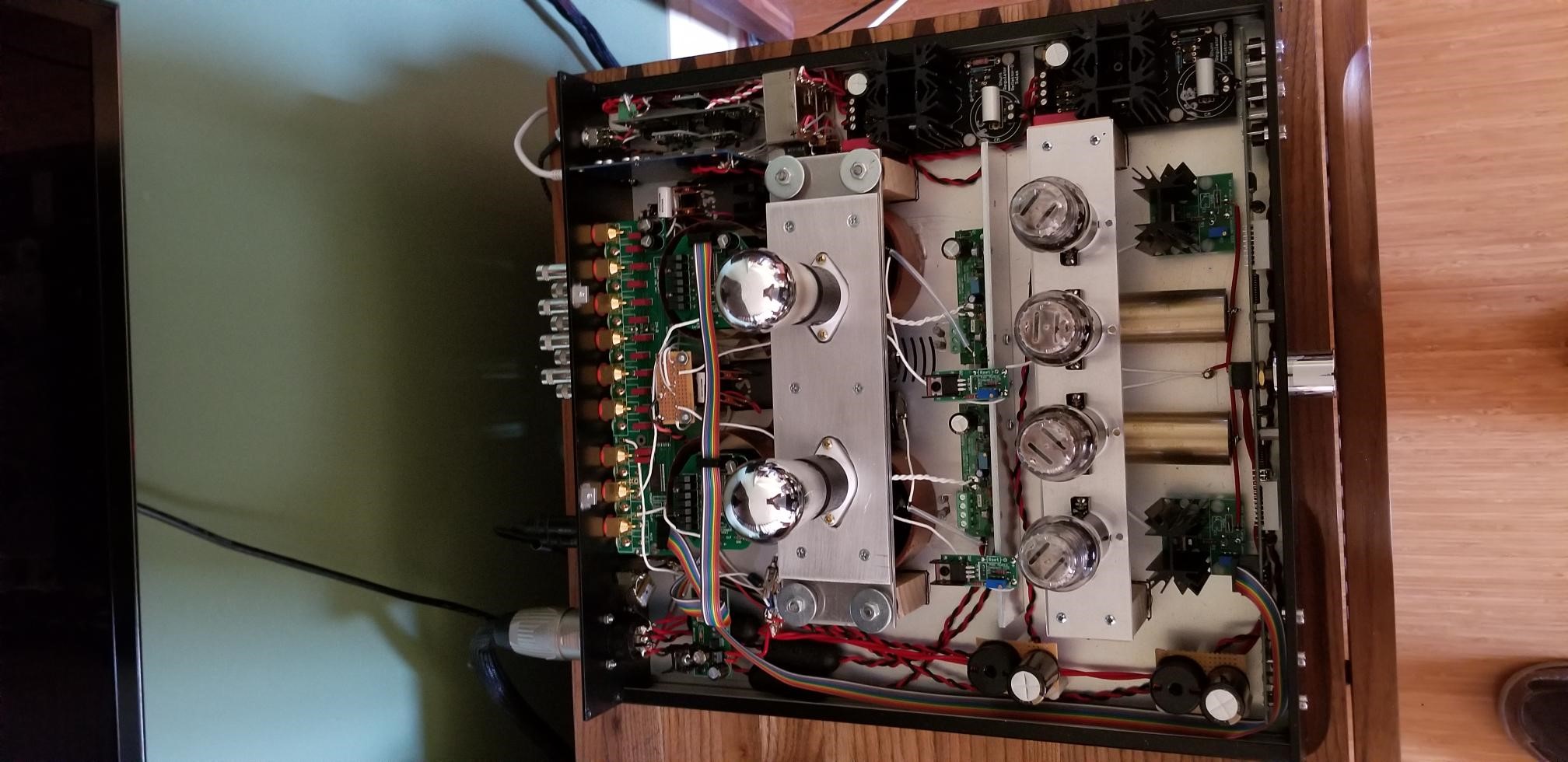

I actually use the Bent Audio TAP-X remote controlled passive preamp "wrapped around" my 01A tube preamp. The Bent has at its heart a Slagle nickle core, silver-wound AVC, on the output of the 01A. I couple the tube to the AVC using a lossy parafeed arrangement, which allows me to achieve excellent low and high frequency bandwidth throughout the volume control range. Since I had some room in the chassis I also built in a Buffalo IIISE Sabre DAC so now the unit is also an 01A output DAC. A relay allows me to switch between DAC and other preamp functions.
Sound is excellent!

The AVC was configured in a 3x3 stack for ~150H inductance. The AVC is fed from the mu output of a K&K Audio compact cascode CCS on top of the 01A.
I used lossy parafeed (aka Damped Resonance Parafeed or DrP) with a 1uF cap, and in parallel an additional 3.3uF DrP cap with an 8080ohm resistor in series with it. This arrangement smooths out the peaking at low frequencies and extends the -3dB point down to 4.8Hz.
It's a neat trick because you can use a very high quality small cap (in this case a 1uF Duelund CAST Copper) through which almost all the signal passes and a lesser quality large cap (in this case a 3.3uF Mundorf Supreme) to augment in the bass region.
Like this, but instead of the choke load there is a CCS mu output and the cathode is connected to ground and the grid is battery biased.
