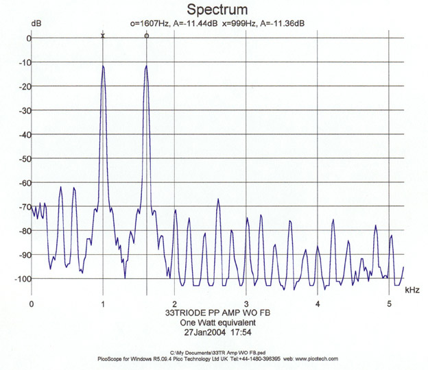

We see many subjective observations here. Has anyone taken the time to look with a scope, how did a sine wave look after going thru? Better still, do the obvious, THD & IMD tests. Discover what is causing the changes in sound.

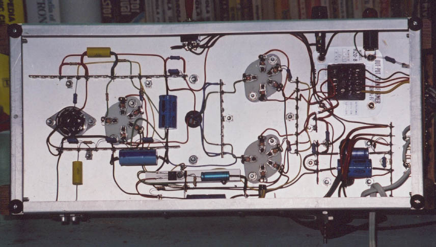

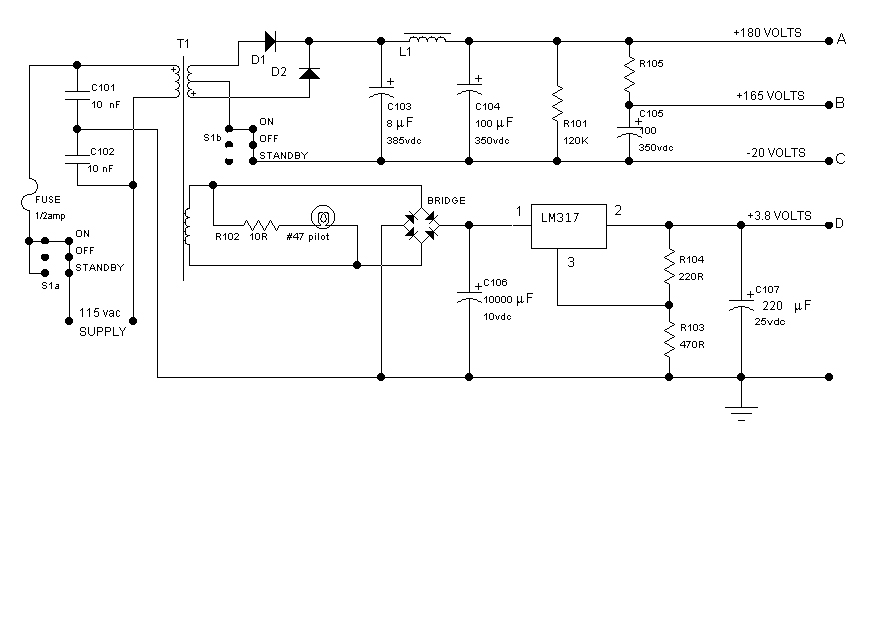

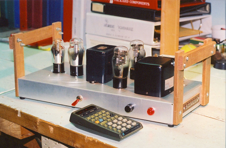

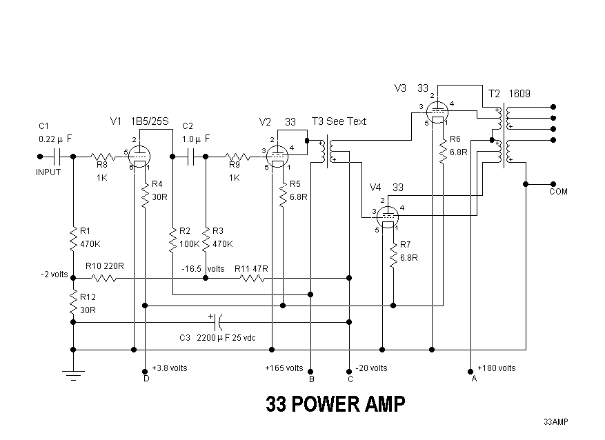

Here is the info on a DH amp I built a while ago. Notice lots of performance data.
This amp has none of the warts I see others having problems with in this thread. It is not a rat's nest of wire in a wooden box, something that invites trouble in.
But the 1B5 is microphonic!🙂

Rod could you post the schematic for 26 or a link?
TIA
Felipe

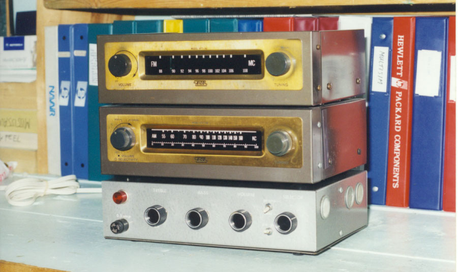

I like Classical & Jazz. But Rock too. The Rolling Stones, Pink Floyd, ZZ Top, Phil Collins & on & on. I have a large collection of vinyl & CDs. My dayly driver is a Sansui AU717/TU717 combo. And in the workshop, Eico AM & FM tuners. Going thru my home grown complete 3W amp with phono front end, all in a Hammond chassis. That one built in 1968.🙂
