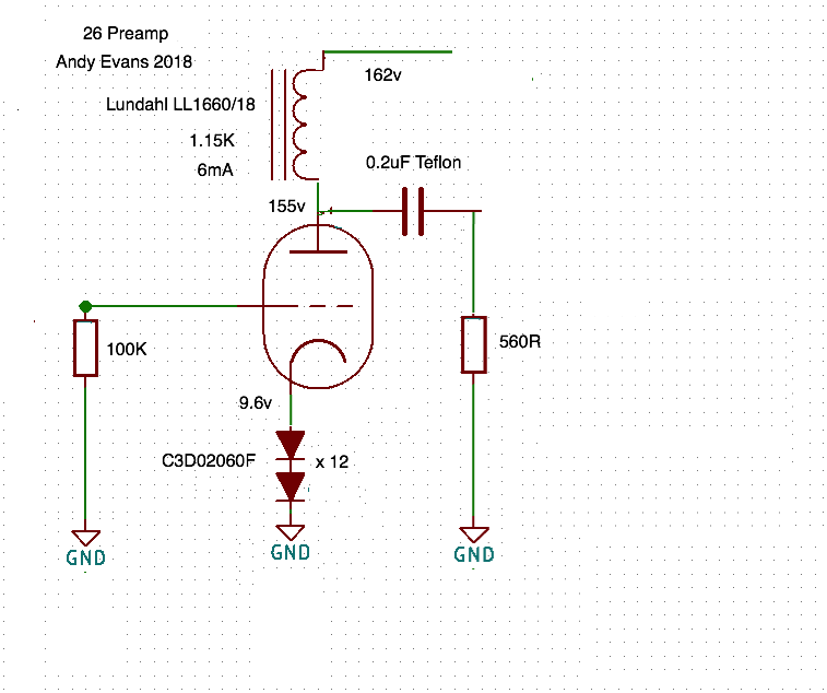

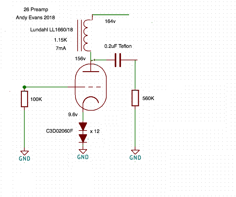

Well..... the 26 in SIC bias. This is really very nice. The diode bias is on the bright side, and the 26 gives it some nice richness and warmth while retaining all the clarity. This is a very nice surprise. I was despairing of what to do with all my 26s and this is the solution. I like the sound of this and I'm going to leave it in my system for a while. It's a total lash-up with dropper resistors everywhere so needs to be rebuilt, but this looks like it's going to be worth it. Good day's work!

Hey Andy, I guess that 560R load reads 560K?
I would have been surprised if the 01A worked well and the 26 didn't.
Why not just use fixed bias and remove everything from the cathode circuit?
Diode bias IS fixed bias....
Hey Andy, I guess that 560R load reads 560K? I would have been surprised if the 01A worked well and the 26 didn't.
Yes, of course - 560K. thanks for pointing that out.
Well, I've been neglecting the 26 for a while because I couldn't get it to sound as good as the other DHTs I was using, but this incarnation is impressive. I'd be interested in some feedback from anyone else that can build it.

It's all in the Lundahl data. You just use the primaries. I prefer the sound of plate chokes with a teflon output cap, FT-2 x 2 here. The Lundahl was just the first thing I had to hand. For my daily listen preamp I'll use the NP Acoustics amorphous plate choke, 136H, 15mA. That's my favourite. Just experimenting right now - this SIC diode bias is completely new to me. It's a little bright sounding but very detailed, so I'll have to see how it lasts over prolonged listening.
I'd be interested in some long-term listening tests on this SIC diode bias. They are on the bright side, and I'm starting to wonder if they are a little too bright and slightly edgy. First impressions are positive because of all the added clarity and detail, but I'm wondering if I can get the smoothness I want for long-term listening. I currently have the 26 in SIC bias in my system, and I'll leave it for a while so I can see if I can live with it. My fall-back option is 2P29L in filament bias which is smooth enough for me with the smaller NP amorphous plate choke. I'll have to move that plate choke into the 26 to see if that makes a difference. So not 100% convinced yet. As above, all feedback welcome.

It could be a case of too many series connected sic diodes imparting too much square law effect. If a bit more brightness compared to resistor bias is desired, there is an option of combination resistor and sic bias. Just replace some of the diodes with a resistor of appropriate value to maintain bias. 🙂
I was wondering about that myself....must try it. Though you couldn't use too large a resistor. e.g. 3 volts at 7mA gives you 428 ohms. I don't want to use cathode bypass caps. This would work better with a 2P29L at 14mA. 5 volts would give you 357 ohms. That would be half of the bias.
