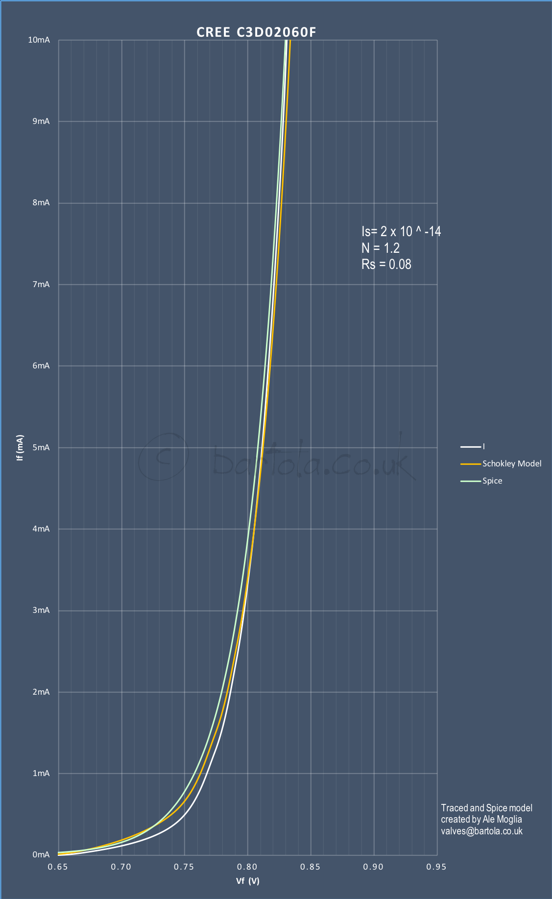

- the forward voltage will be more stable, and the signal resistance will be lower, if the current is increased to at least 250-500mA. The easy way to achieve this would be to filament-bias the diode string. 250mA would bring the signal resistance of the C3D02060A down to around 1Ω.
Filament bias would also increase the forward voltage, so you would need fewer diodes to get the same bias-voltage.

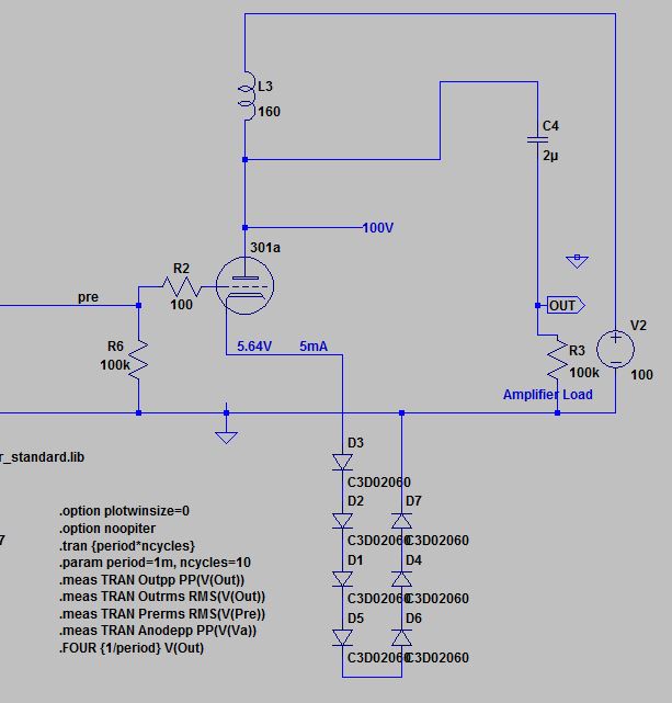

That was exactly my thought initially, but I decided to test it and listen to the stage which was revealing. I went back to my SiC tracing and zoomed the low current section. Between 5-6mA area where I'm currently operating at, seems to be quite linear:
However, I agree fully that in filament bias will may be even better due to the current level will push down the dynamic resistance below 1ohm for sure.

Normal PN diodes are not noisy - in forward conduction mode, which is 100% of the time, in this circuit. Any sample should measure <1µV rms over the audio band, with 250mA flowing. They are worth investigating - even the standard-recovery parts - to reduce the number of parts.
Example: the ultra-cheap 1N4001 gives 0.8V forward voltage at 250mA (the 01A filament current) and <0.5Ω at that current, looking at the Fairchild curves. Much smaller than the others, too.
... However, I agree fully that in filament bias will may be even better due to the current level will push down the dynamic resistance below 1ohm for sure. ...
Forward voltage drop will also increase with more current, the number of diodes may need to be reduced (lower dynamic resistance bonus) to maintain bias.

Here's a snapshot of current/voltage using Ale's model on 6 diodes
I have a string of 6 x CSD01060A on my 01A and the bias is exactly 5v. That's 0.83v each.
So, according the CSD01060A data sheet, I interpret that you run these diodes below 50mA, right?
All the best,
Ulrich
Should be around 4mA for an 01A.
