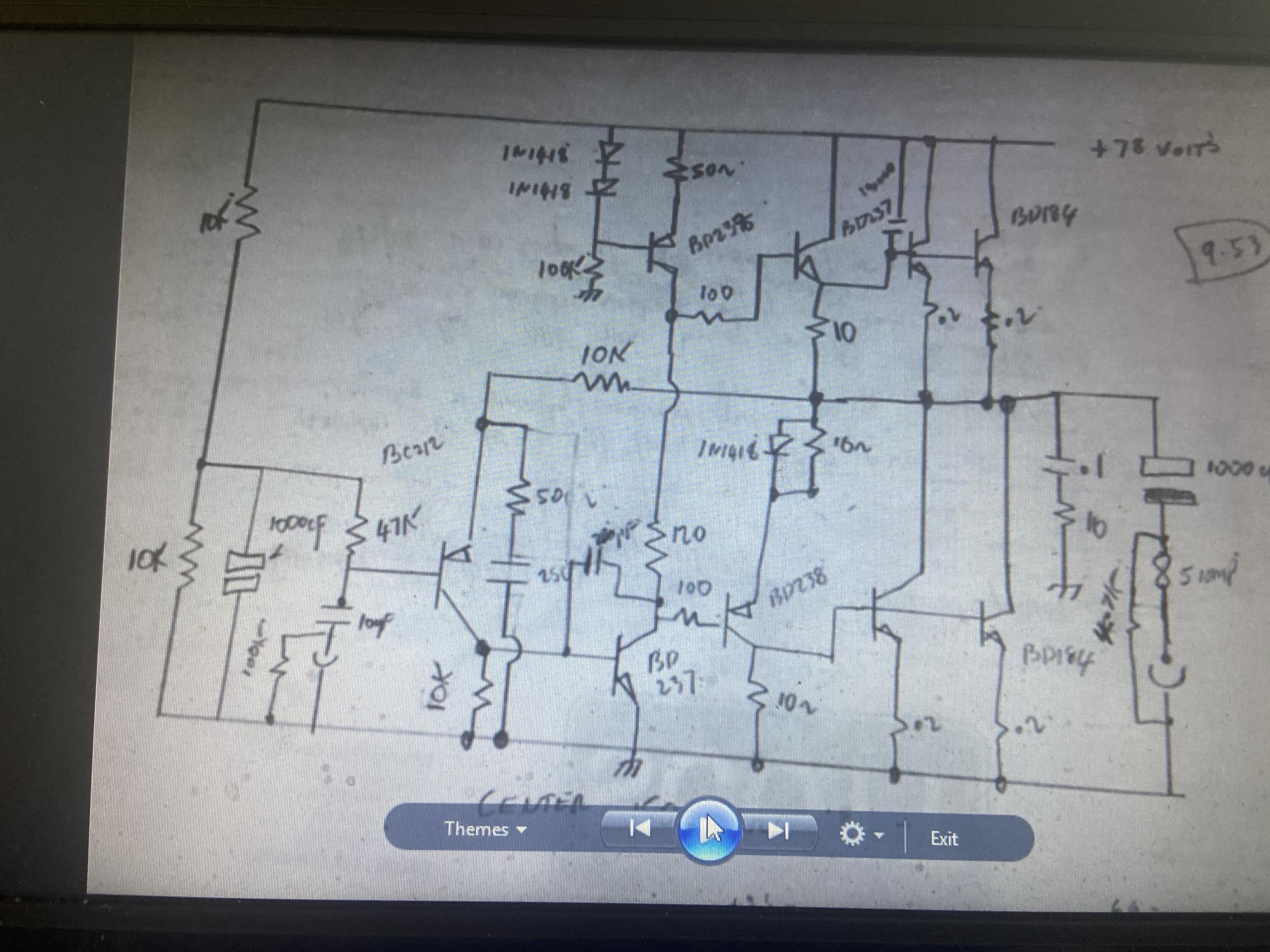

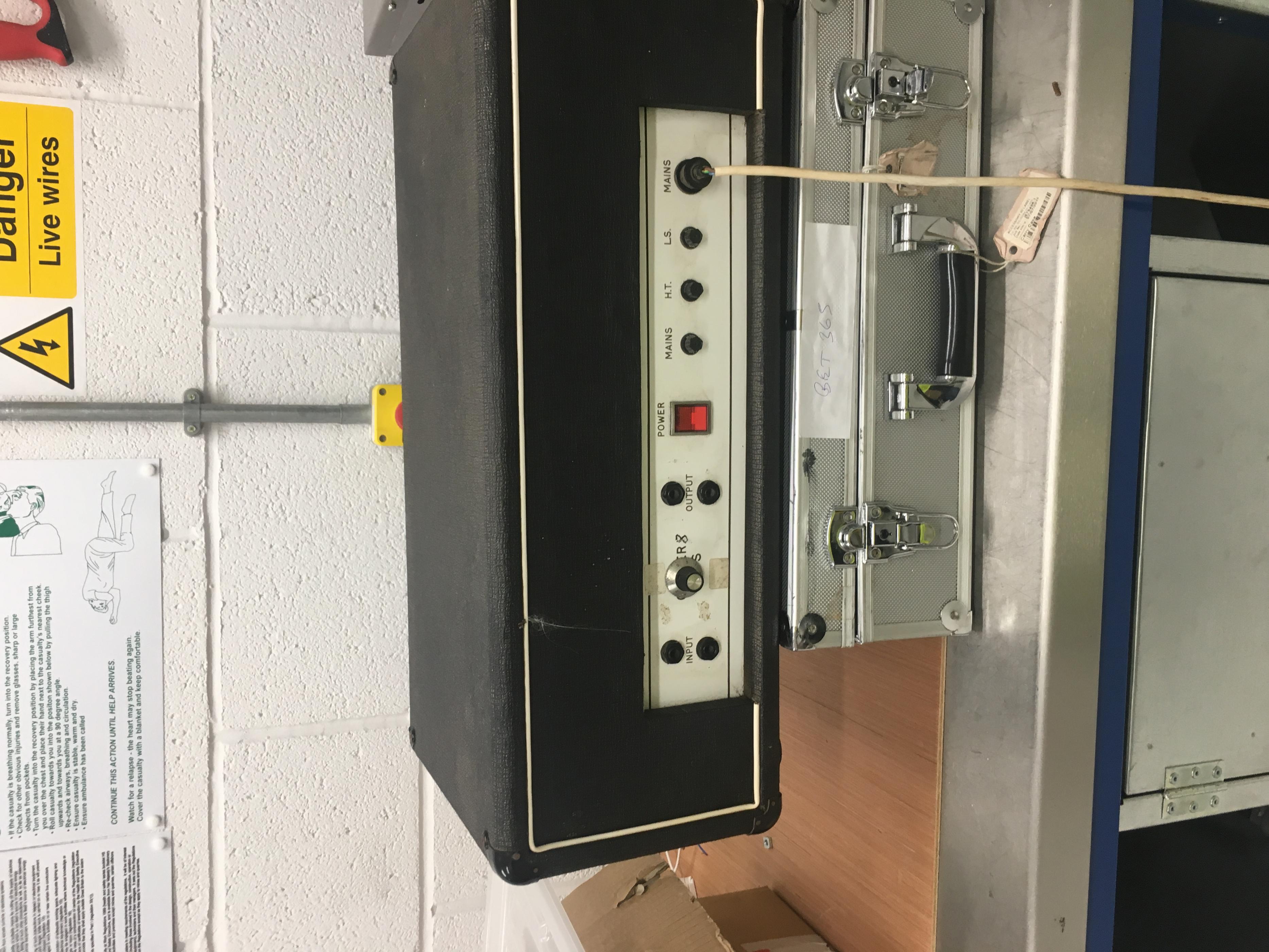

Its a long time since i uploaded any information I hopes this works
The cabinets were made for me by a Mr Peter Steel of Hope street Hanley
Transformers were wound for me by a local guy in Longton and were rated at 300 va
Output devices were BD 184 supplied by Farnel
Drivers were bd237/bd238

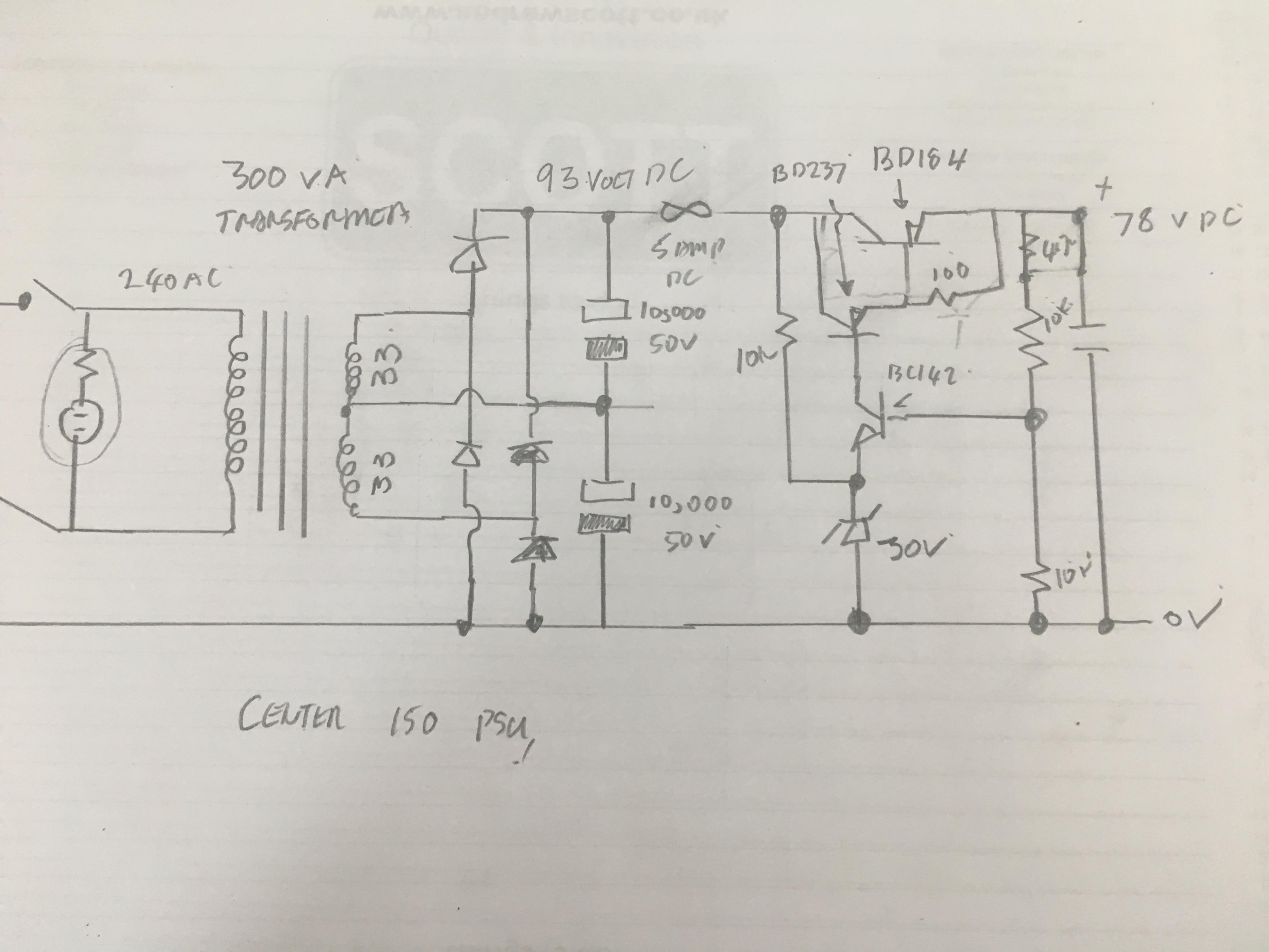

Note the stabilized supply This was done as the off load voltage was to igh for the output devices At this time high voltage devices were not really available to the likes of me
Any way this was self conceived no access to things like Amcron or Phase linear
I just thought of a low impedance driver that would carry the load through the time the output devices were not on
Trev

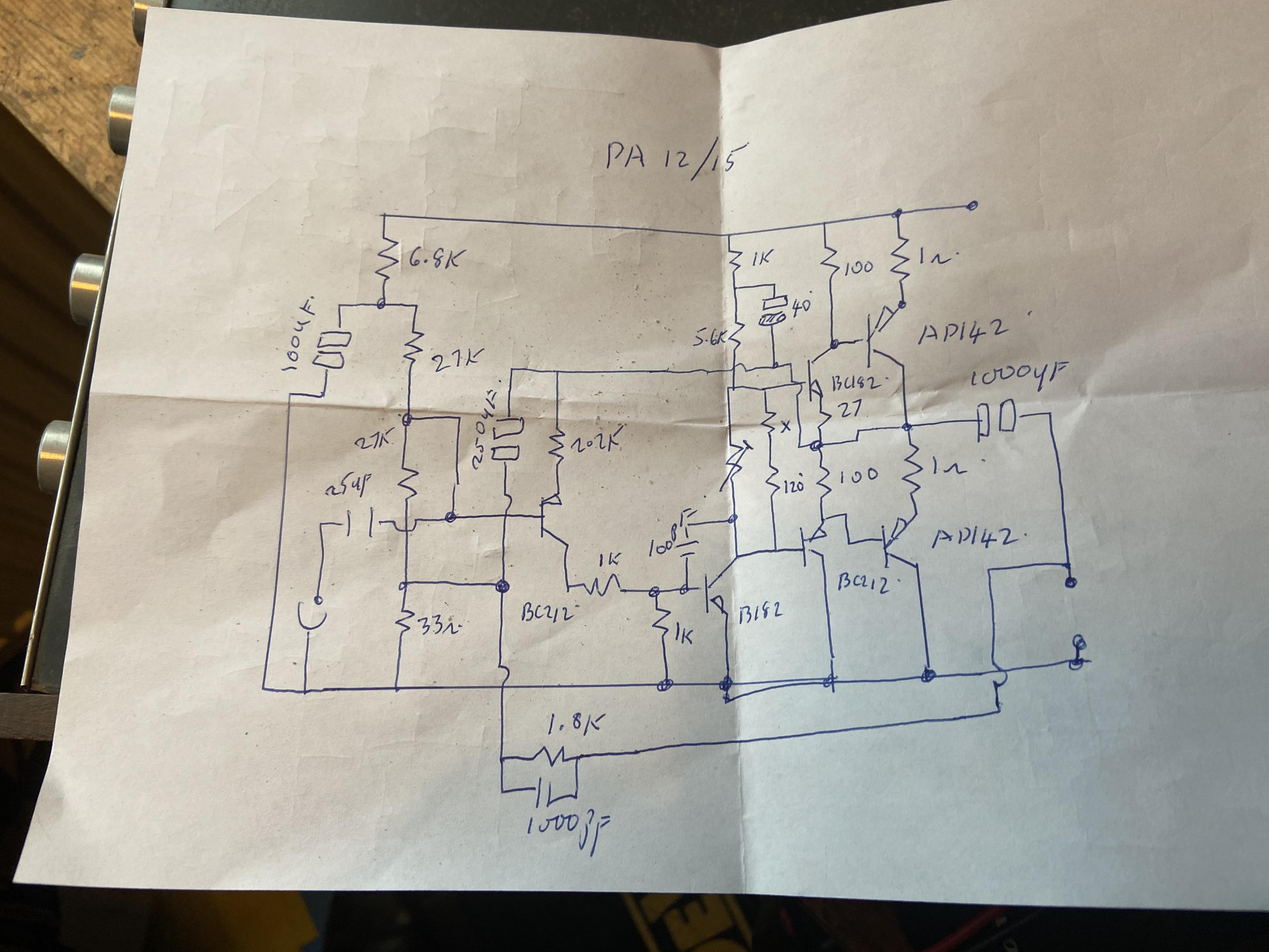

Your schematics show germanium AD142 power devices, not BD's.
Anyway, this obiously is a guitar amplifer, where ultra low distortion figures don't matter that much, if anything at all. Even »clean« sounds benefit from the enhancement by some THD.

Sorry an error on my part
I have thousands of schematics and i have sent you the wrong one I will attach the coorect one now
class b
please view the attached of the actual circuit
Not at all a guitar amplifier as stated earlier these worked for a large no of years as a music pa system in fact 10 amplifiers were used these did deliver 150 watts RMS into a 4 ohm load
they sounded nice at a low level Having said that the drivers were critical and the unit would not work with tip 31/32 c
Trevor
