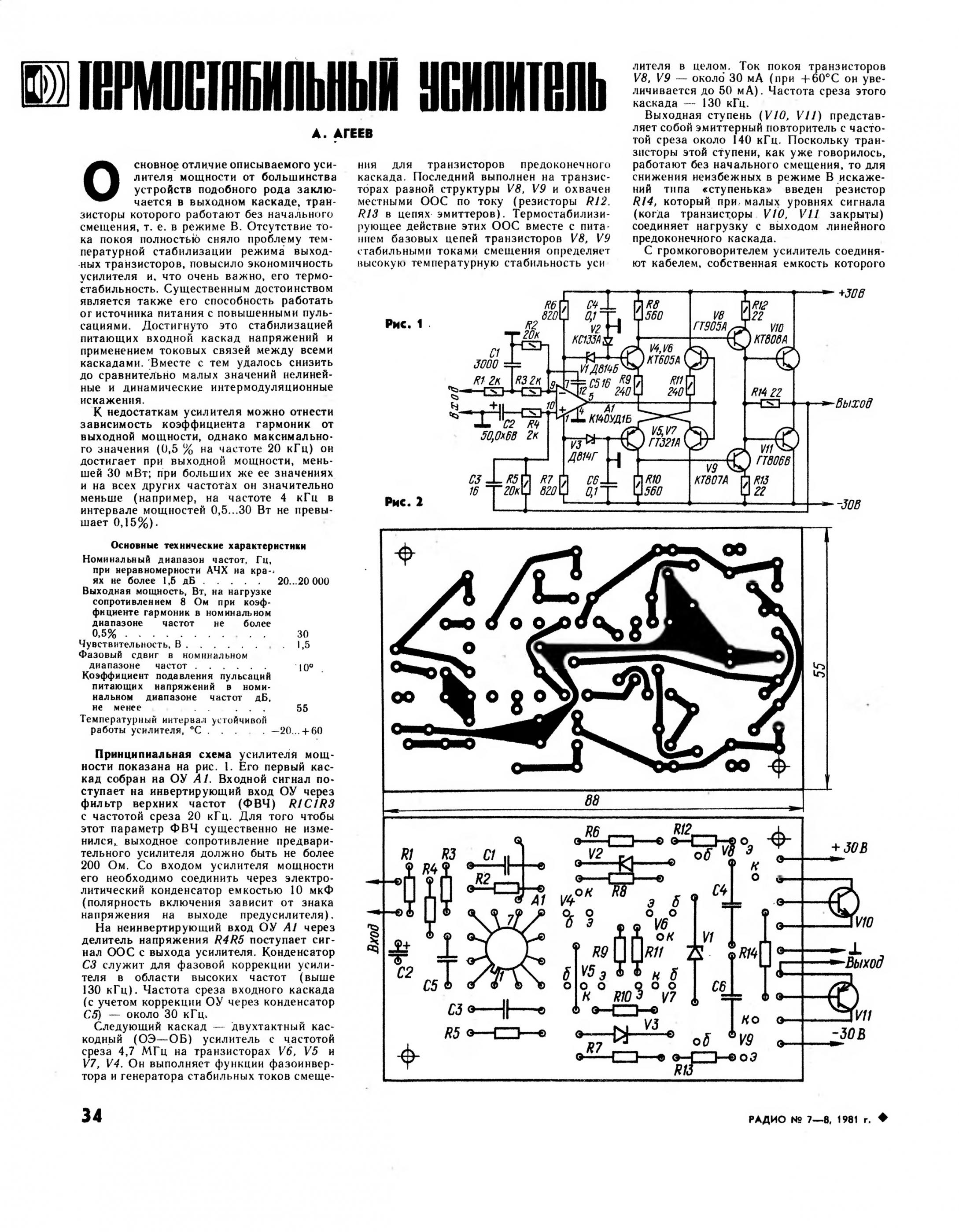

Your schematics show germanium AD142 power devices, not BD's.
Anyway, this obiously is a guitar amplifer, where ultra low distortion figures don't matter that much, if anything at all. Even »clean« sounds benefit from the enhancement by some THD.

class b
please view the attached of the actual circuit
Not at all a guitar amplifier as stated earlier these worked for a large no of years as a music pa system in fact 10 amplifiers were used these did deliver 150 watts RMS into a 4 ohm load
they sounded nice at a low level Having said that the drivers were critical and the unit would not work with tip 31/32 c
Trevor
Trevor
It is a neat design even today.
Hard to believe when I made these I read about the 2n3773 I tried to obtain some but no luck
It would be another 2 years before they could be obtained from Farnell /RS
I was well aware of total DC coupling etc
The output capacitor was a political choice I wanted no comeback re burnt out voice coils if the amplifier went DC
very much a hybrid construction front end on vero drives and outputs point to point wired
The units when installed did not physically move for 30 odd years
Decent heat sinking and a large PSU were the main secrets
I would take another 10 years before i ever looked at an Amcron and at least 25 years before i saw a phase linear
I was lucky enough to get into audio just as valves were being phased out and transistors were making their mark
I later went on to use line output transistors due to the high VCE but hats another story
Trev
You are correct maybe 5 pairs but not impossible
I received the bu208 by accident fitted tham and was delighted by the results
The end result was not dissimilar to Amcron / Phase linear
But with my own front end and capacitor output
I am not a great believer in Dc coupling as i do not have dc coupled ears
Trev
