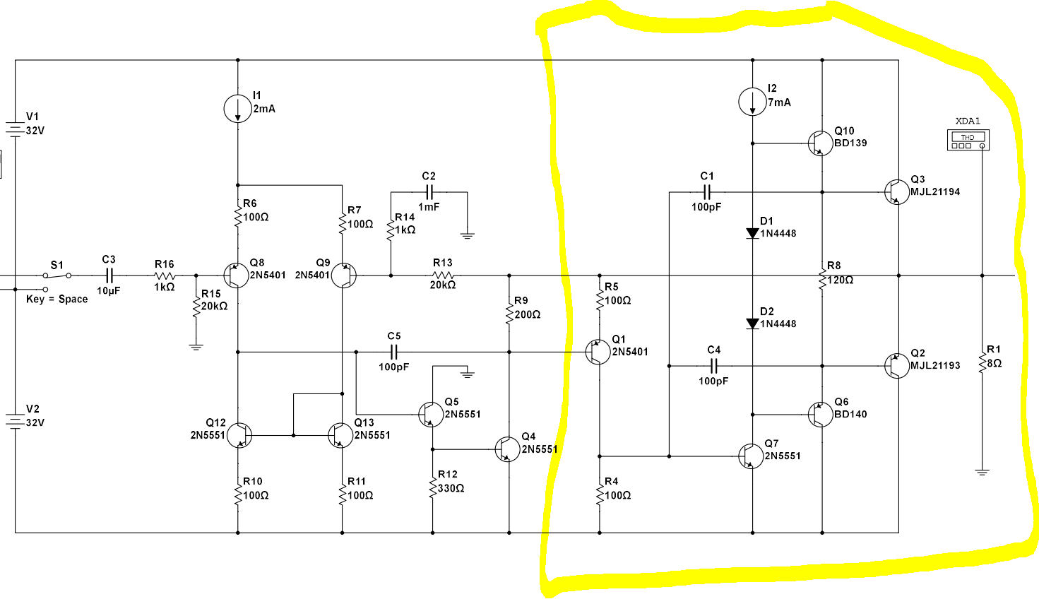

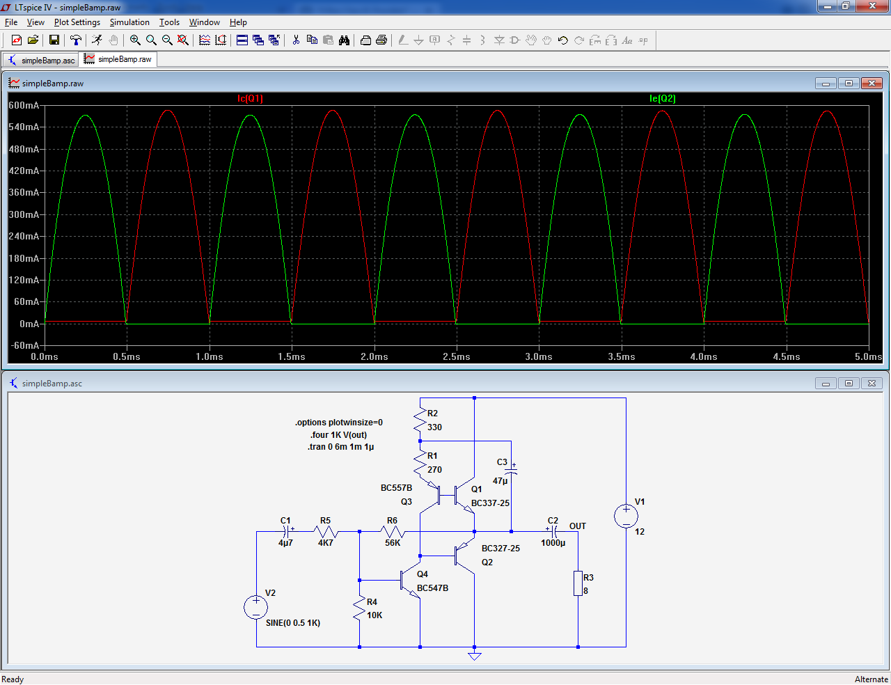

Here is the one I just came up with 0 bias current output stage, highlighted portion.
About the THD figure, I think Multisim is joking with me, 0.001% THD @10KHz.
I am happy if THD can get 0.5% below in reality.

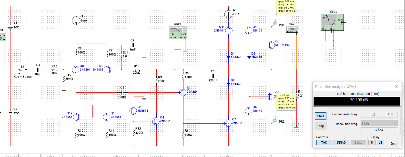

The solution I proposed is almost perfect class B (save a small constant current in the upper transistor), adaptative (no adjustment or thermal compensation required), and doesn't rely on huge feedback to work:
attachment.php
To eliminate residual imperfections, some diodes can be added.

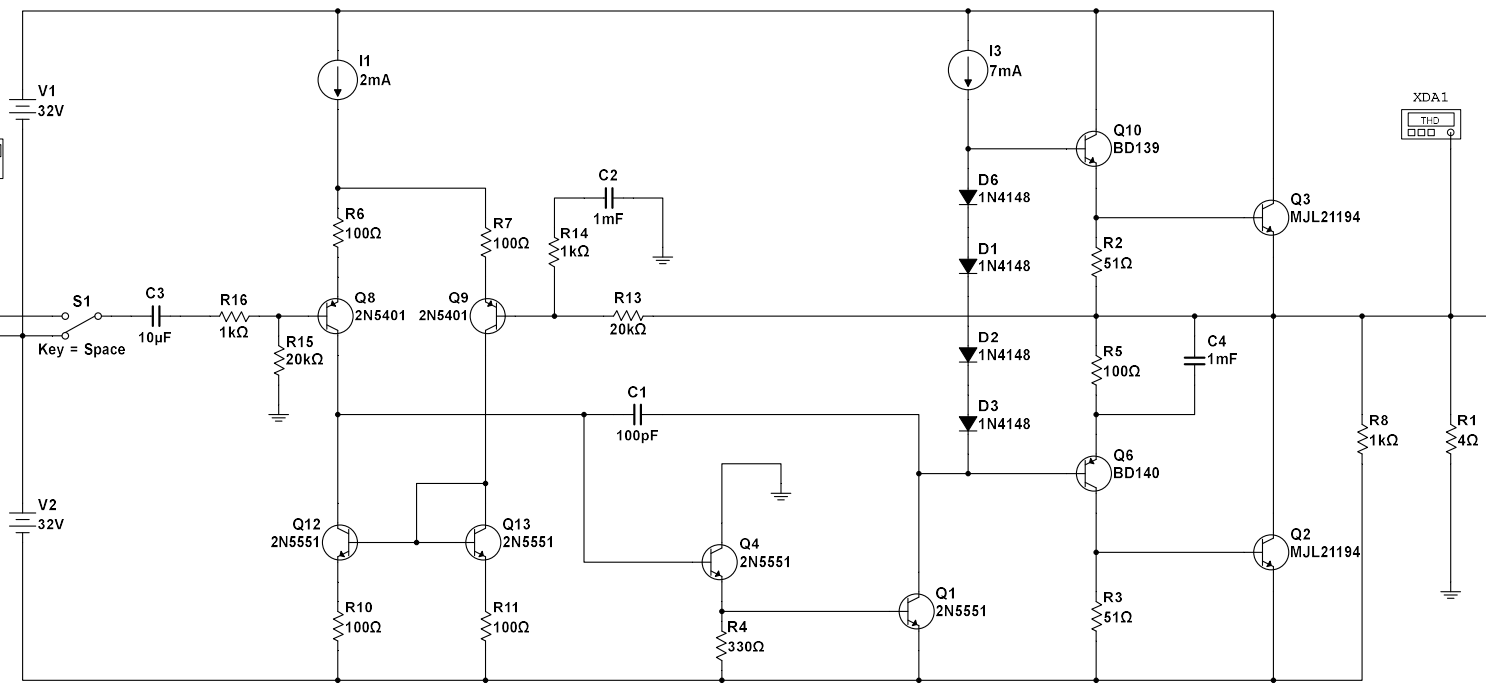

Here is the same with bells & whistles/
attachment.php

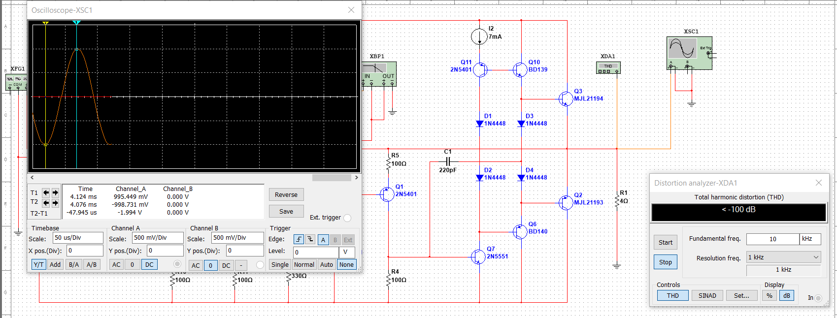

Here is my simulation with your trick. It totally tricked the Multisim simulation. The distortion is not measurable. (Worst case, 4 Ohm load, 1V peak to peak, @10KHz)
BTW, do you hear any artifacts/distortion based on your design with real components? I may not be able to build a prototype to verify the simulation.
***Edited***
There was error in the simulation above. I injected some idle current somehow. The THD is measurable. My bad.
Here is the revised circuitry.

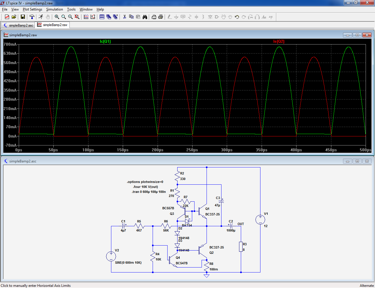

I think I posted this before. This is almost a blameless amp but the output is tweaked.
The bias is not enough for drivers and OP but it's the faster drivers that operate class-B,C and not the slower OPs. This means the switching is fast and less audible. Simulation saz the 1k THD is 0.001288%.
You may also notice that he VAS drives the center of the VBE and not the top/bottom of the VBE in order to improve the output swing.
TBH, I didn't like the sound very much. I normally rely more on the distortion-meter result than on my hears, but I found the sound rather unpleasant.
Maybe it has to do with the very small, but very harsh residues: they don't register on the THD figure, but they may impact the subjective sound quality.
A good ABX testing would be required to lift all doubts

I think that the topology is not practically usable with multiple OP devices, like darlingtons or CFP's: the steering transistor has a base current dependent on the VAS quiescent current.
When there is just one transistor output layer, this results in a pseudo-quiescent current ~=to the VAS current.
When you add another layer, with a beta of ~50 for example, this results in a pseudo-Iq of hundreds of mA, if not more.
A bit hot for my taste.
You can manipulate the current, with BE resistors for example, but it is not very reliable.
If you manage to have it working effectively with doubles (or even triples), good for you.
I didn't succeed, but I would be glad to see someone managing it
I just watched couple Youtube videos of the demos of dynaco st-120. Based on the manual, it has zero idle current on the output transistors. In those videos, it sounds all right.
I may do some quick test with one of my class B amp on hand. It has trim pots for bias current. I could adjust the bias current all the way down. Hope it can down to zero. Then, I will report back the result. I just want to get the "proof of concept" first.
I have an old Sansui G-4700 receiver that was given to me free because it was "blowed-up". I replaced the blown outputs and added a heat sink with 4x 2N3773. The old output REs (2/4) became the RBs for the 2N3773s and I used about 2.2 Ohms. So the original outputs go to about 0.65/2.2=~300mA before the new 2N3773s kick in. It sounded fine so I never adjusted the bias up to class AB. It was not exactly audiophile in the first place, but just fine for listening to FM radio. The tone controls are in the power amp feedback: arrg! It has since been shorted by a bad speaker connection without any failures. BGW took a similar philosophy in their old amps with massive output silicon that could handle the full power supply in a fault condition. The price of silicon (~$14) is not bad compared to the value of my time.
I adjusted the bias current to zero on my class B amp. It is a "Blameless" style typology amp. It sounds fine, without any artifacts. I admit I don't have "golden ear". There is an unexpected benefit to run bias at zero. It totally eliminated 120Hz hum of my amp. 😛 The less current, the less ripple on the power rails.
Based on simulation, for a "Blameless" style amp with zero bias, the THD @10KHz, +-1V peak, you will get -35dB THD (around 1.8%). Thus, @1KHz, you will get -55dB THD (around 0.18%). If you volume up, the crossover distortion will get less proportion, +-1V peak signal is kind of the worst case. I use 4 Ohm load in my simulation.
I did study the schematic of dynaco st-120. Its output stage behaves much better than normal 2EF output stage at zero bias point. If you swap out 2EF output stage from "Blameless" style amp with dynaco st-120 output stage, you can easily get -50dB THD (0.3%) at 10KHz.

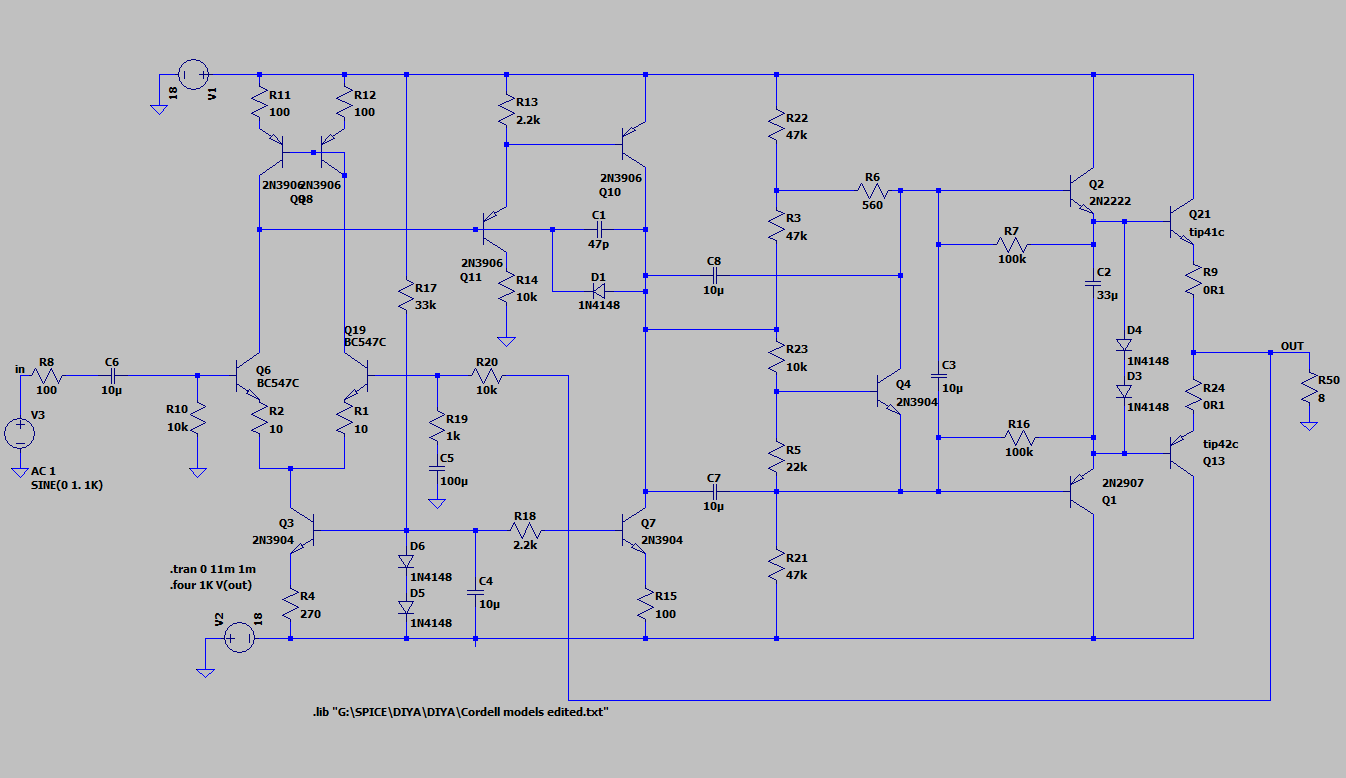

Here is my observation.
1. To run zero bias, you kind of need local feedback to speed up the "switch" during "dead zone". dynaco st-120 uses quasi complementary output stage. The down half is known as CFP, it creates tight local feedback, it speeds up the "switch".
2. Normally, you can just keep one of up/down sides output transistor at zero bias, and leave the other side biased. It helps your THD, meanwhile it maintains the same thermal stability. Use a resistor or current source pull down/up the speaker output to achieve the desired bias. The side remains zero bias will be the side that uses CFP. Its local feedback loop helps the switching distortion. Thus, you can run the other side with EF configuration, because that side is properly biased, you don't need to use CFP.
Based on those principles mentioned above, here is my new design.
R8 injects the bias current only for the up side output transistor Q3. There is no idle current for Q2.
