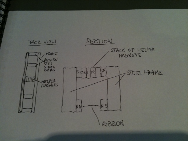

helper magnets idea came from guys at e-magnets.co.uk, they suggested to close the magnetic path between two steel bars (distance setting, so eg. 40mm wide ribbon between 10mm thick neos will require 60mm thick stack of helper neo's) with a stack of magnets as they will help to alleviate field strength drop in the middle of the ribbon length. In effect additional field off helper magnets will add to the field, observe the polarity thou, it has to be reversed in relation to front magnets! I will post a picture tomorrow.

Will the field set up by the helper magnets flow around the back steel bars and thus short out with no effect at the front gap?
I have not checked it with gauss meter but there is noticeable difference in sensitivity between the ribbon with and without helper magnets.
In any case all return paths can be made with stacked neos.

Whilst the science behind helper magnets makes sense, I think the money would be better spent on very large magnets on the sides.
Well actually, for 40mm ribbon I only need a stack of 6 x10mm thick magnets in any shape, disc, square whatever, I just used some leftover and cracked ones. Besides neos are not going to saturate like steel so you can use less I suppose. Correct me if I'm wrong, I'm sure somebody else tried it before me.

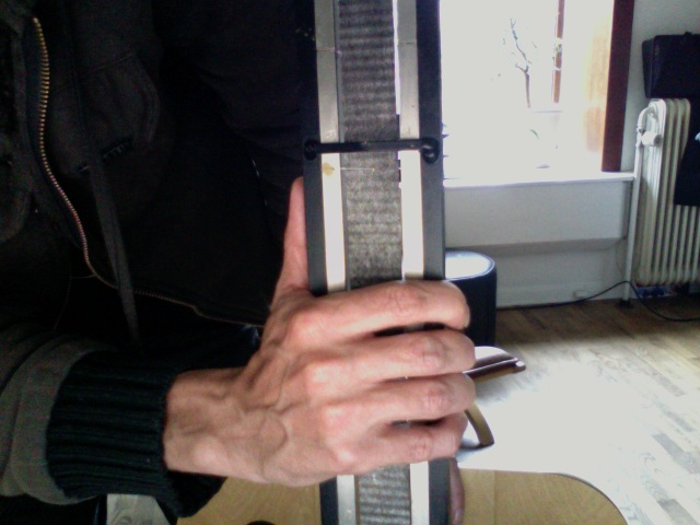

To get the ribbon centered in the magnetic field, I pulled a thread from front to back of magnet.When the thread runs through the middle of the ribbon, it is easy to center. The thread is at my thumb

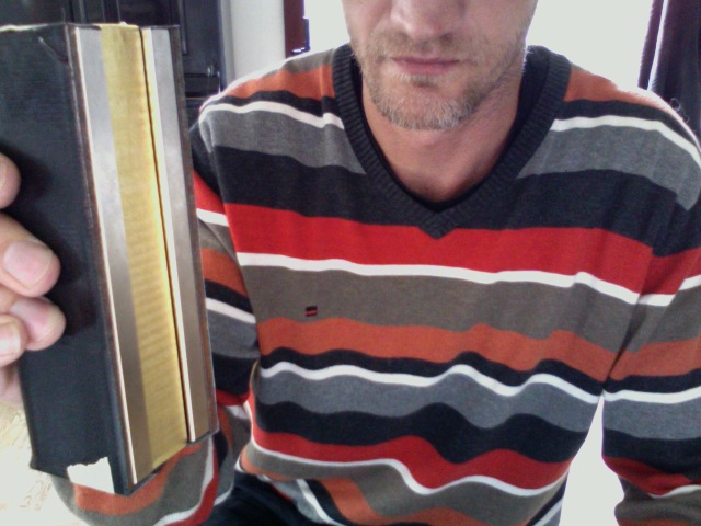

pure gold ribbon. 20mm*170mm 10 ohm. I guess the gold i thin 😀.
Do you know the thickness of the god leaf? Is the gold leaf stronger than aluminium leaf? Does your gold ribbon sound better than an Al ribbon?
I am asking because yesterday night I tested a 0.8 micron flat ribbon (12mm * 200mm) without backing paper or mylar. I had to wear a breathing mask not to destroy it during the installation. Sounded awesome. Most extended FR (> 40KHz) and lowest distortions I measured so far.

it is almost too thin, it is the metal that can be thinnest. you can see light through.It is too difficult to work with. Aluminum is better, and obviously much cheaper.

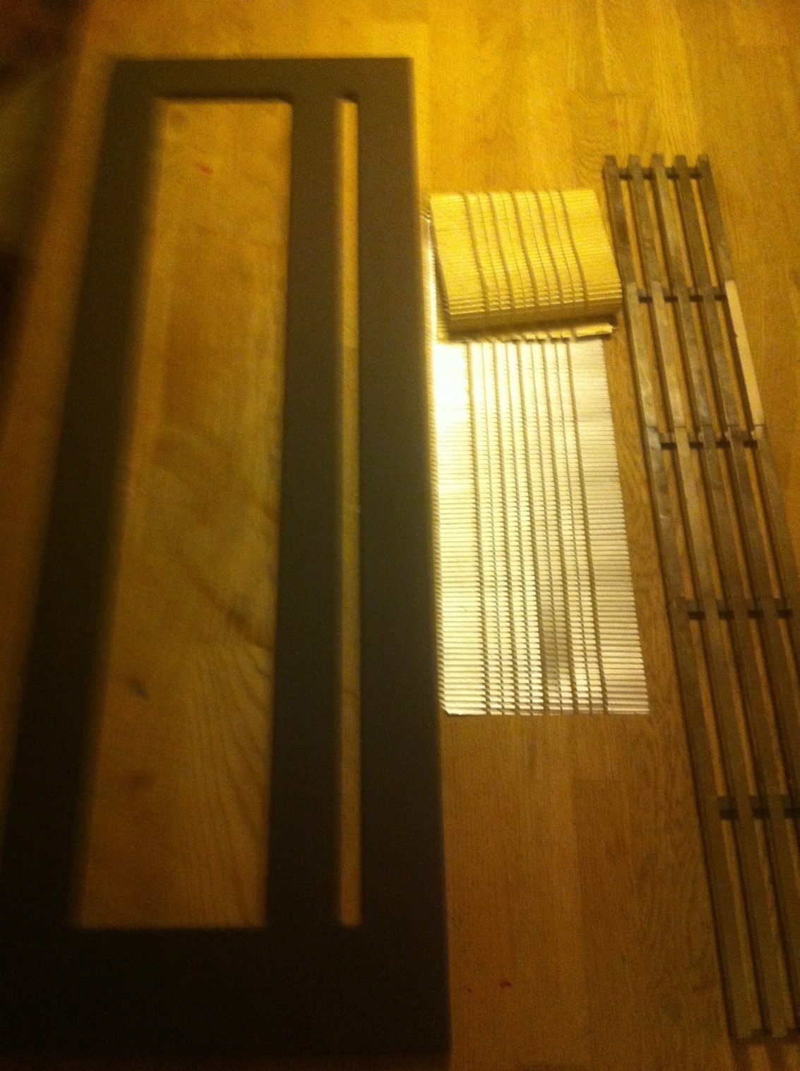

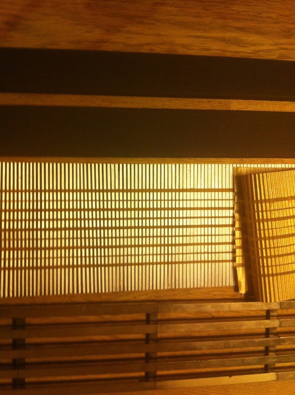

Working on new 2-way ribbon, with cone woofer. finished the midrange ribbon
7my alu one paper, 75cm long 12,5 cm wide. The tweeter will be 12mm*750mm. the woofer AE dipole 18".

Beautiful craftsmanship!
