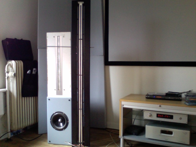

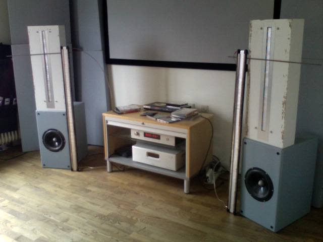

Now in stereo 🙂.The impedans is 2.23 ohm one the sekund one.Now I will wait for the AE dipole 18" i have ordered.The plan is too make a baffle apogee stile.
If lucky I can crossover directly too the 18", but probably not.So I will need a midrange, any suggestions

It is 150cm tall. It got 5 rows of magnets N-S-N-S-N. I will make it with 4 ribbons.But I will have too parallel too get 7ohms.
how low does it go? I'm working on my own ribbon design, just waiting on some final materials. I have a tweeter up and running. Working very well.
