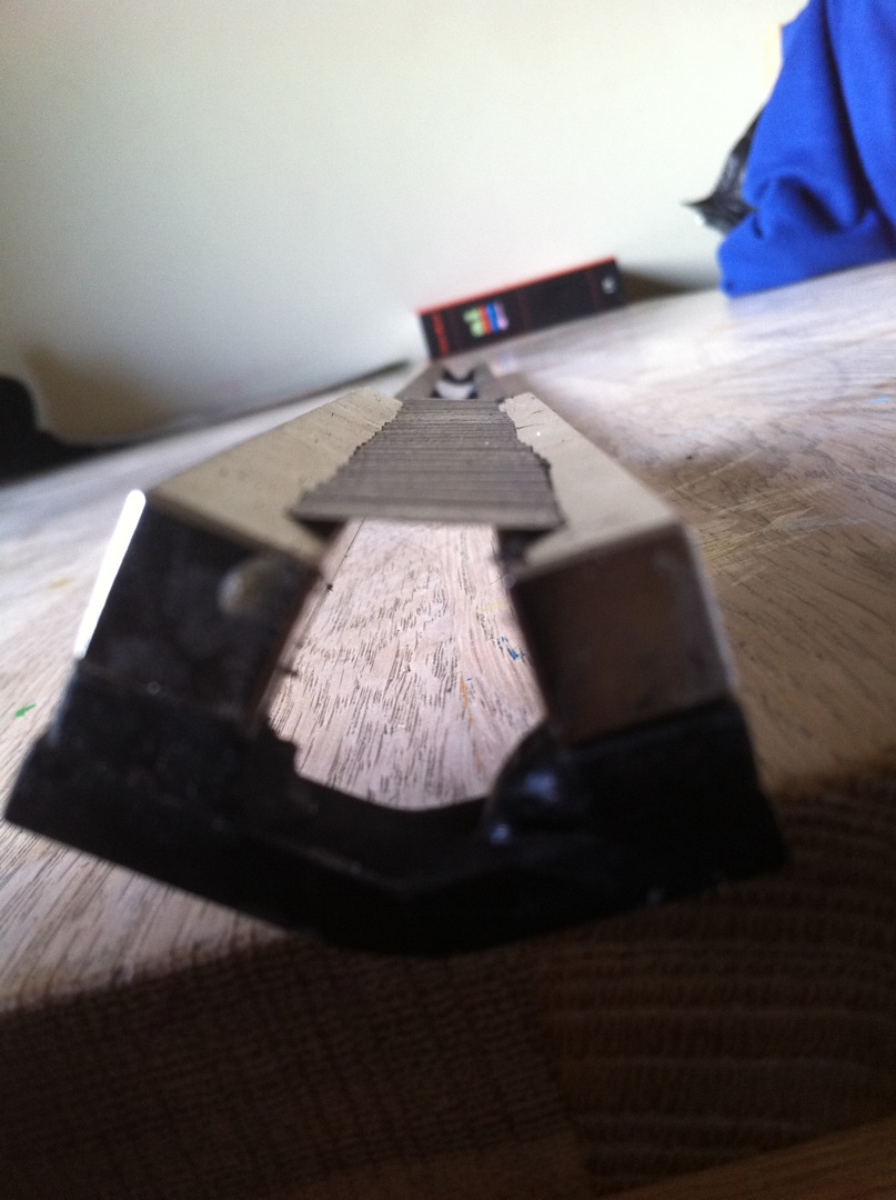

There will be felt at the top of the magnets. so the ribbon will not touch the magnets.
Working on new 2-way ribbon, with cone woofer. finished the midrange ribbon
7my alu one paper, 75cm long 12,5 cm wide. The tweeter will be 12mm*750mm. the woofer AE dipole 18".
AB, what method ae you using to make those diaphragms....
This is how the tweeter ribbon will look like. The ribbon will be attached to the
magnetes by using nano iron in the glue.
Why the curve ...?
Why the curve ...?
In denmark you can buy alu foil with thin paper in the supermarket.
I cut alu strips and tape them together one the paper side. Then i lay thin paper one the alu side and brush it with thin glue.Then the tape is removed cautiously.The paper that originally sat on aluminum is removed with water.
I have made the magnets curved because no paralelle faces. Magnets closer together. The ribbon touches only slightly.Ribbon is magnetic. To make the a better magnetic field, and dampen resonances in the ribbon.

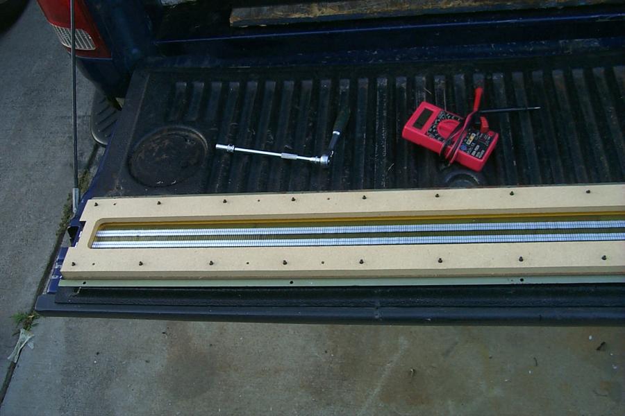

I was trying to get something I can use to make the ribbon in a carver Al-iii speaker.
Its a planar magnetic.
Looks like its going to be too hard.

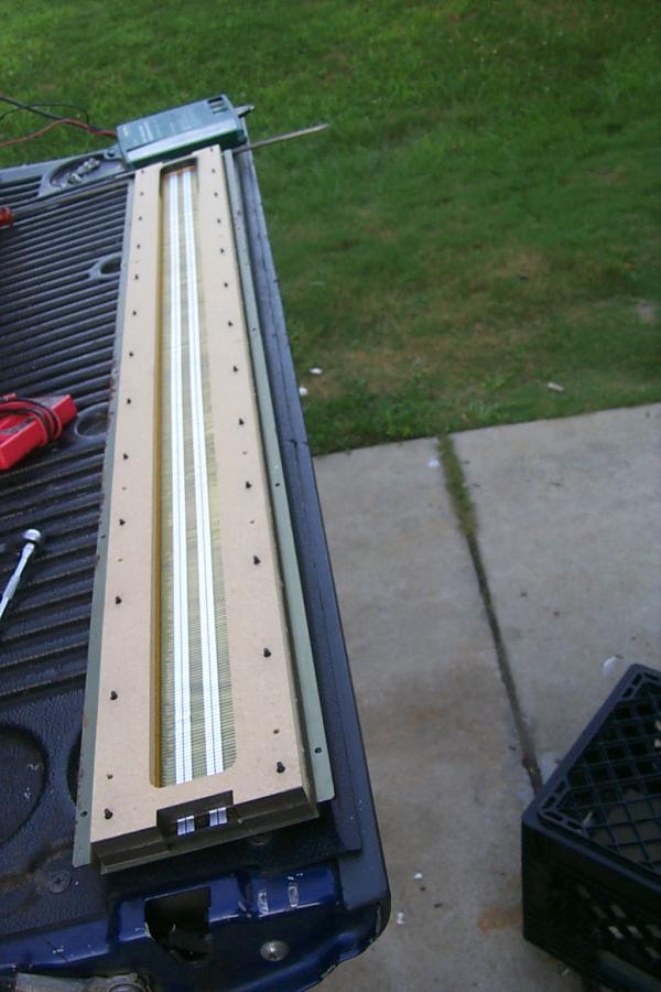

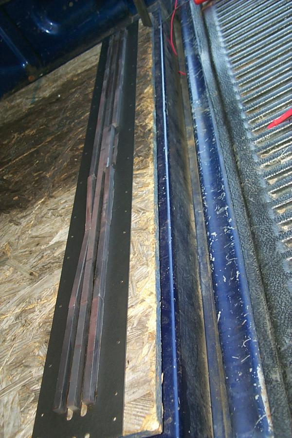

Oooo check this out - I pulled the carver ribbon apart yesterday.
Cool.
Srinath.
Cool.
Srinath.

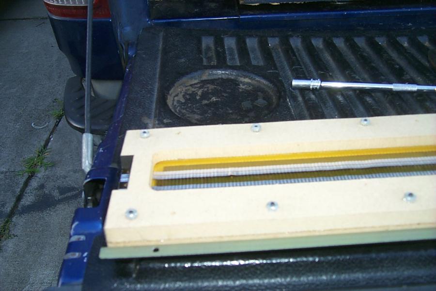

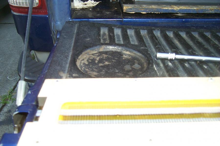

The first couple of modifications I am going to make as well as some tools I would be fabbing are in the interest of taking it apart easier, and putting it back easier and without failure.
To that end.
1. Get the mother of all glues. Maybe even 2 sided emblem tape. Or the spray on with spray hardener emblem adhesive.
2. Get Little plastic or wood dowells cut to keep the magnets the same distance across and get them glued in as well. That way you wont have them go crooked like mine did.
3. Get long bolts. So you can use like 8-10 to bolt em in wide apart and set a 2X4 on it then weight it and bolt it all in. The glue and spacers etc will keep en from dislodging.
I also have 1/2 a mind to re fab this whole thing with neo's and steel tubing all of which will be bolted ito place. Nothing to come apart while assembly.
The reason this is a little daunting for people is that this is a whole lot of moving parts that need to stay put, and its all sandwiching a delicate item.
I'm gonna make the delicate part stay put and the moving parts stay put and get it to where it works as intended but doesn't threaten to come loose and tear up stuff.
