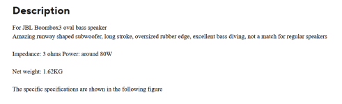

This is the racetrack 8" driver that I introduced in the Bass Shelter thread. It is an unbranded driver sold as a replacement for a name brand boombox. It's 130mm slim across the narrow, and I can think of some fun applications if the driver is good. Build quality is visually superior to Dayton Reference passive radiators on hand. The driver is sold on Ali and is fairly expensive at $104 AUD for a no name. It's proportions and the promise of a decent 40hz low end as touted by the name brand makes it interesting enough to take a punt on. It will also suit the intended beach environment
Comes very well-packed
On the Datsv3, driver not yet broken in
Will stick to plan and take power from the sub section of the current Logitech z623 for breaking in and initial listening. The driver doesn't come with radius info for the cutout, so I will have to do some trial and error to get it right. It does come with a template so I can hack out a cutout for breaking in purpose
Will use the laser cutter CNC router thingy to get the cutout and recess just right for a proper cab in due time. The driver also appears to require a dress trim. The screw holes are very close to the edge of the rubber roll surround glue line. I hate the idea of screw heads crushing this. What do you guys do in this situation? The best I can think of is an alloy plate dress ring in CNC and with matching screw holes to clamp down over the driver's folded up edge. Mounting from behind the baffle will solve this too and have the same clamping effect. Actually, this may not be a bad thing and the material thickness can contain the excursion and just allow a simple grill over the driver
Welcome your thoughts on this unit

The service manual bears this out, but let me make it clear now, this is not a cloning attempt. I do intend to use it in a portable instrument amp as it seems to be a commercially proven driver and from what I have heard around the beach, JBL are serious about touting Pro abilities. It will form a sub for the e-trike, portable workbench, portable PA, two-way with FR desktop monitors and maybe even the car front doors. Lots of potential if this one tests ok
