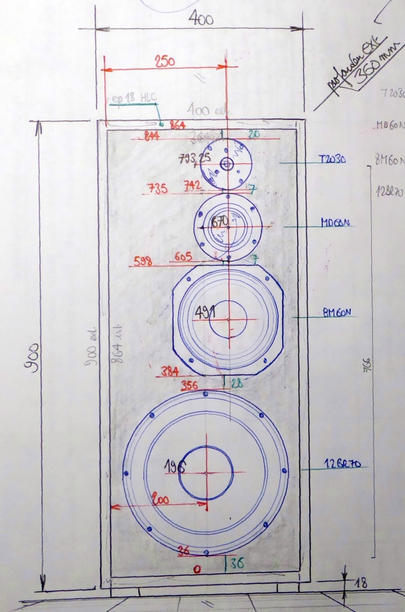

I have an open baffle design in mind with 2x Peerless NE315W, 1x NE180W, 1x Morel MDM55 and CAT308. The NE series blends very well with the Morel domes. The MDM55 has a very natural, smooth character which doesn't embellish at all and only plays what's there without mercy to any flaws in the time domain or acoustical balance. Any recording with rough midrange is hard to listen to over this mid. There's a reason why they still build the driver. One is the car sound market and the other is for use in studio monitors. Just don't cross it under 800 hz 3rd order or 1000 hz 2nd order and you'll get the best.out of it.

The Morel MDM55 :
Well, I looked at it also (following recommendations found in the thread), and I hesitated...
This superb Midrange dome has the advantage to be compact, therefore offering to reduce the distance between the Tweeter and the Midrange. It offers a low Fs combined with a nice linearity, but an efficiency at 89.5dB/W/m, according to its specs :
In comparison, the SBAcoustics SATORI MD60N-6 is indeed less favourable in dimensions, but it offers a 94dB/W/m sensivity for a quite similar frequency response in the 1kHz to 10kHz range.
The least sensitive of my speakers is the 12" BEYMA 12BR70 at 93.5dB/W/m, that is to say +5dB over the Morel MDM55 : that's why I preferred to chose a matching sensivity, hence the SATORI MD60N-6...
I possibly could have count on a baffle step effect to help the sensivity of the Morel MDM55, since my 475L project offers a quite large frontface :
For the better or for the worse, I did not wanted to take the risk of an imbalance of sensivity impossible to correct afterwards... 😕
